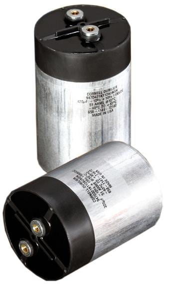

1000uf MKP caps
mr.pass have mention this caps at deLite article:
"The output capacitor C3 protects the speaker from the DC voltage
seen at the Drain pin of the Mosfet. If your speaker drivers are capacitively
coupled already by a crossover filter, you might eliminate this capacitor, and of
course you can use a better capacitor than my 10,000 uF 50V electrolytic.
1,000 uF of polypropylene capacitance will get you down to around 30 Hz or so,
and larger values will get you lower, if you can afford them."
i saw this caps are available at mouser,
have anyone ever tried this big 1000uf - 2000uf MKP caps for output?
thanks.
Me 😀
I use one 1uf for my tweeter driver and 2x 470uf ( one big can MKP and one small stacked film)
for the full range driver.
I prefer this output config than a 10000uf rifa phe200.
whoa... that big clarity caps are beautiful😱
thanks, at least that's convinced me to buy those big caps because it's so expensive😀
btw is this caps good for low freq or high freq? (from your experience)
