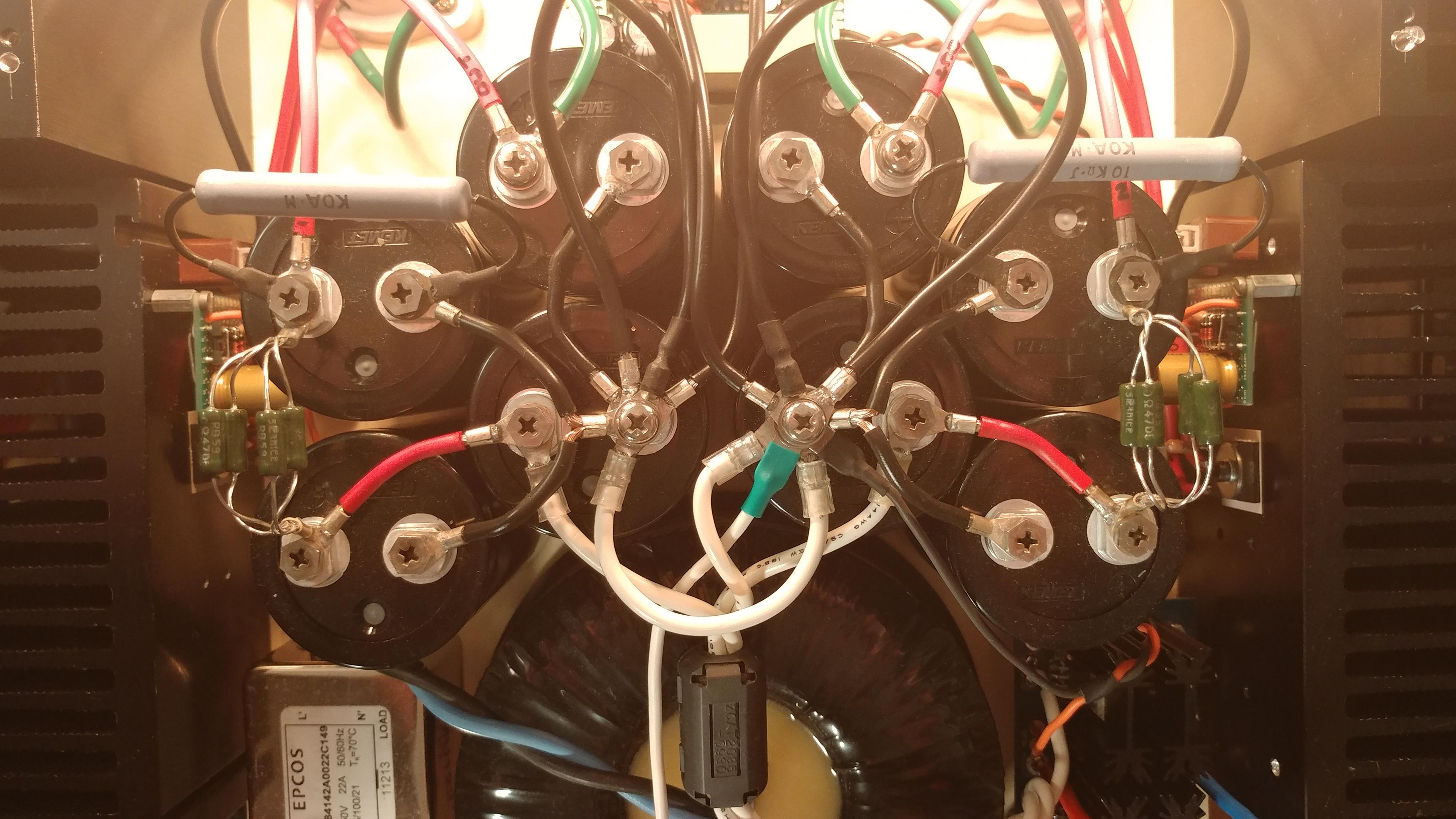

Advantage...hm. I believe that with the given architecture - involving screw terminal caps, point-to-point wiring, voltage regulators and significant distances between building blocks - it is actually easier to implement star grounding. And with quiescent currents of up to 3A, I'd rather have a separate current return path for each PSU cap.

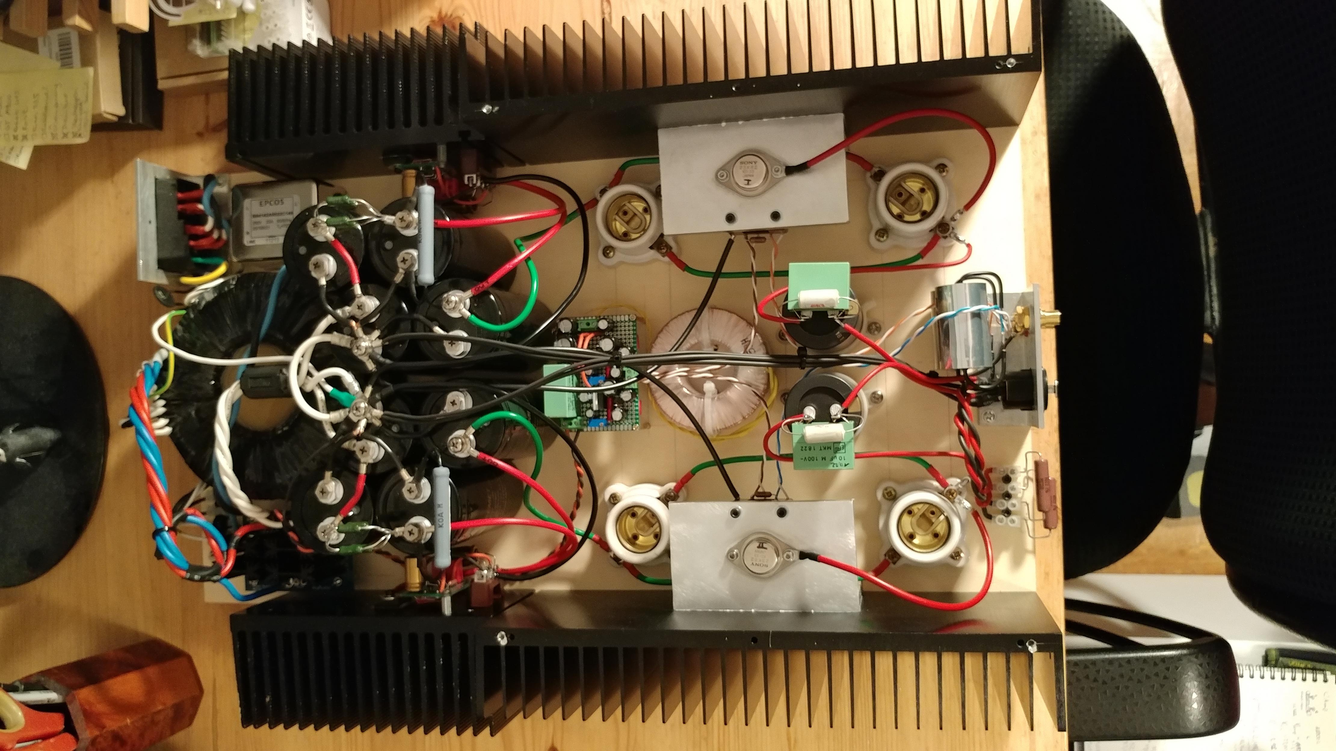

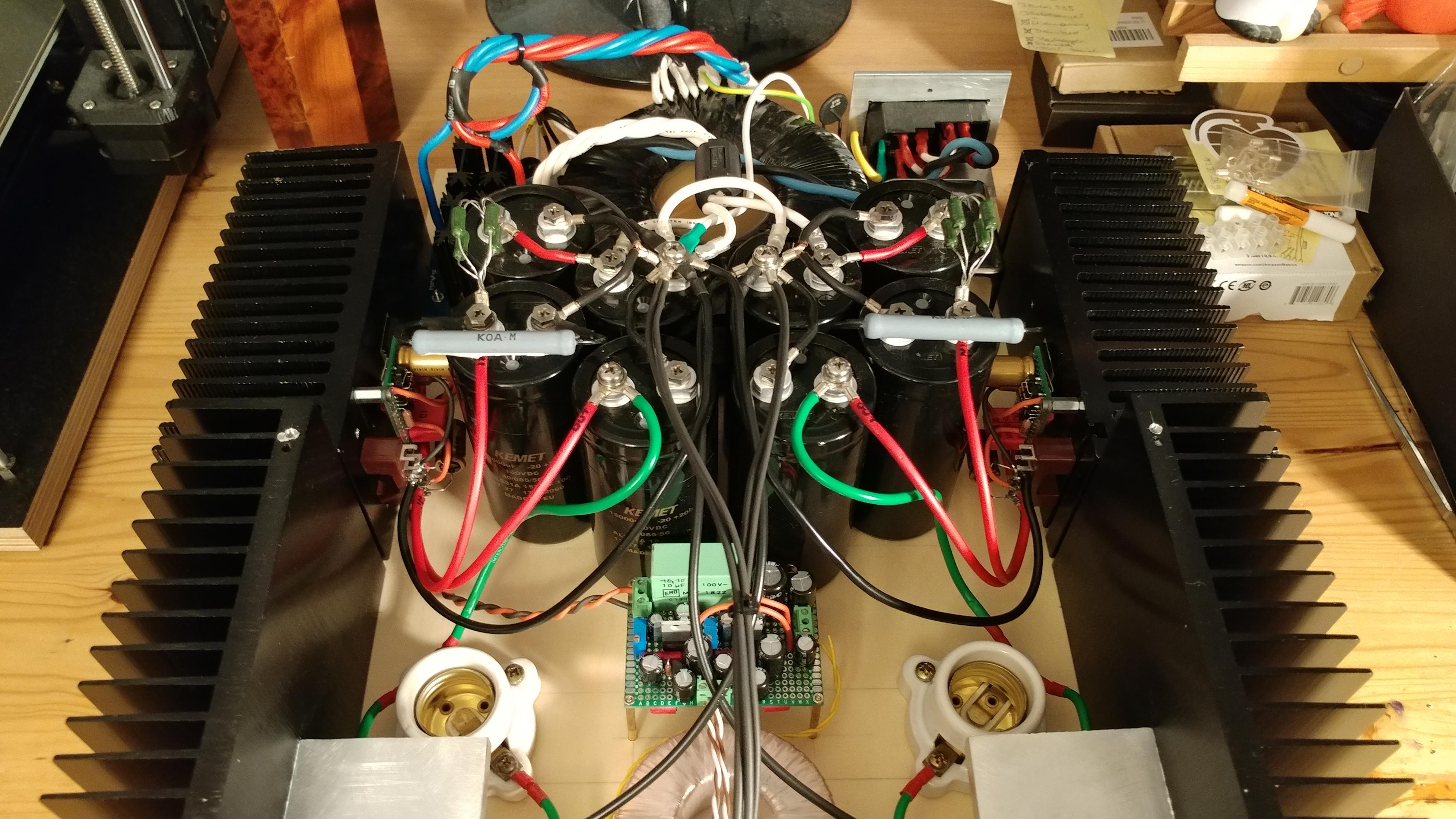

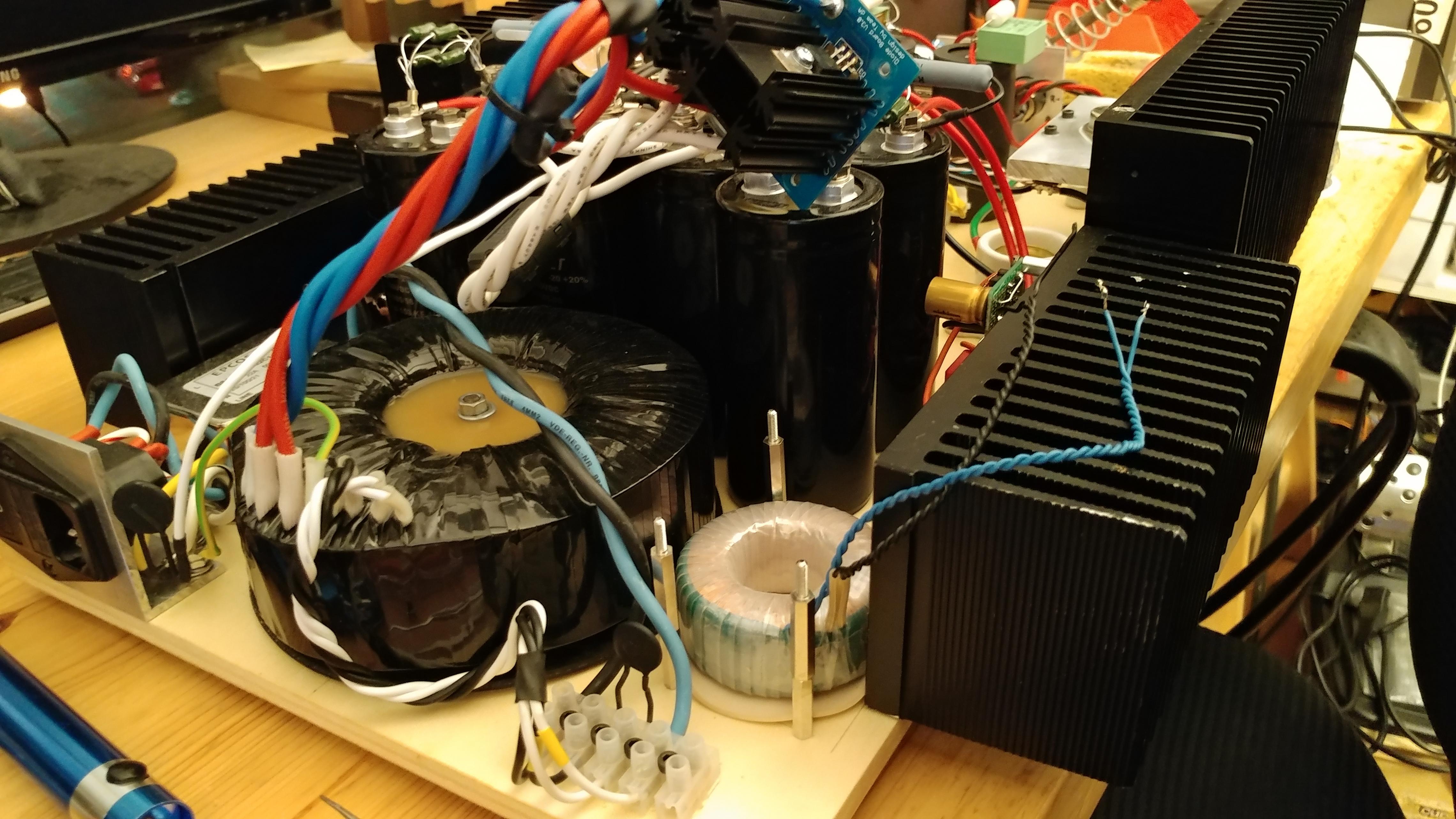

Alright, I finished the amp tonight and fired it up. Biasing went without a hitch, no smoke, no drama. Or so I thought. After hooking up some headphones I discovered that there's an awful lot of hum/buzz present. The scope showed a similar picture.
I'm suspecting the ground layout really. Currently all grounds meet at the star ground. I think I'll try and have the signal grounds and the bias supply ground meet at the VFET, and route it to the star ground from there.
Once I get the amp working quietly I'll pull some numbers from the circuit and mess around with finding the sweet spot.

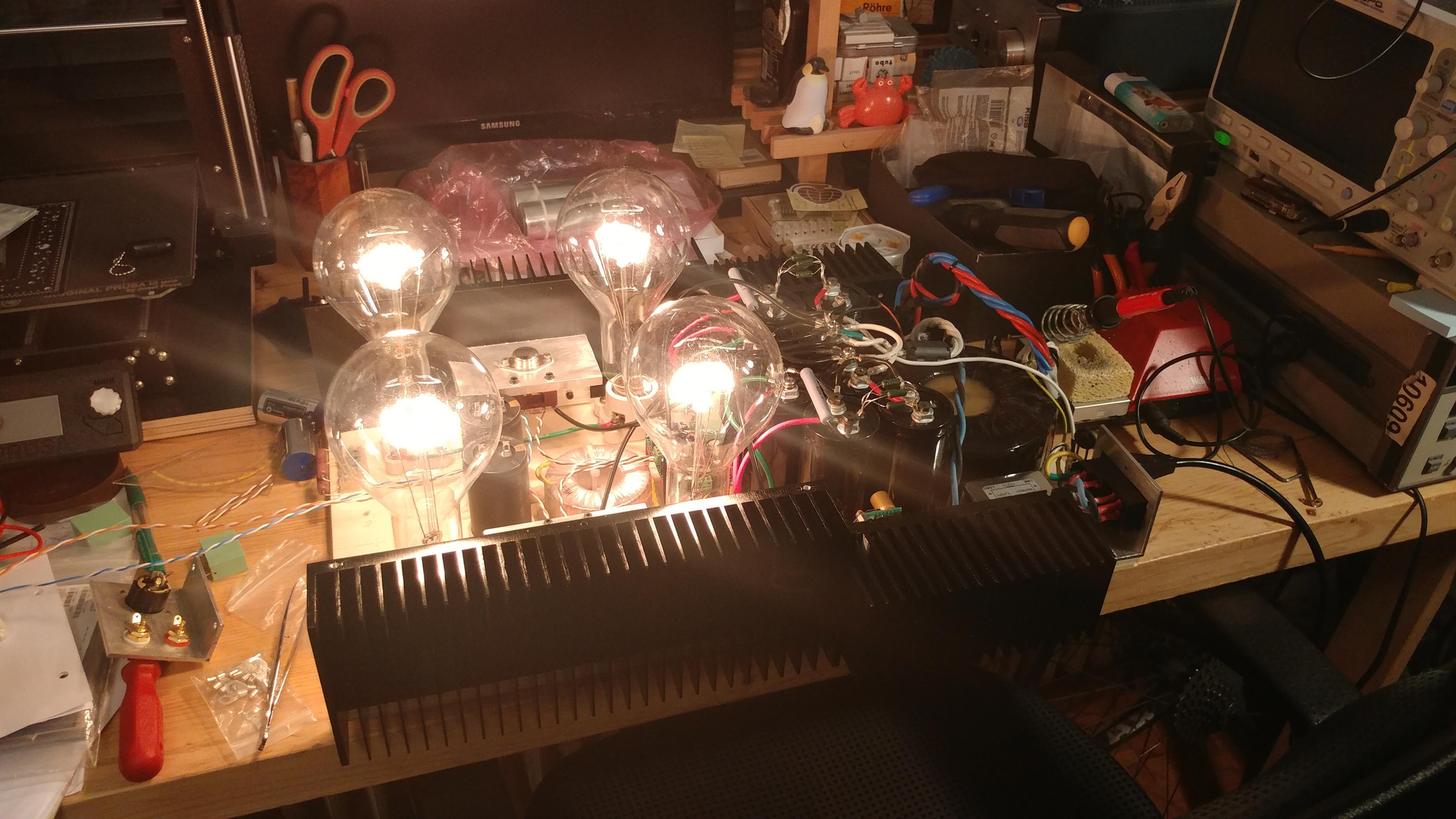

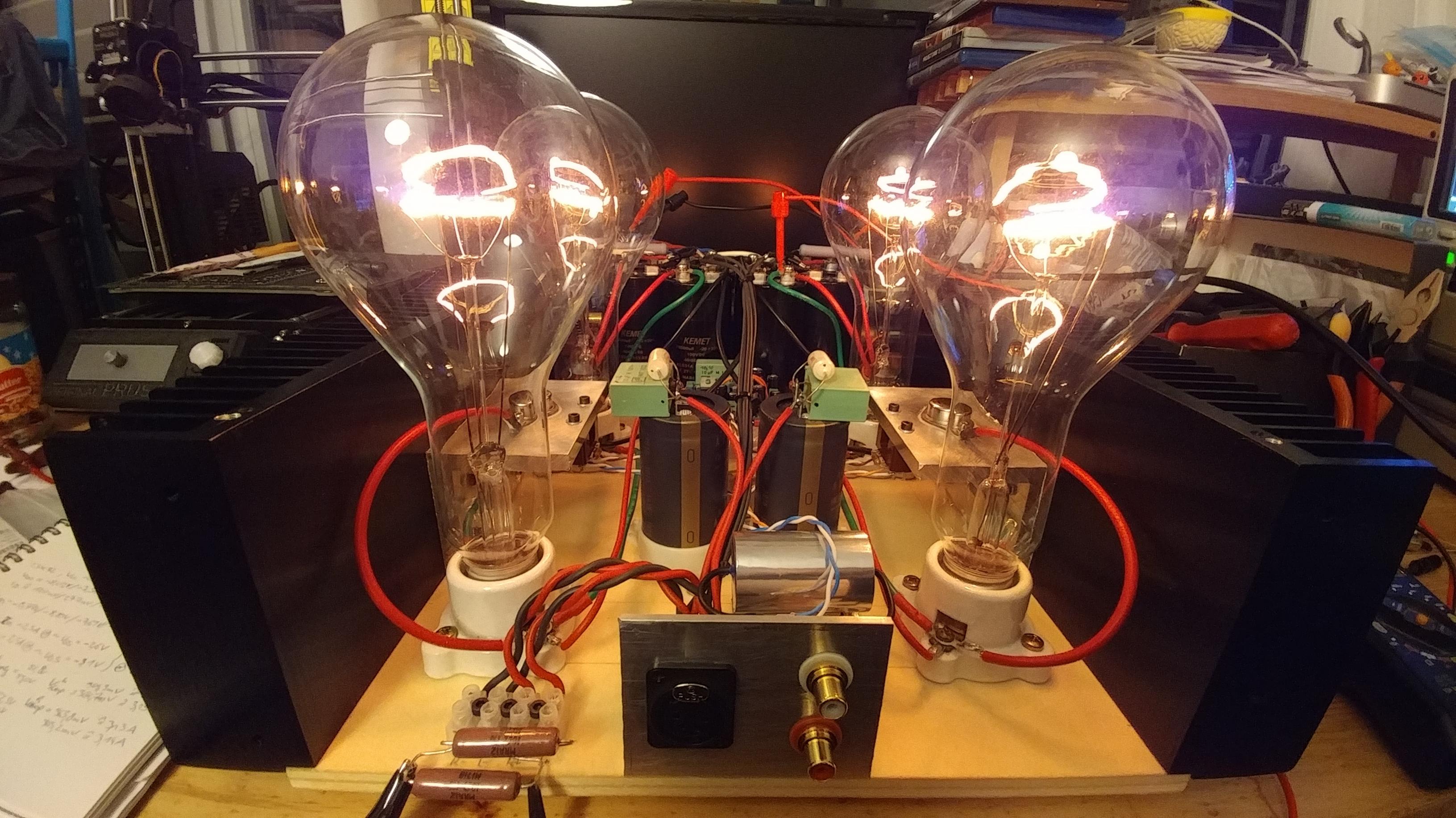

Those light bulbs are awfully close to the V-Fets. Could they be inducing your hum/buzz?
Rush
also, might be helpful to have two star grounds... main one for PSU at chassis, and another star as floating amp circuit(s) ground, connected to PSU ground with/series a CL-60 thermistor. The resistance of the thermistor helps block any loops.
I did some light probing, and it looks like the output is mirroring whatever is coming out of the bias supply, and that ain't clean DC. At least I think I know where to start cleaning up.

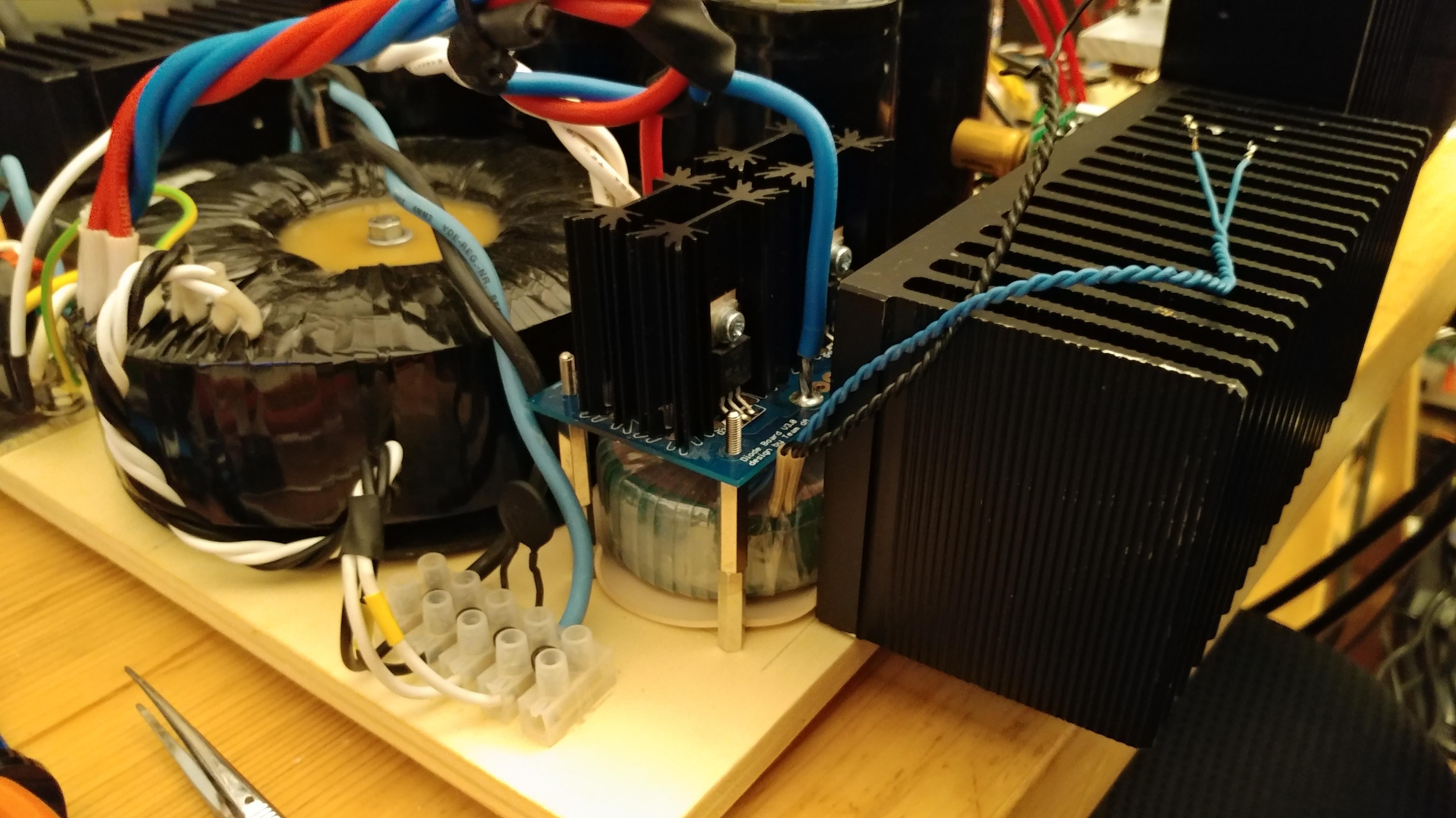

I couldn't get the negative supply generator to work like intended, so I'm converting it to a proper negative bias supply with a dedicated transformer. I have this small-ish 12VA 40Vac (230V primary) transformer that I'll be running off the 44Vac secondary of the main transformer, which should give me something like 11Vac or about -14Vdc to work with. I have also found a cozy place for the little fella:
