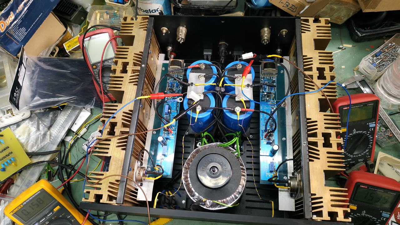

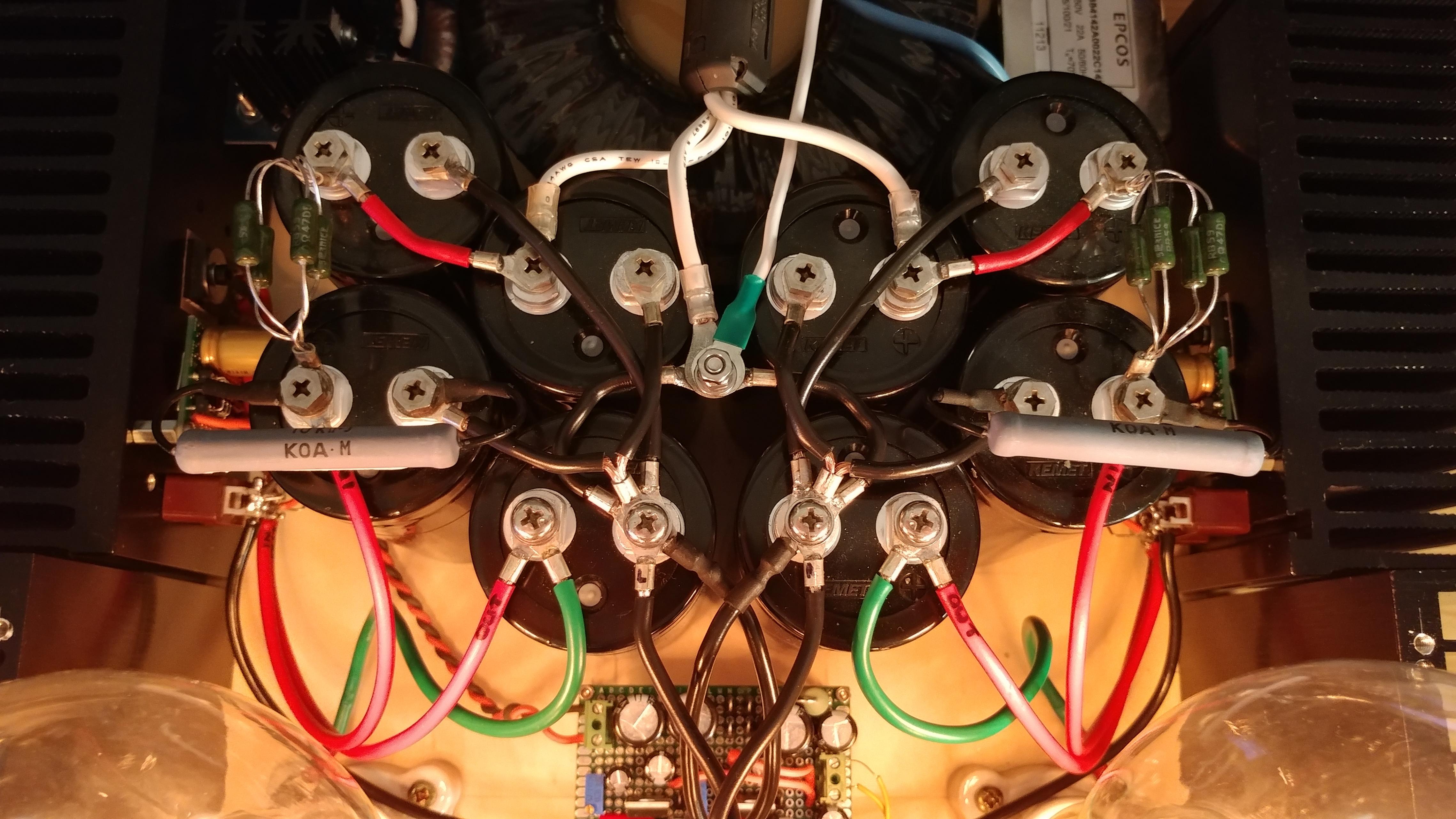

Okay, so I reworked the bias supply and changed the grounding scheme a tiny bit. Input ground, bias ground and the VFET's source ground-connection now meet at the VFET and go to the respective star ground from there.
With the inputs individually shorted to ground I get zero hum through headphones (HD800, with 10R in parallel) connected to the output. As soon as I leave the inputs open or connect a source, there's audible hum. I'm kinda running out of ideas.
The output ground is connected to the star ground. Should I route it to the VFET (source) and ground it to the star ground from there? But if that connection is what's causing the hum, why does shorting the units silence the amp?

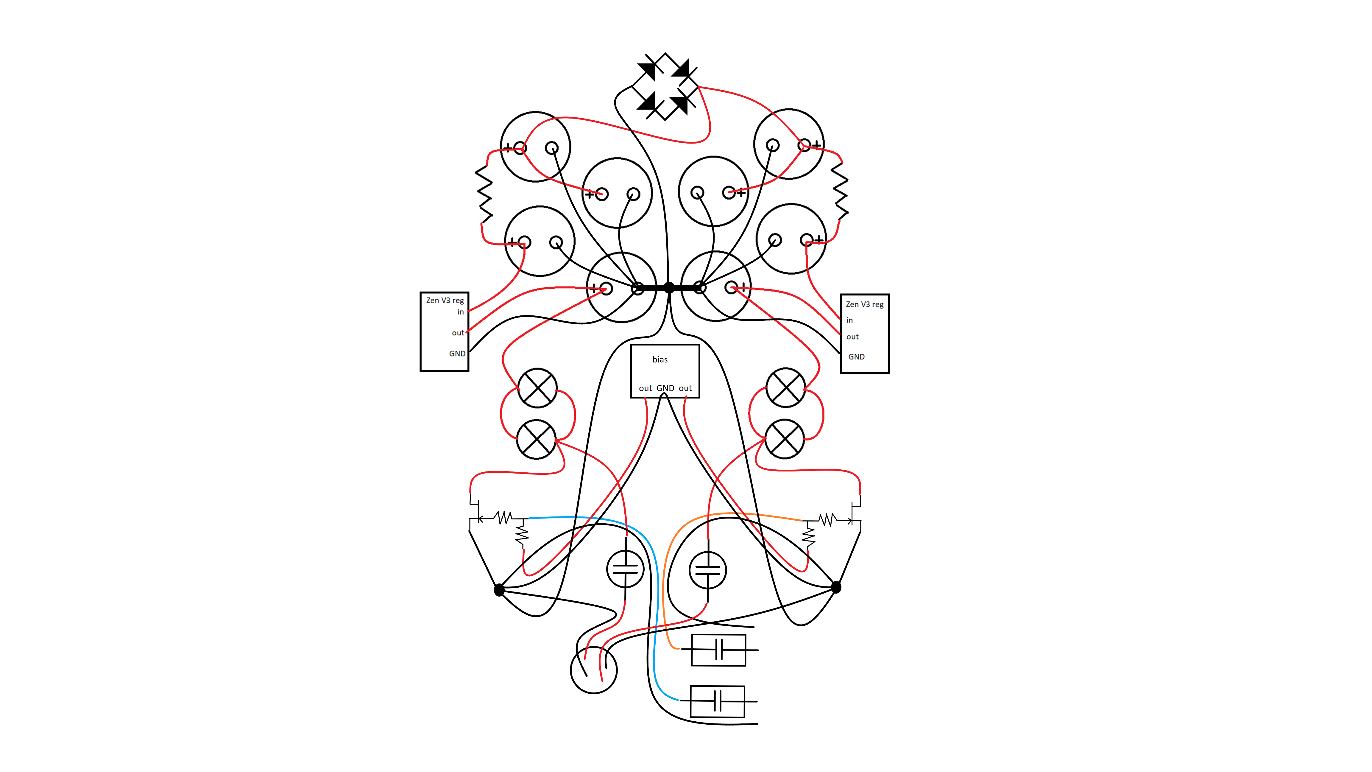

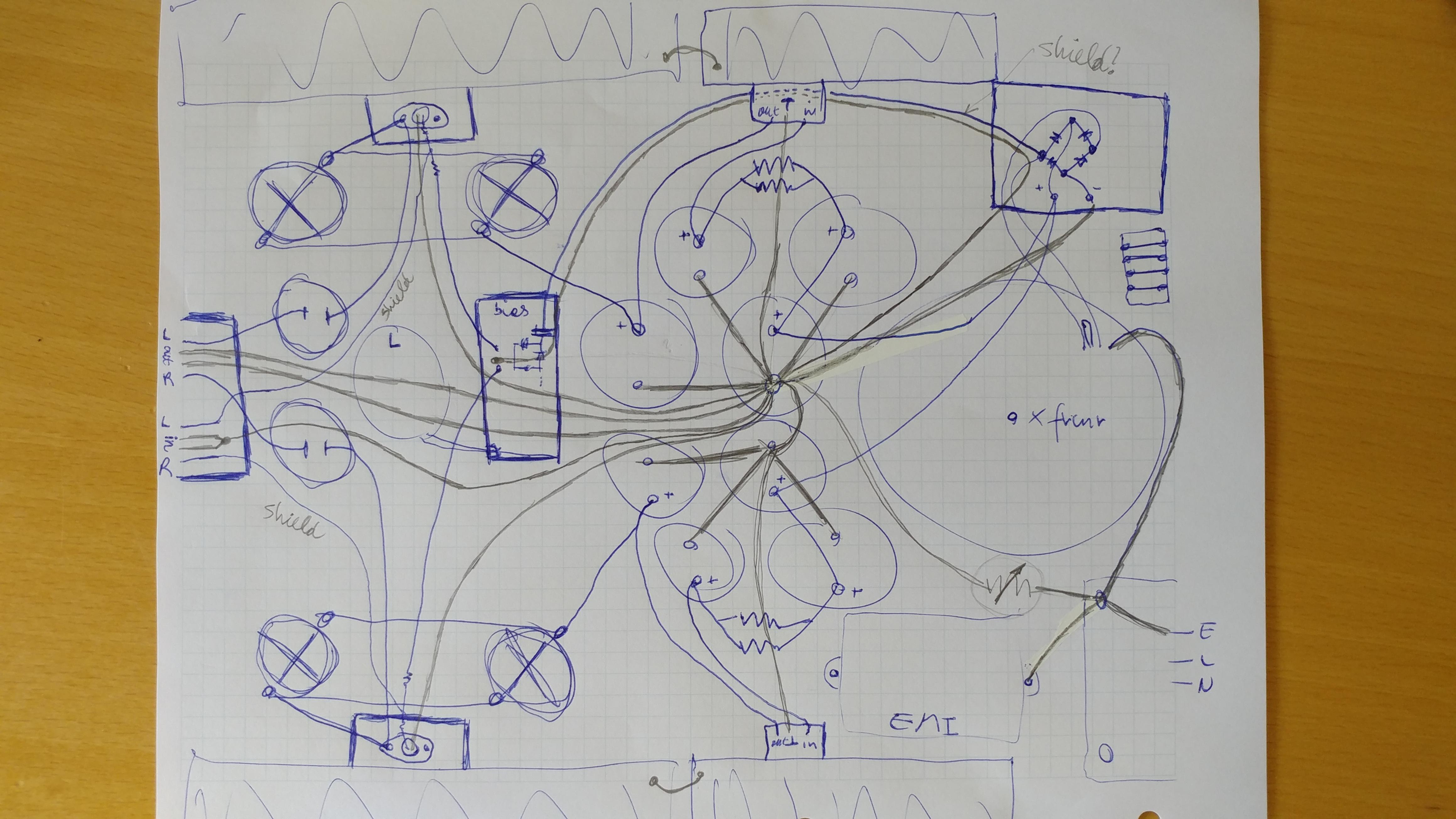

Oh boy, here we go. This is a sketch I drew up before starting with the build. It's surprisingly accurate, albeit ugly.
Edit: I must be getting close. Like I said, with the inputs shorted they're sub-mV noise. It must be the grounding.

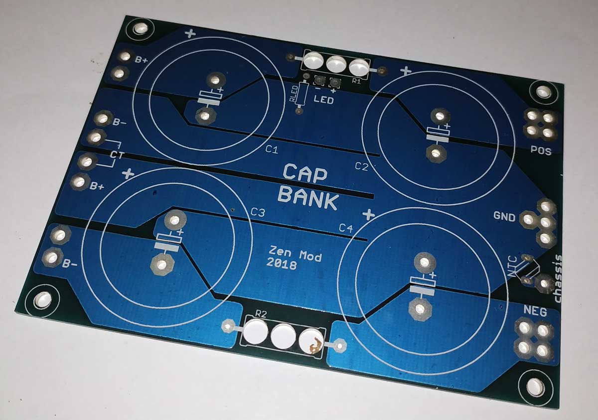

If I'm reading the pcb correctly, POS and NEG is the input side, and B+ and B- are the outputs. The ground plane is slotted to route the ground currents in a start-ground fashion.
My amp build quite visibly has a star ground too (which is not working 100% it seems). What am I missing?
no Bubba
Pos. GND and Neg are side to load
other side is side leading from diode bridges
Okay, I thought that the first cap as seen from the rectifier is the lowest impedance point of the PSU and is thus used as the start-ground location. Guess I'll move the star-ground point to the ones furthest away and see what happens. Should be easy enough with the screw terminals and all.
your GND take out ( leading to load) point must be equidistant to terminals of these two central caps , and also need to be mounted not in area of greatest pulsating currents
one Al plate would do the job - with 3 holes ; two holes for caps terminals , one hole for GND take out point
these 3 holes pretty much forming a triangle
see enclosed

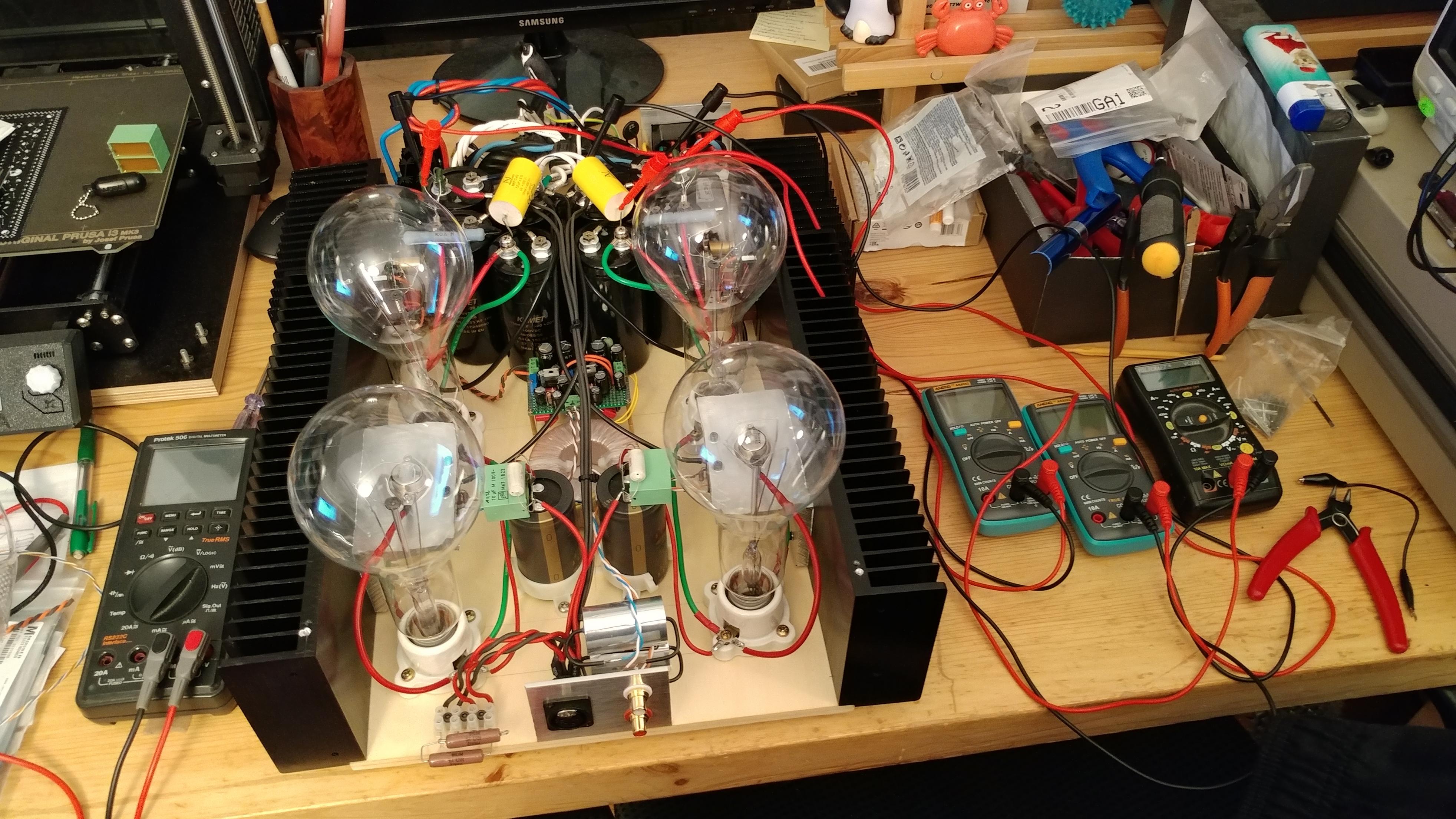

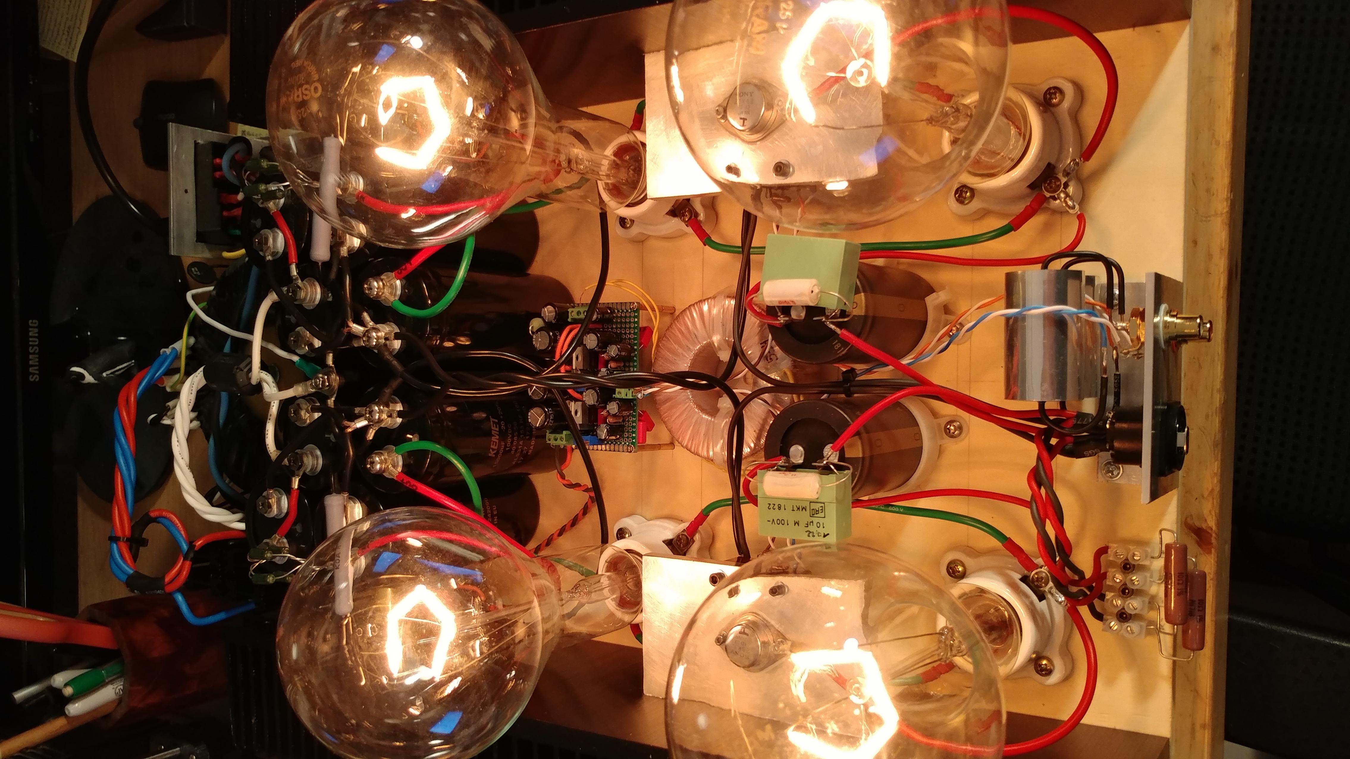

Aight, I rerouted the amp's ground connections and fired it up again. Sub-mV noise with a source connected, just barely audible through the HD800. On most classical records the background noise is above that...
I'm not sure if I can get it any more quiet.
