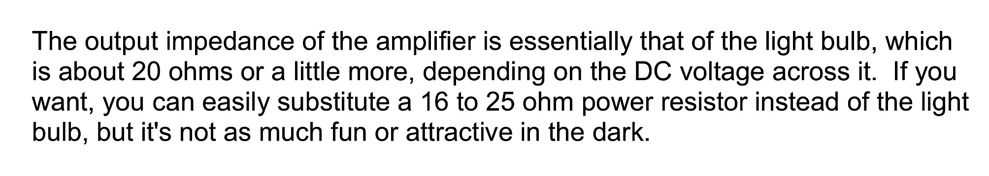

Or in place of one light bulb a 39 Ohm's power resistor 🙂

With big 39R power resistor inside the chassis in pararell with two outside bulbs
You get amp output impedance with lower numbers 11~ 12 Ohm the same like in the Mr. MR article
and that is nicer match for the speakers drivers imho.
Anyways probably You are happy camper with actual sound 🙂 Have a good time
SE Mr. Pass SIT-1 and SIT-2 amp's output impedance = 4 Ohm's.
Different to L'Amp Sony Vfet who = ~ 12 Ohm´s

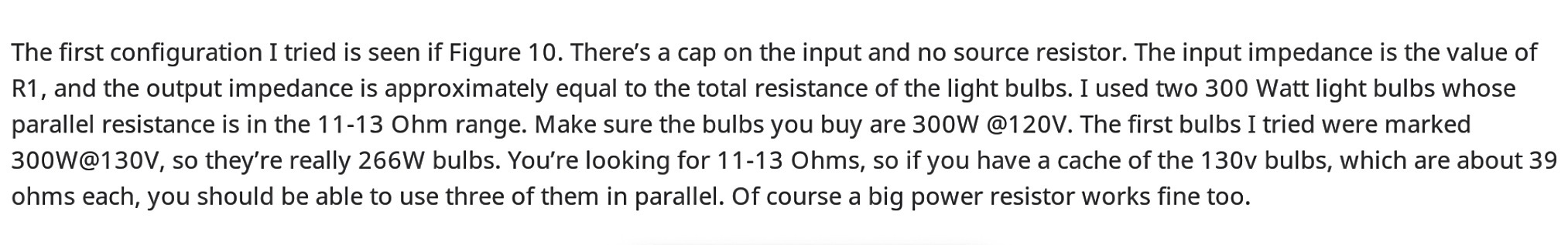

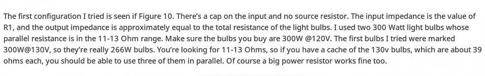

@Soundhappy I've also read that you can use halogen lamps in place of lightbulbs. Have you ever tried them? They are really cheap (I think StefanoBilliani told me).
Just out of curiosity, how do you compute the resistance of a lightbulb to be used in l'Amp?
