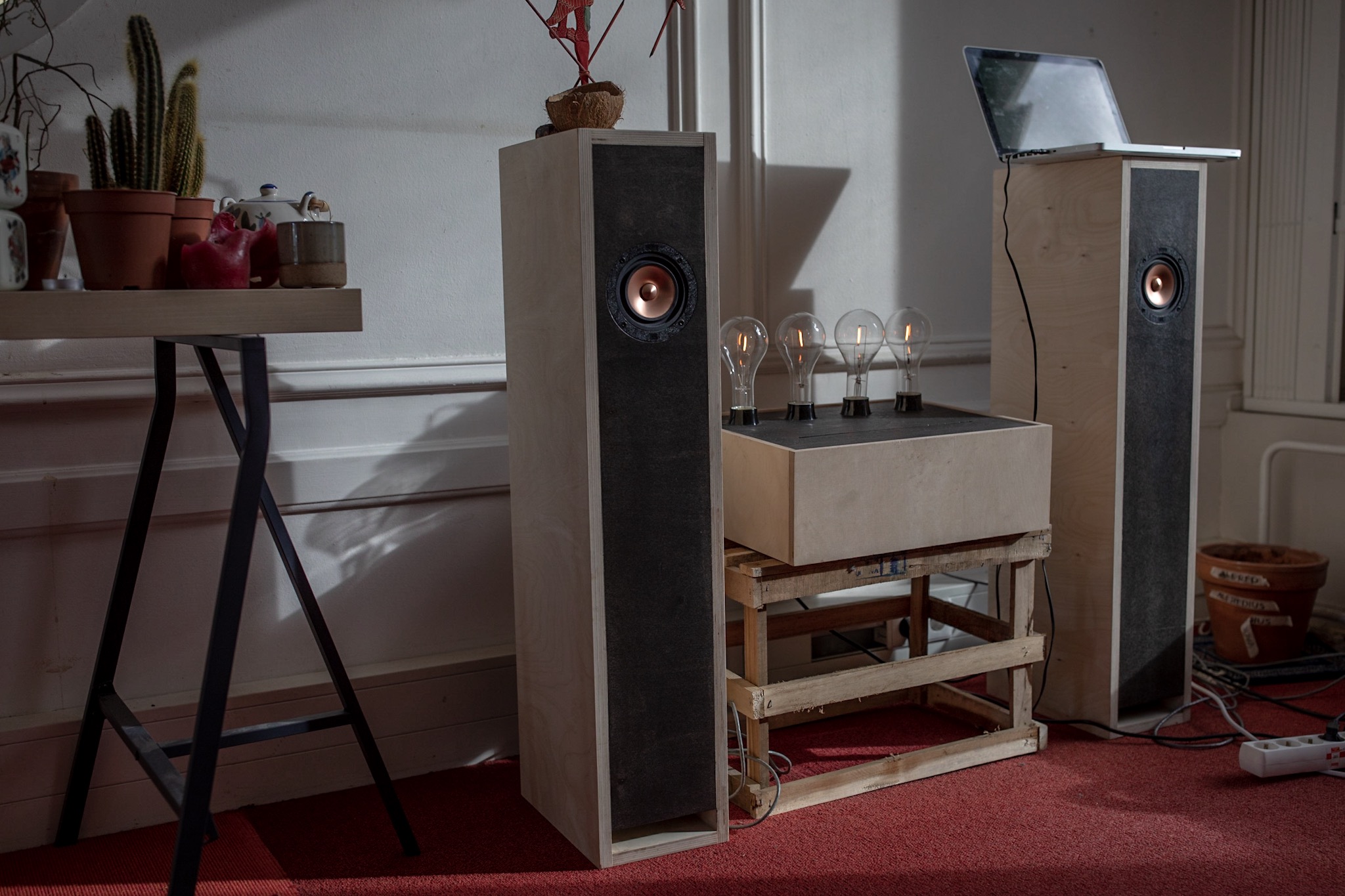

L'Amp: A simple SIT Amp
very nice build !🙂

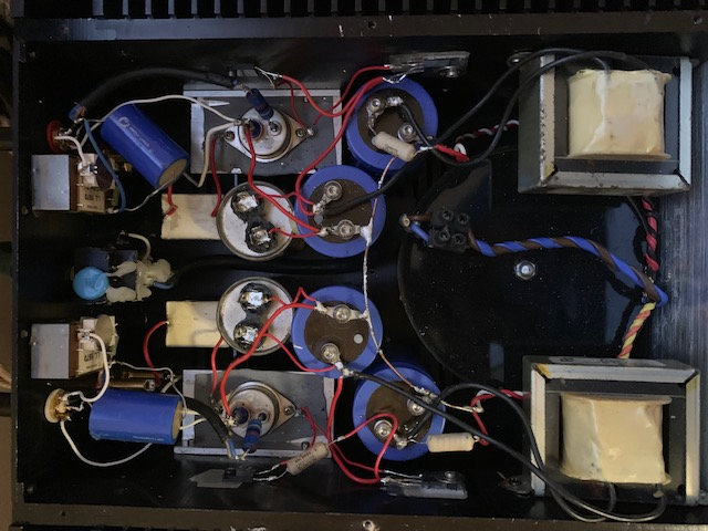

i have built mine with THF51S and CCS loading at 2.1A 30V ,
much balls than my previous Sony 2SK82 amps but mucho heat too :flame:
some will say "fugly"

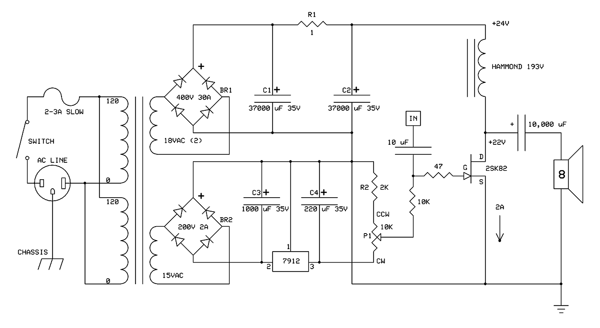

EL Reino - it would be nice if you add exact schematic and few words more about some parts used
I see that you're using Iron in output , but can't be sure is it choke or xformer
take care to use split washers on all bolts in thermal arrangements - everything bolted to heatsink , same as on Graetz bridges

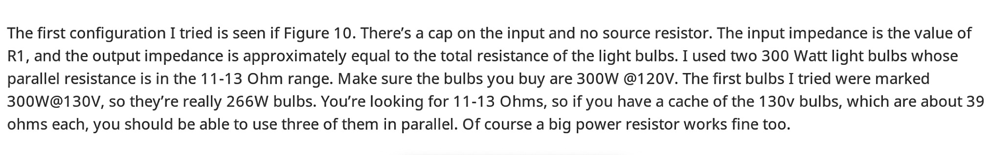

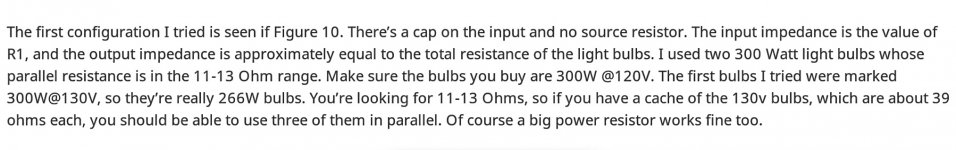

Found it: The resistance varies from 35... 45 ohm for a single, depending setup.
Amazon.c..: GE Lighting 73788 Medium Base General Purpose PS25 Light Bulb, 130-Volt, 266/300-Watt
I got a couple spare...
Thanks Asanden
Is not 120 V version....do You try with 3 bulbs in paralell ?
Extract from Mr. Rothacher article :
