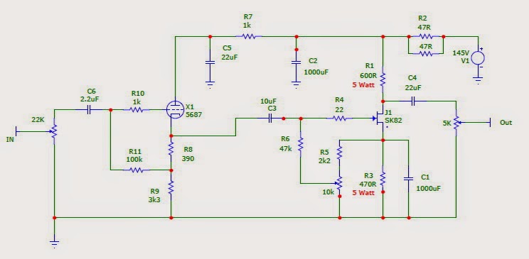

once i connected my dac with srpp ouput to SIT L'amp directly to Alpair 10p, 1 channel only and very loud. tested on slow music Ingram Washington ‎– What A Difference A Day Makes
but for sure it's not practical 😀
hmm, I'm still learning... CCDA tube front end in Soundhappy's schematics also looks interesting.
