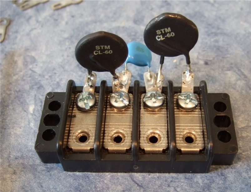

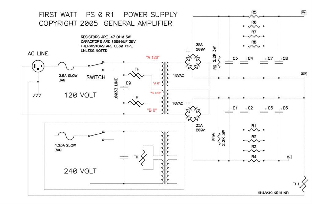

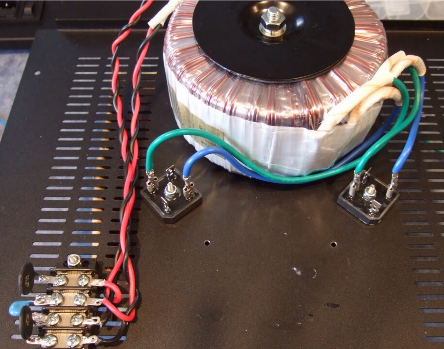

Personaly i have modify psu of one amplifier who have on/off thump
and solution was extend by in rush current CL-60 thermistor and capacitor
like in classic First Watts amplifiers psu's. Photos from 6L6 guide Thanks.

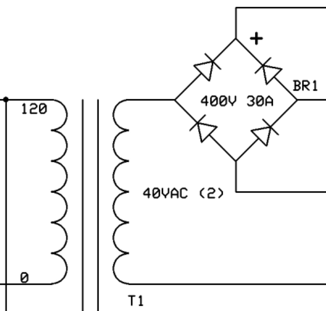

What your psu transformer primary 120 V ?

City mains is 220V in the city I live.

My psu extension to avoid thump was much simpler with only one primary if is your case
i just cut hot ( phase ) wire and connected CL-60 in serie and on switch
one capacitor connected to on/off between phase and neutral wire or directly to switch.
Capacitor who can accept 250 V or more in this case and no polarised type.
Btw my psu modification work perfectly in 20 watts Hiraga amplifier
psu are filtered with 2x450 000 uF caps and in rush current was huge.
No thumb now only silent switch operation.

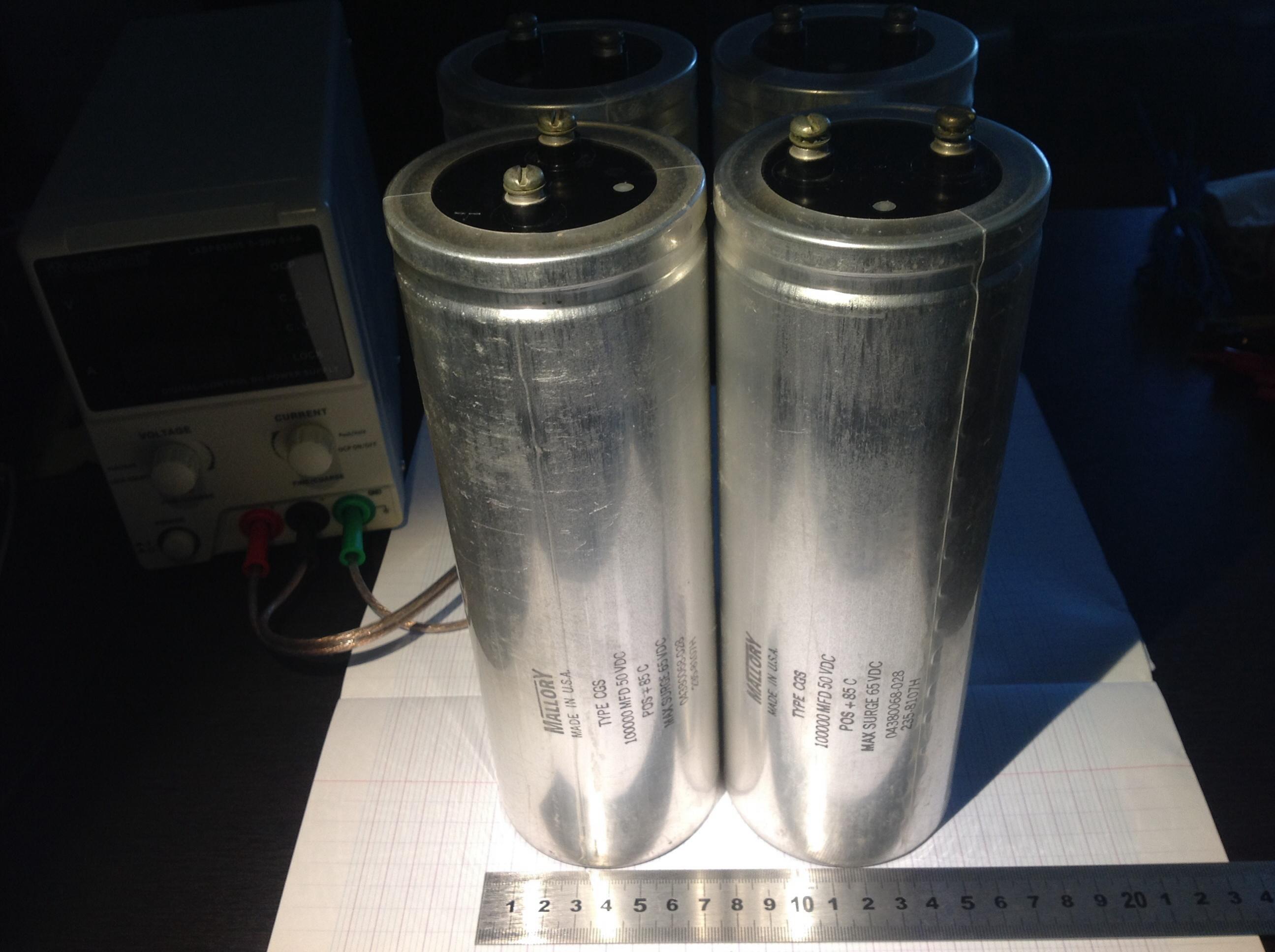

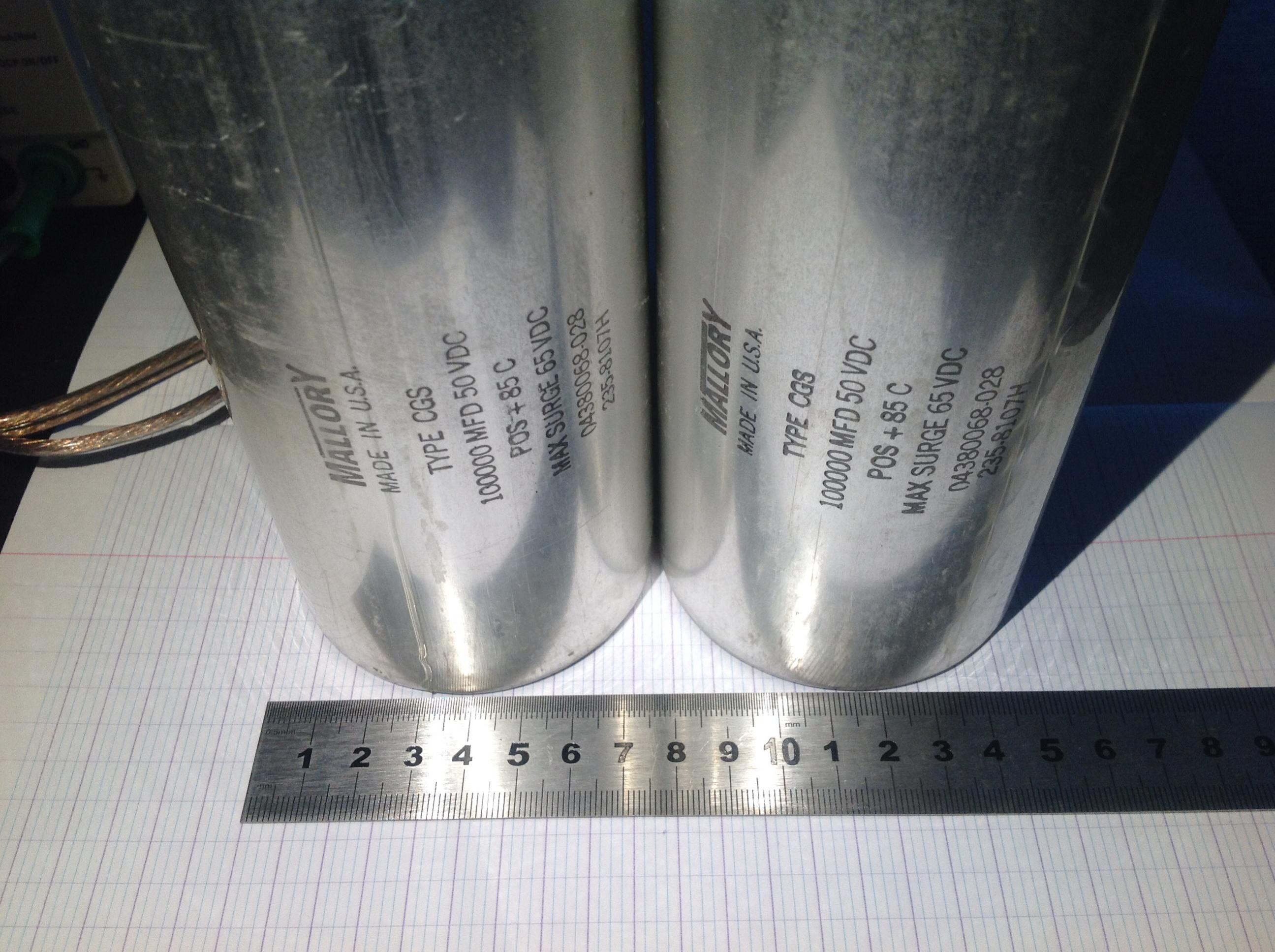

I don't have caps of correct value/rating at hand, but I did a quick test with these 2 big caps (image attached). There is a very slight thump with these oversized caps, but not enough to worry me about damaging anything, and hopefully thump will become negligible when smaller caps are used, or else I'll try your power supply mod.

All honour is for First Watt Mr Pass simple solution i just adapted to Hiraga amplifier and can work great in L'Amp or Luminaria.

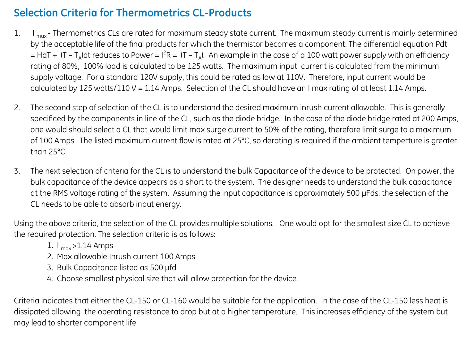

For your specific needs they are precise formula for choice of CL.
All i know about big in rush current they electricaly stress components & vfet's and shorten his service lifes.
BTW nice big caps i like it hmmm with great old school Tokin Fantastic !

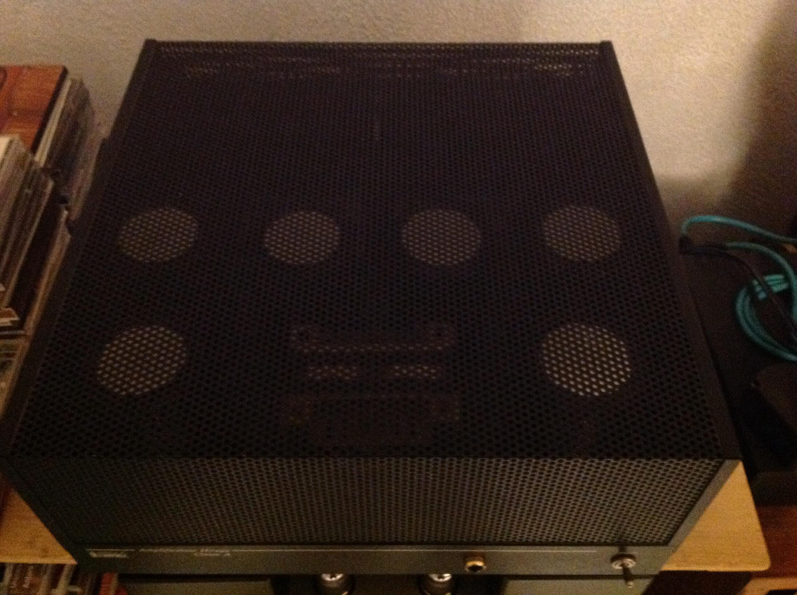

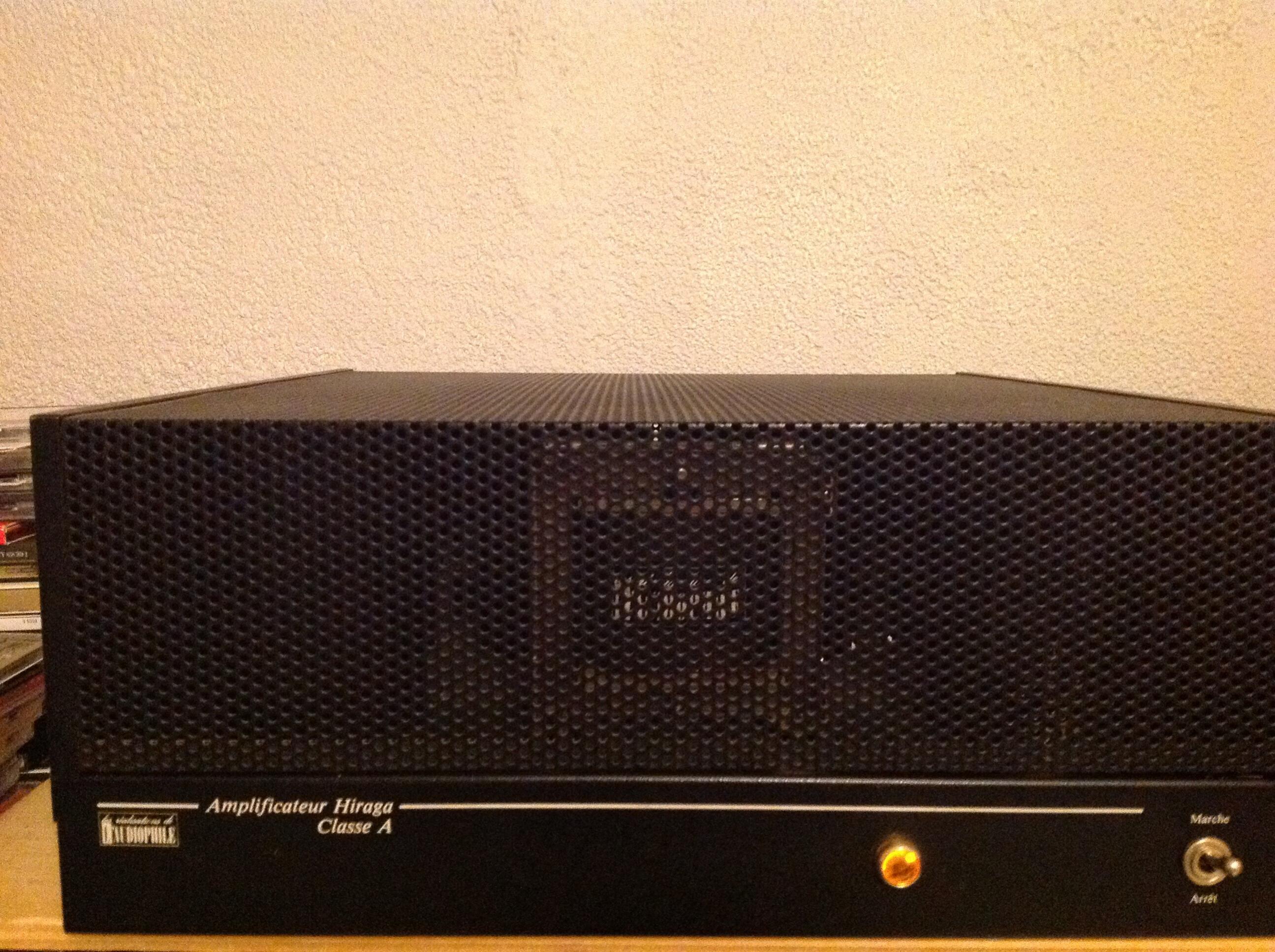

I really like the way your amplifier enclosure is built with the perforated black metal top cover. Very nice! The perforated metal is one of my favorite enclosure materials. I have alway liked to be able to see inside circuitry.
Yes is interesting design all perforated cover and metal base
disipate portion of the heat not only heat sinks.

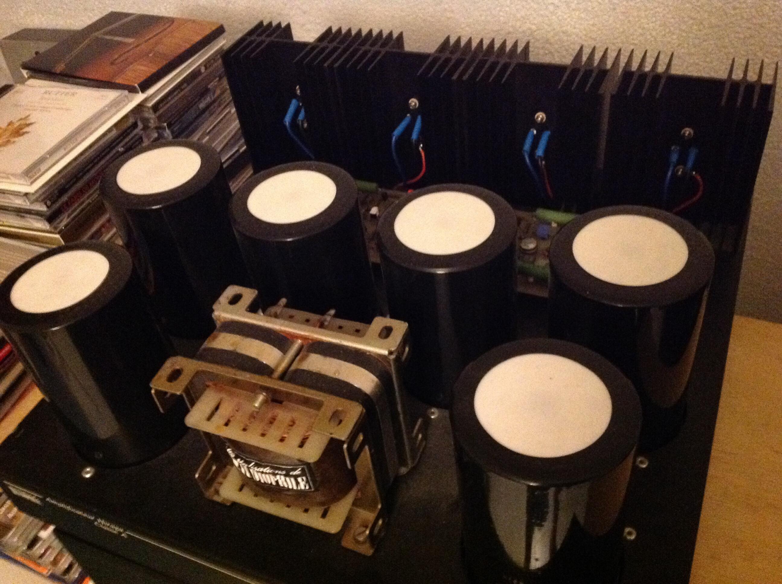

Great idea is to connect L'Amp vfet amplifier circuit to psu with BIG
6x150 000 = 900 000 uF caps bank or +
That is Mr Hiraga class A style
fews watts with " muscular " psu.
Hope this inspire L'Amp future builders.
Never to much heat sinks or psu caps

ps. inside circuit photo

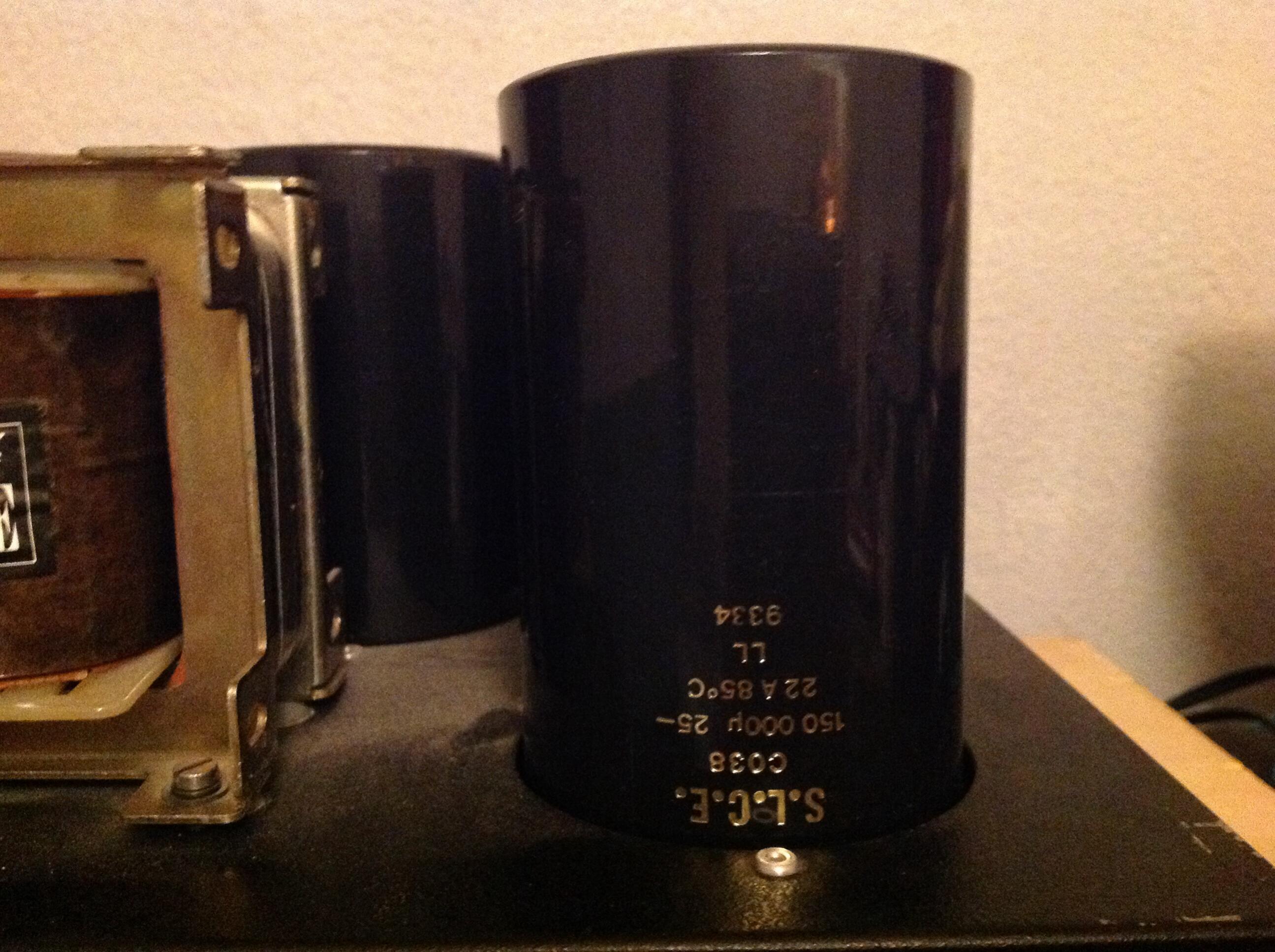

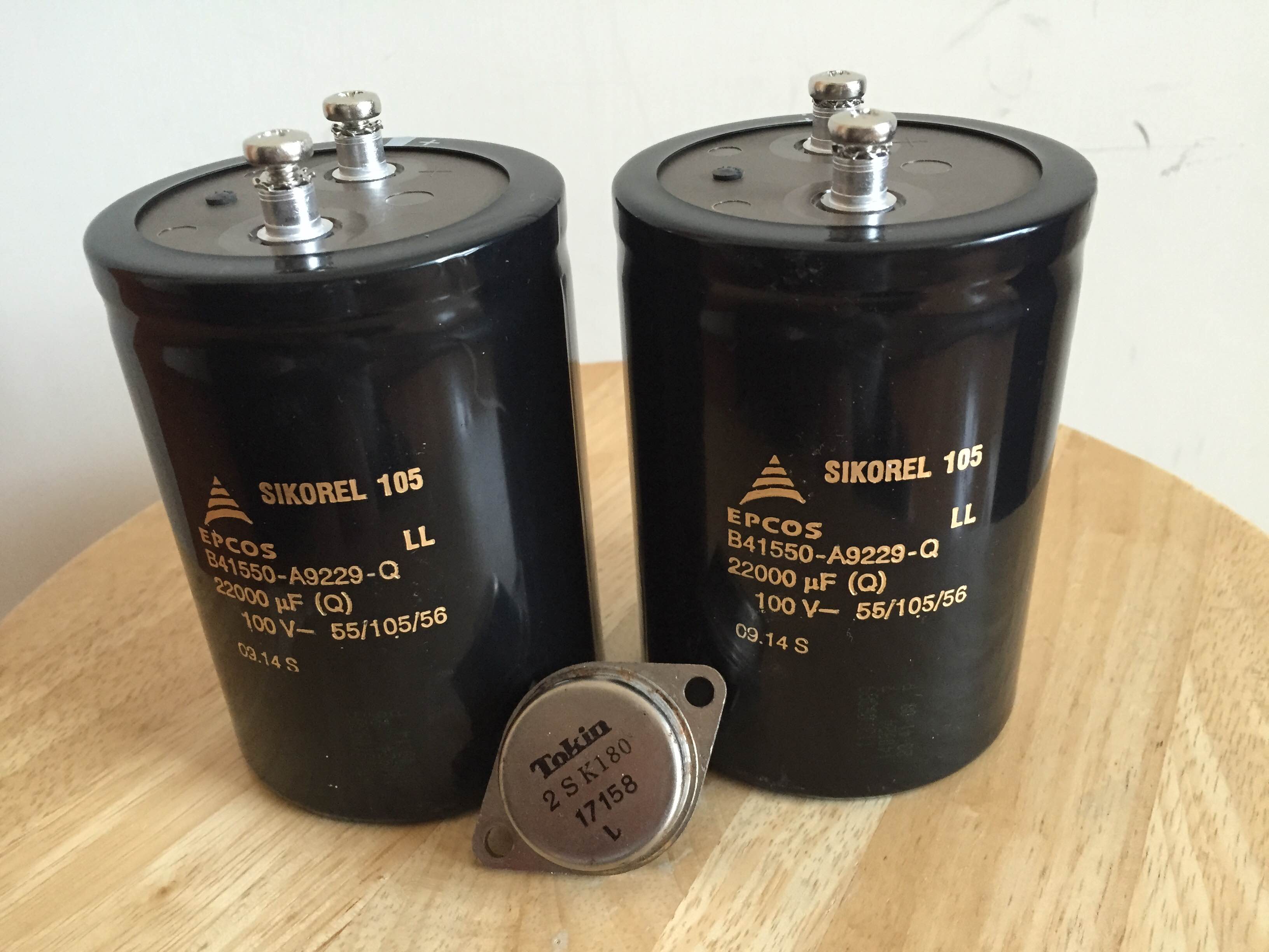

... 6x150 000 = 900 000 uF caps bank ...
This is huge 😱
What is the voltage rating of these caps?
This is huge 😱
Huge
Rating = 25 V of this ones perfect for L'Amp 193V.
Higer voltage for others L'Amp circuits = 50 V rate
Yours are best for l'Amp version width Tokin sits 100 V
Many smaller low esr caps work great , important is
to go around 1Farad of total capacity say Hiraga San.

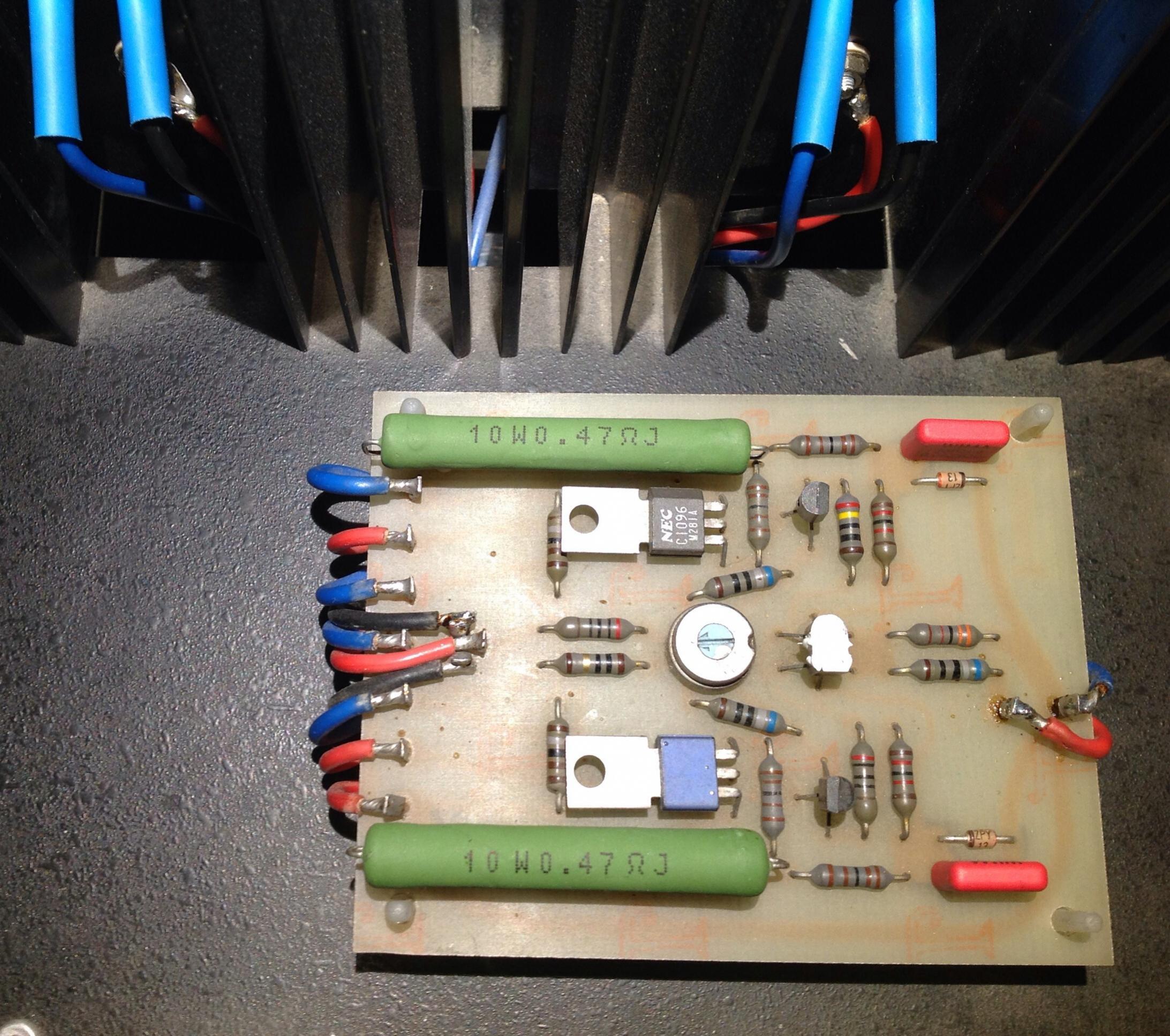

Thank you for the driver board photo. Very nice! What type are the 0.47 ohm resistors?
Also interesting how you thermally coupled the two small transistors. In the past I have done similar by placing them face to face and putting compound between. I'll bet it sounds really great.

Hi MikeWhat type are the 0.47 ohm resistors?
They are metal oxide film type 🙂

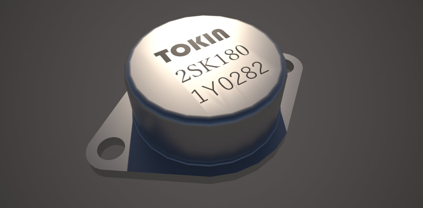

About Tokins we are on forum aware so is to late ask about of 1Y and 1Z batch
if other batch number they are possibly ok anyway
try test them with curve tracer sadly probably this 1Y ones is not working units for audio
@soundhappy
ok... where can I buy some audio 2SK180? or replacement?
Your batch are 1Y ?
I think so! Yes, if I believe in what I saw on the foto!
This photo can be old one and no actual batch 🙂
so best to do is ask the seller if you can ?
If they are 1Y i remember Cwtim01 and Mr Rothacher write on forum
about this no hope for good curves after his tests ....search in thread posts.
