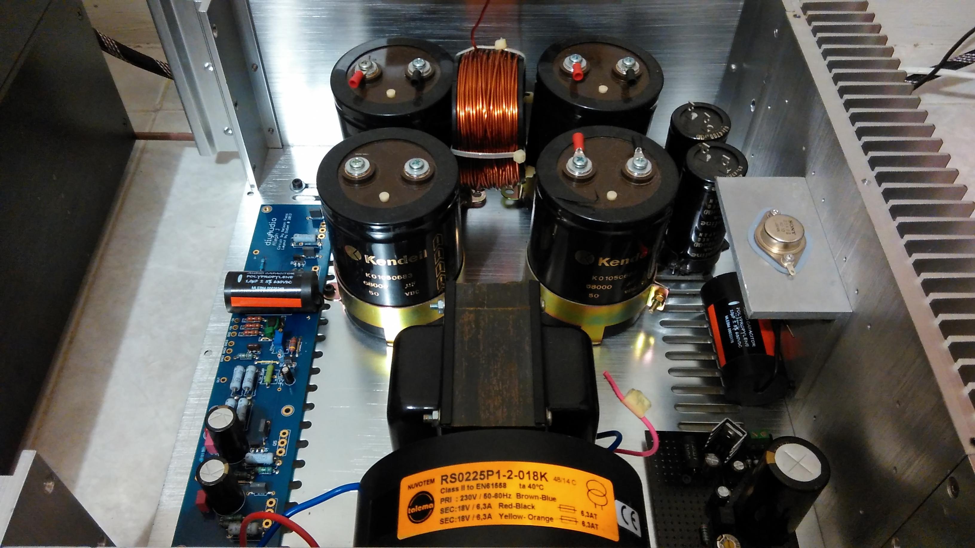

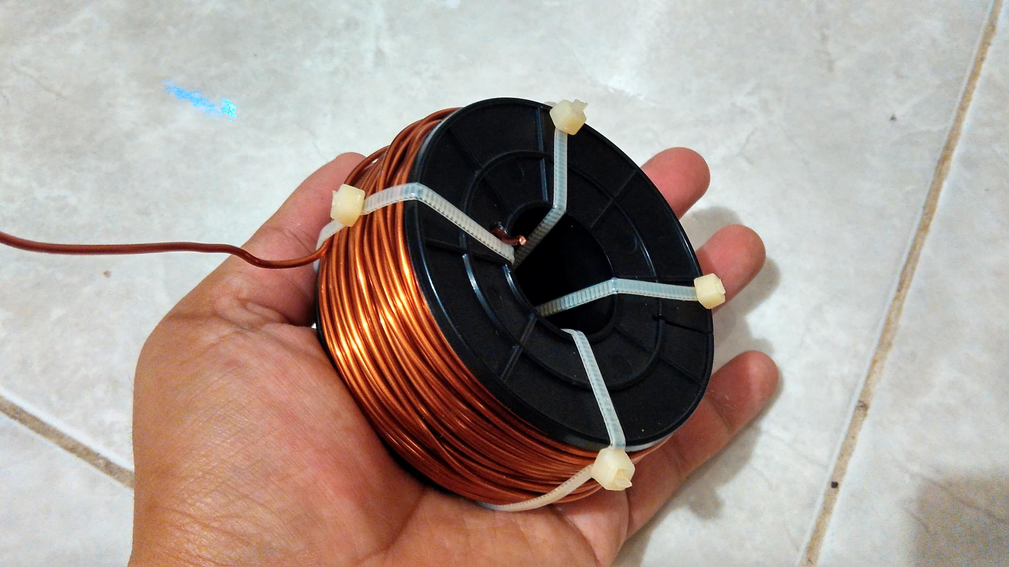

just finished hand wound inductor (1of 4) for CLC supply using hellenic copper wire 14awg around 50m length. ebay plastic bobbin 8cmx3cm really help to wound it. since i dont have any L meter, using web calculator should give around 4mH, and measured DCR is 0.51 ohm
with 3hrs of working and $8 wire, i think that no any commercial inductor will close to this diy inductor for price/value 😀

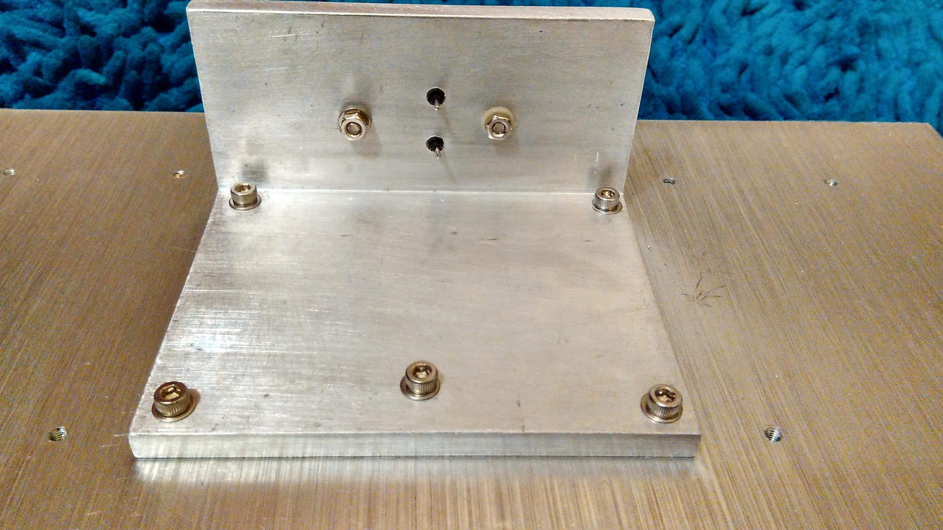

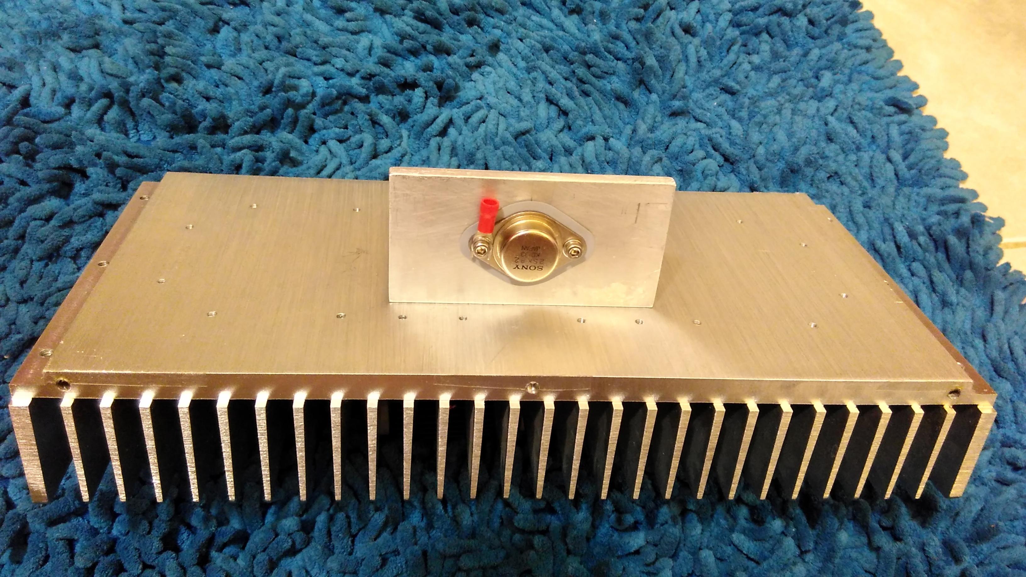

i've completed making UMS on 2 heatsink, hand drilling and tapping for 50holes is really good exercise for my muscle. still got another 2 heatsink to be completed
i have question, why most of sample that i find, B+ supply is connected to drain using a screw? i'm planning to use power connector spade

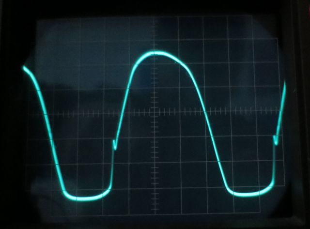

Hello,

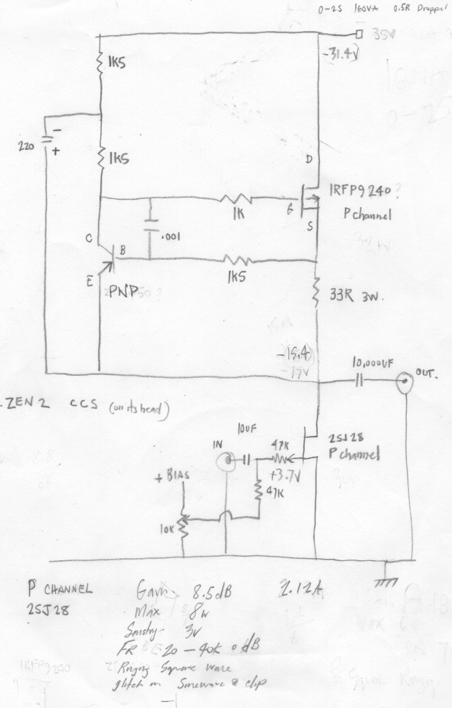

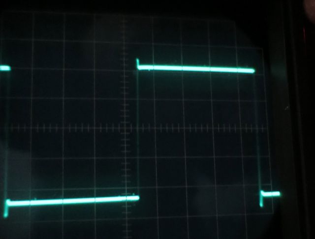

I have my 2sj82 L' Amp with the ZV2 CCS up and running with a strange sine wave at clip (see pic) Ive never seen that before. In square wave it rings. Why is it doing that ?
Ive have updated my scheme with actual voltages and notes. I was so excited to get the CCS working!.
Does it look like my operating point pretty high up the load line or is it an oval load with a CCS?
Thank you guys best regards David

then nothing wrong
you can't expect symmetrical clipping from circuit which isn't symmetrical
read enclosed for example and more insight
(you have sine flipped upside down due to flipped voltage/phase)
regarding square ringing .... either leave it or compensate ......... probably irrelevant to sound in this case

Interestingly, if we try to bias the stage to saturate more symmetrically, distortion and maximum power are altered, usually for the worse.
This soft saturation is something that makes clipping noticeable only when the THD is very high; It works like a compressor. So, in this conditions, SIT amps makes the sound appear more powerful than really is!
