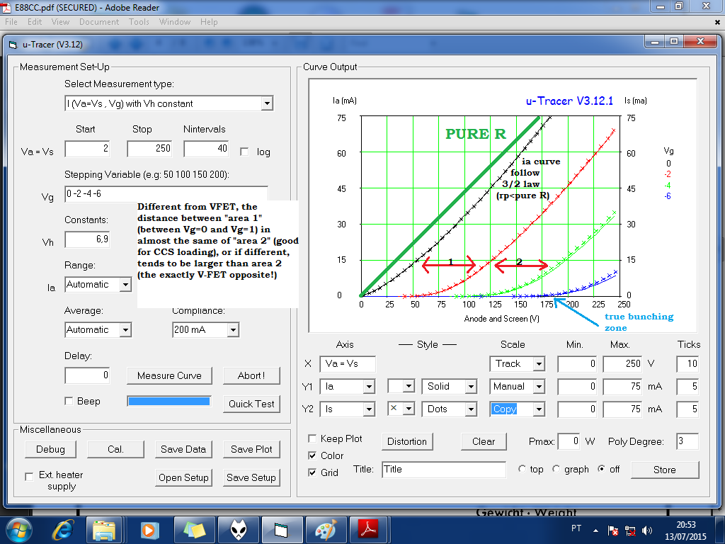

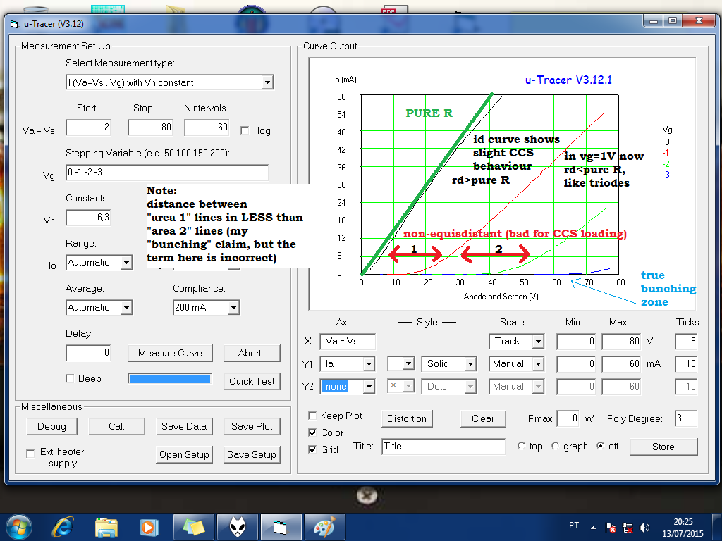

Tonight I realized (finally) I was using the wrong terms.😱 "Bunching" is for extra curve bending, I think.
I made two small and simple illustrations to show what I meant. Please correct me if I have changed terms again...
Of course most people here noticed these characteristics (or else the simulators people are using would not show the argumented results).
However my FFT measurements and curve tracing are correct.🙂 For most common triodes and VFET I know, the behaviour is like from these examples.

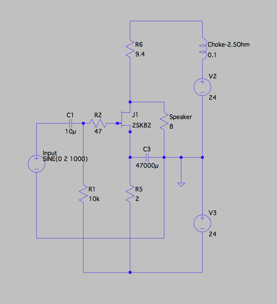

I posed the first version on the Ironamp thread earlier today, but after a few update, it's not Ironamp anymore, so I repost the updated version here. I'm a novice and this is the very first amp I made up on LT Spice which I just learned with excellent Michael's video (Thanks you!).
On LT Spice, 2A, 20V(ds), Bias 4V, 6.7dB gain, 0.25% distortion@8W output, -1dB @30Hz-100K
1. PSU is Universal PSU for DIY Aleph J. +-24V (I have one, so want to recycle it.)
2. Choke is 0.1H 2.5ohm (I have a pair here)
If it would work in real world, I have a few questions:
1. I'm worried about the inrush current and bias at the startup.
2. How about output DC offset adjustment and drift with temp change.
Thank you in advance.🙂

1. Me too. The most simple workaround to this is to use some timer relay.
2. Well, the SIT is an very stable semiconductor, but... not so stable to warranty simple circuit direct coupling I fear. At least because you need to find some sweet spot and this will offset the drain voltage.
I add an #3: the PSSR behaviour. Is good to chech it first in simulation, making the sim PSU noisy (eg.: configuring them like an AC source of 1V/120Hz with 24Vdc offset to simulate an noisy PSU). I fear this circuit maybe pass/amplify the PSU noise in some cases.
Personally I prefer to use an single supply / original design to avoid all these pitfalls. is more simple 🙂 and esay to use: only series the two PSU and ground the most negative one. And the cap move from a low impedance node (SIT source) to a node with higher impedance/no amplification: the output, so I expect less cap sonic signature.

Thank you for the detailed advice.
Actually, the reason why I had to update the design was PSRR issue, but anyway, as you suggested, I'll try series (48V+ single) with output capacitor at first. Then I can try dual from single design without much modification.🙂

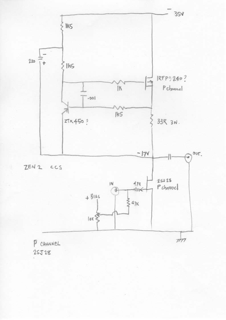

Hello Fellow SIT listeners and builders,
I want to try a Zen V2 constant current for my a P channel SIT amp. Ive sketched the scheme but Im unsure about how to do it with the reversed polarities. I have copied the Zen ver2 CCS fig. 2 and changed the irfp240 to a irfp9240 P channel part and reversed +/- of the 220 cap across the transistor. I don't know if I should use a pnp transistor too. I have an HT of -35V so am hoping to hit -17V with 2 Amps of current at the P channel drain. Im a bit stuck on this. At present I have the original P channel Lamp going, Seemed very strange to work with negative volts but i got it there and to me its a marvelous amplifier. As Mike advised just reverse the polarity of everything for P channel. So Thank You very very much David, also here is a pic of my L'amp with inductors screwd on on a garage sale sign i found discarded in the bushes.
Looks OK to me. If ZM or MR doesn't spot something, then it's OK.
yup , after first today's coffee ( didn't had time in the morning , and it would be impractical taking it while sitting on the head) , I see that's (input cap) exactly needed for seeing Uncle Bob
