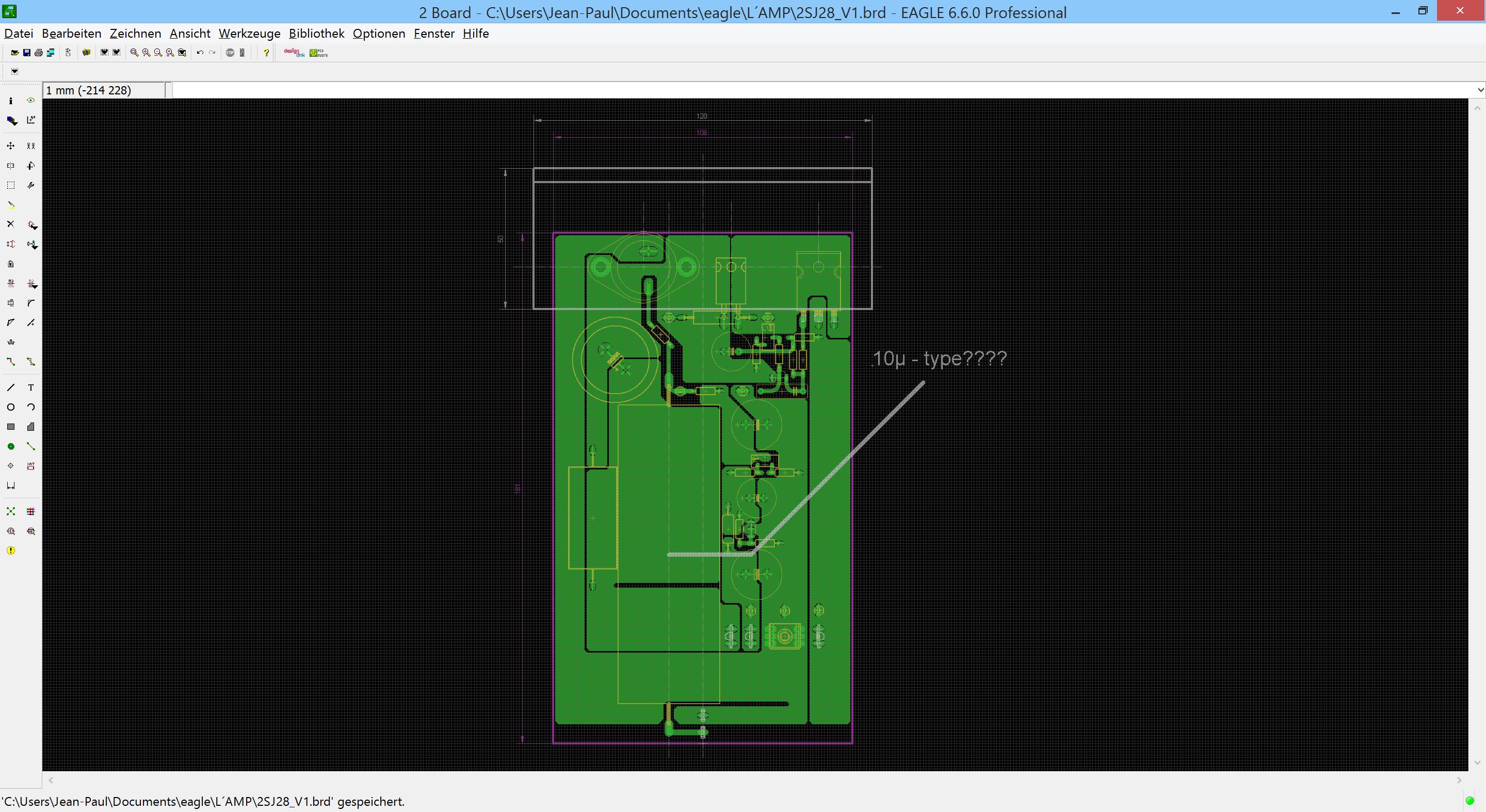

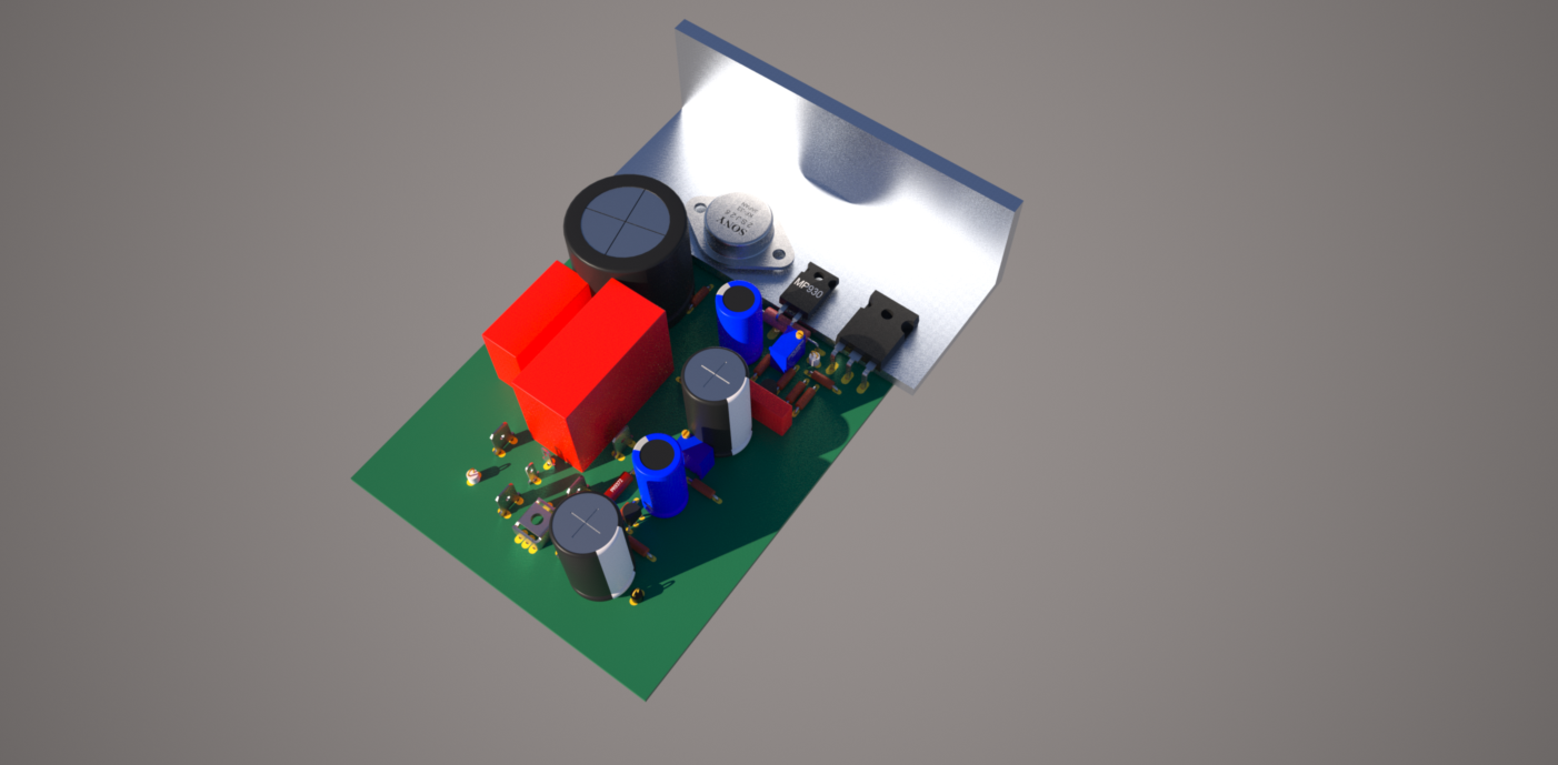

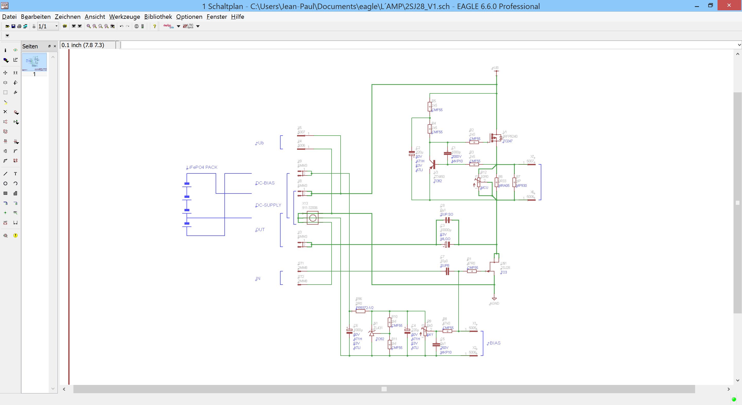

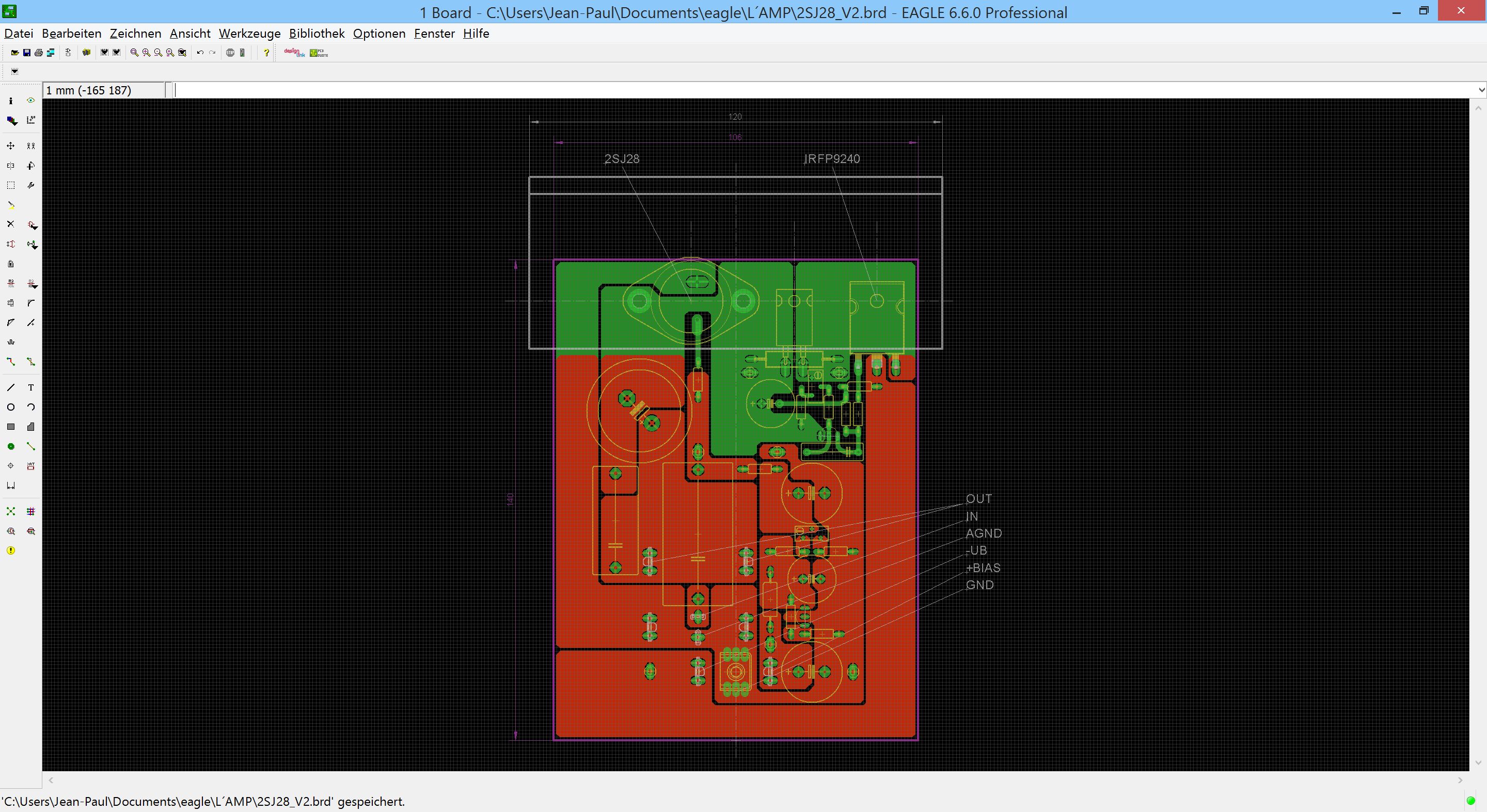

@DIYBras
can you check please?
The schema is somewhat difficult to read, so if I made some mistake about component code, please advise:
The R12 is for adjusting the CCS, I think... Since this is an hi-current node, is good to use an power rheostat or various fixed resistors for jumping/selecting the current (I used fixed resistors). If you use an rherostat is better to use some series resistor for limiting the adjustement at safe current levels (eg. using 1R/5W for R6 and R7, and making R12 an 10R/5W rheostat with 1R/5W or 0R82/5W in series). This will limit the maximum current.
A little 2 tips:
1 - For fine bias adjusting, you can put an 2k2 res in series with R9 bias potentiometer (I think) in negative side/pin, and in series with positive pin some 2k2 to 4k7 (is better to check in practice since I only gess-estimate the values without calculations).
2 - For low/none power-on thump, you can made the C5 with 4700µF.

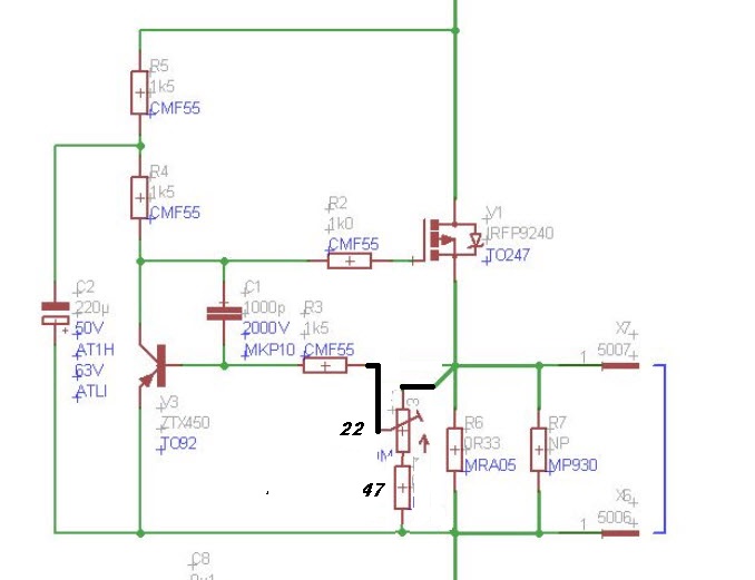

that idea is everywhere in Pass forum , either as Zen Amount Pot (ratio of modulation) or as biasing setting
calc source resistance for minimal intended Iq , move wiper up to source
if you need to increase Iq , fiddle with pot
resistor in series with pot is just to put some boundary to max Iq and increase amount of fine setting
as drawn (47R fixed + 22R** pot), you can have effective source resistance (strictly speaking of Iq setting ) in range of 0R22 to 0R33
**20 or 22 or 25R , dunno what's exact standard
edit:
so , for R6 (ref to pic in post #2234) , if source resistance is 0R33 , effectively in range of 0R22-0R33 , Iq can be set in range of 2 - 3A (0V65/Rs)
in case of 0R47 for Rs , effectively 0R313-0R47 , Iq can be set between 1A38 to 2A07
that's pretty close , even if some are using 700mV as BE voltage reference
however , not changing much
