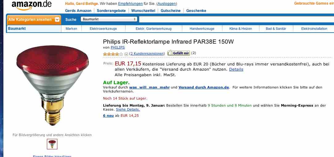

for Germans or EU fans i would recommend this....🙂 though compared to the US price of a 300W bulb fairly expensive..........😱
one has 23 Ohm, two of them should be in the range...
Mike do you think they are o.k.? 150W/230V
if I get today a second bulb in the city I will compare the sound to my CCS....😀
just found a cheaper one......
Leuchtmittelmarkt.com : Philips Infrared lamp 150W PAR38 E27 ES Rot Healthcare
so it cares for your health too and the amp is ideal for certain rooms.....

Hi again!
With this solution you get too many bulbs in parallell - i.e 230v x 230=52900 divided on 150=352 ohm. Then you have to parallell many such bulbs to get 12 ohm! Why not choose 150 watt/24 volt small halogen bulbs. 3 bulbs in seriell will give you approximately = 11,52 ohm and 3x 150watt= 450 watt. Easier wattage than many 230/150 watt big bulbs?
Anyone to comment?
