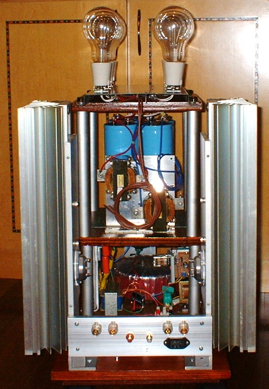

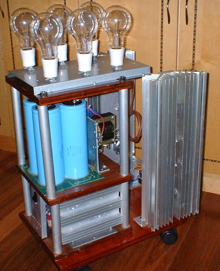

My good friend Tony Wong's SIT amplifer almost complete .. Here's some pics of the amp..

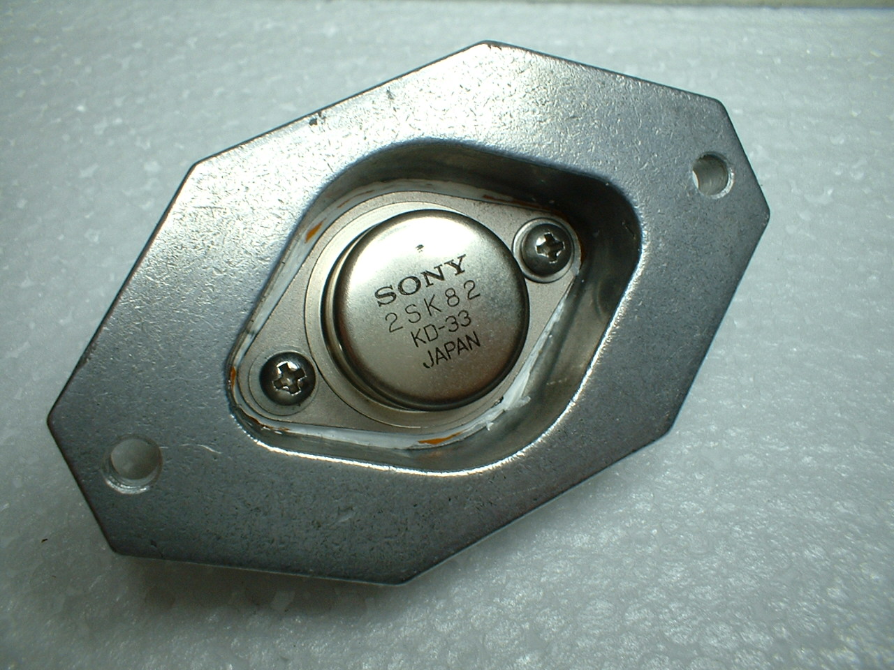

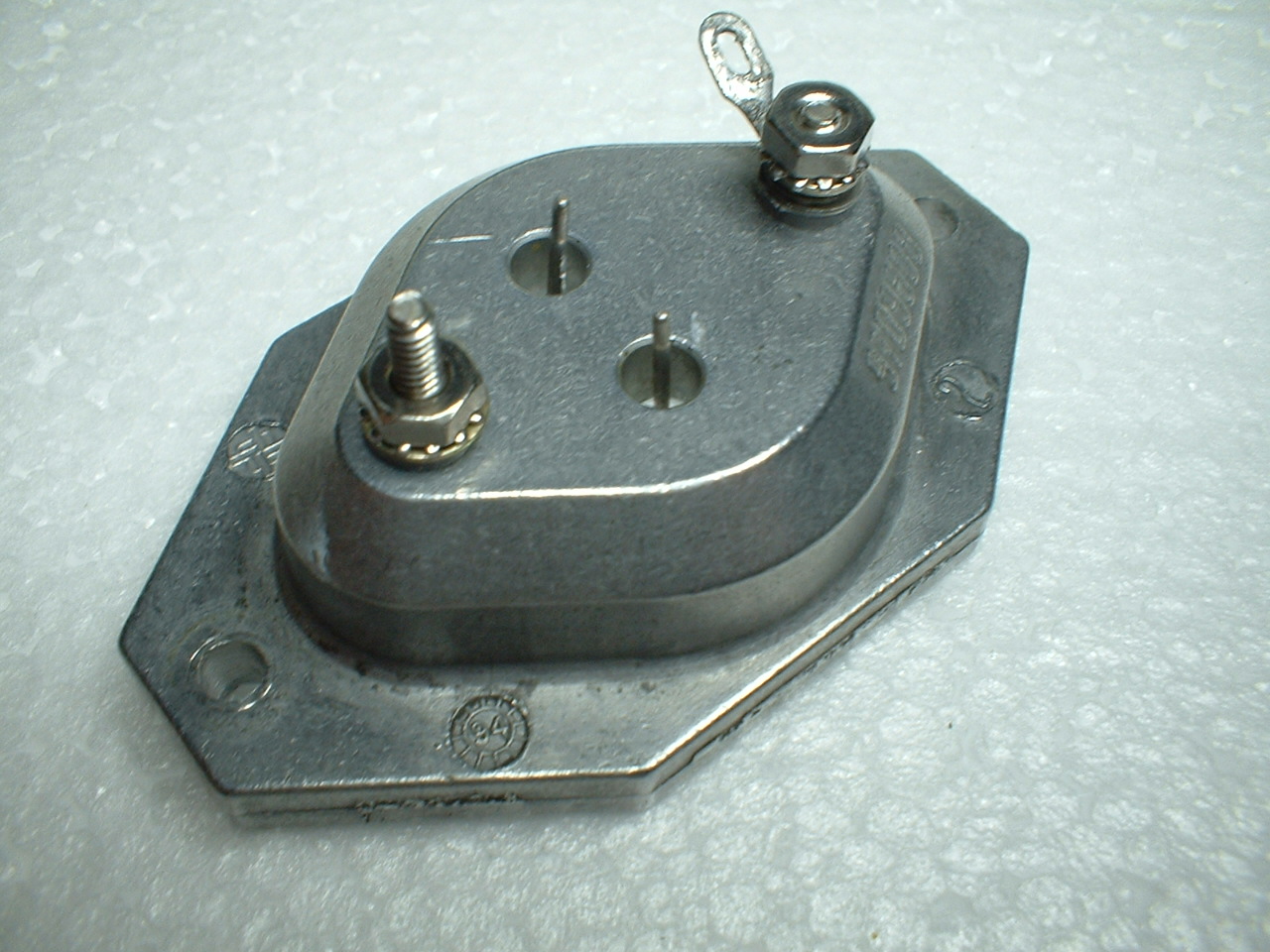

Thanks for your kind comments.. I'm looking forward to hearing it.. Btw Tony managed to get hold of some vintage casing/casting that can be used for the Sony SIT.... Pics below..

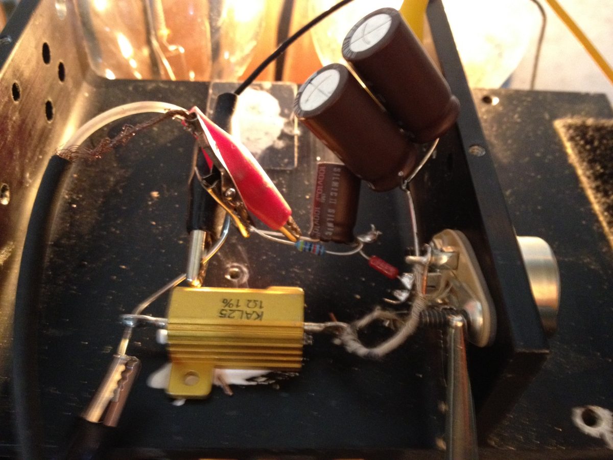

Whilst trying to bias Cascoded BA-2, I soldered this thing together.
Not at all pretty, or safe, but works.
This is figure 11, with 440uf caps for test.
55V V+, 2.6V over 1R, 13V from Drain to ground (I think)

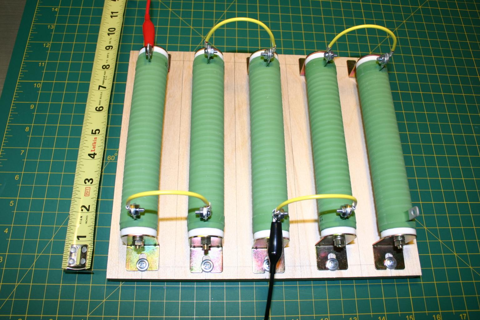

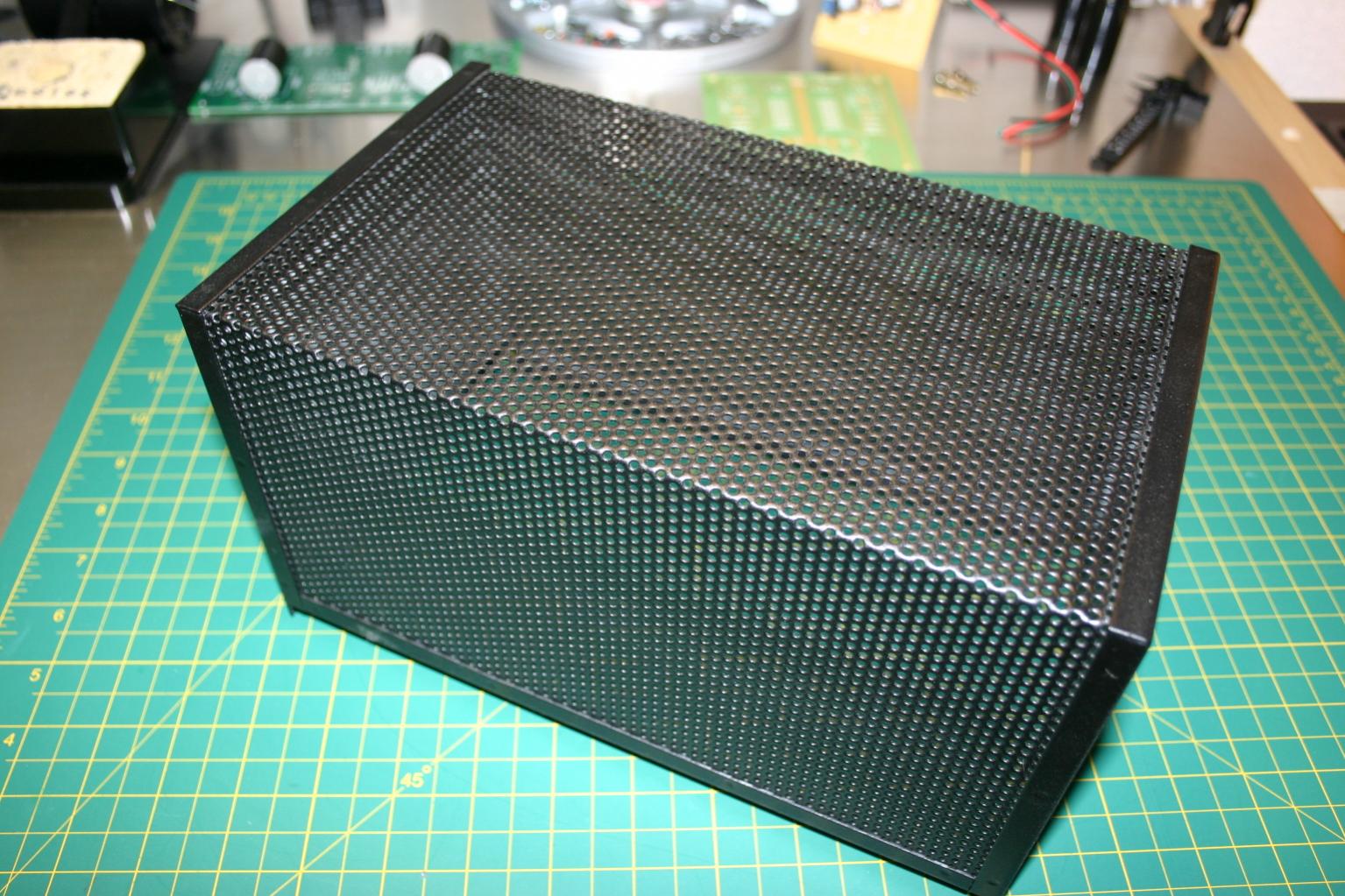

I had a chance to try some power resistors today for those of you in incandescently challenged parts of the world. They are 120W. They have a green coating on the element, and ceramic or porcelain insulators on the steel mounting brackets. You can see they are quite large.
I wired five 4 Ohm resistors in series, so I could try tapping off different load values. You don't have to do that unless you want to; just use three in series for 12 Ohms.
They get hot. They cook along at 100C, like a light bulb. The mounting brackets never got hot, apparently due to the insulation. They work just fine, and work without a heatsink. They also have a nice retro Forbidden Planet sort of look.
If you're concerned about accidentally touching them you can always cover them with a tube cage.
