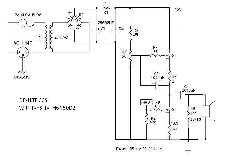

Well, maybe not. It works with an IRFP part also. And is much simpler than those suggested here; simplicity being the motto of this design.
If you want to make it complex there are readymade circuits at hand. The ZV9 aleph ccs would be the obvious choice.
nice much more simple ! do you think we can use the same CCS value for the Sit AMp (with lower B+)
It is also about building a triode like SE amp with semiconductor and without output transformator.
I agree: the De-Lite CCS circuit seems to be the way to go.

Just one fat gate Mosfet is a slow capacitive solution. I would prefer the light bulb if to adhere to the minimum component motto.
You know Salas, I did hear a lot of top end distortion on the delite ccs circuit. I chalked it up to poor layout coz I was not careful in building the circuit. But maybe it was the high ciss of the ccs MOSFET. It did have more power and lower distortion overall though.

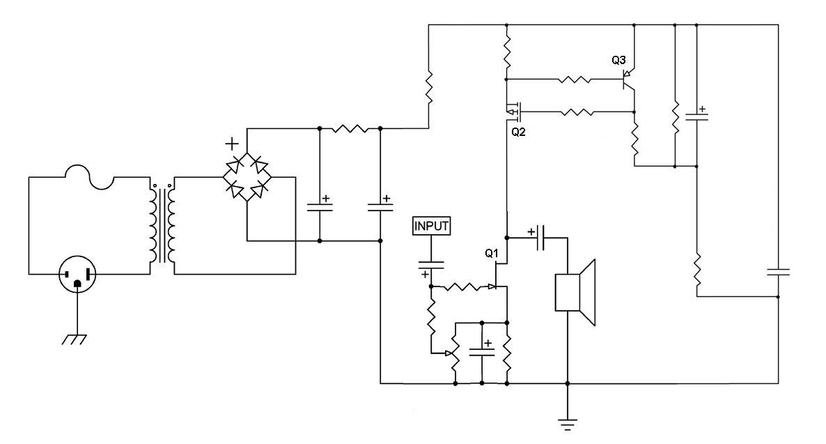

O.K., thinking about, the Salas CCS could be a very interesting variant.
What will be the drain-source voltage for the fet circuit you have shown in post 132, Salas?
Can you show us the BJT variant, mentionned in post 139?

Franz:
~6V on Q1, ~4-5V on Q2 ~0.7V on R1, all at ~2.5A and 15V across the SIT with a 20VAC Tx (about 27VDC rectified under load, so can duck at 25VDC maybe). About BJT I should simulate something.

With 2800pF Ciss and no cascode that IXYS solution isn't as good as those we discussed here.

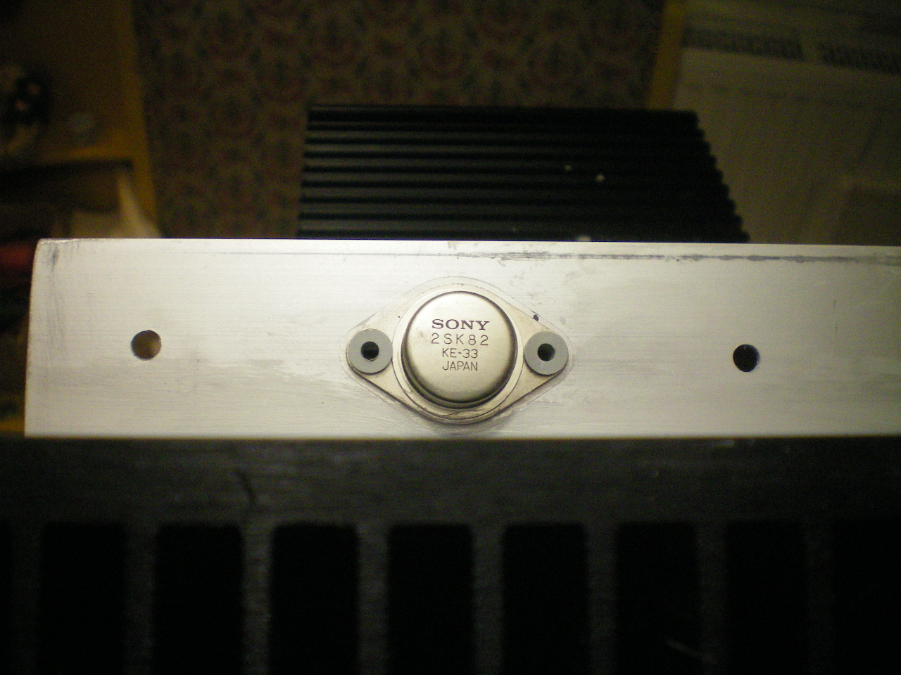

🙂 thanks michael , great information as i have no distorsion meter i will search now 17,5V /18,5V 2.5amp from drain to ground with my variable load resistor.
maybe very important if you order SITs acronman sells here
VFET Sony's Rare 2SK82 (KD-33) N-CH Static Induction Transistor x 1 pcs | eBay
the KD-33 Mike suggested
and here
http://www.circuitdiy.com/product/2sj28-2sk82-sony-vfet-for-ta-n88-class-d-amp-ke-33-1-pairs
the KE-33 he doesn't recommend
because I wanted complementary pair for fun
meanwhile I ordered three pairs and one pair was 😱 KE-33!
because I googled the internetshop and did not remark the difference to the ebay offer!
be aware!!!!!!!!!!!!!!!!!
you see the wrong one even on my picture... hu, hu!
