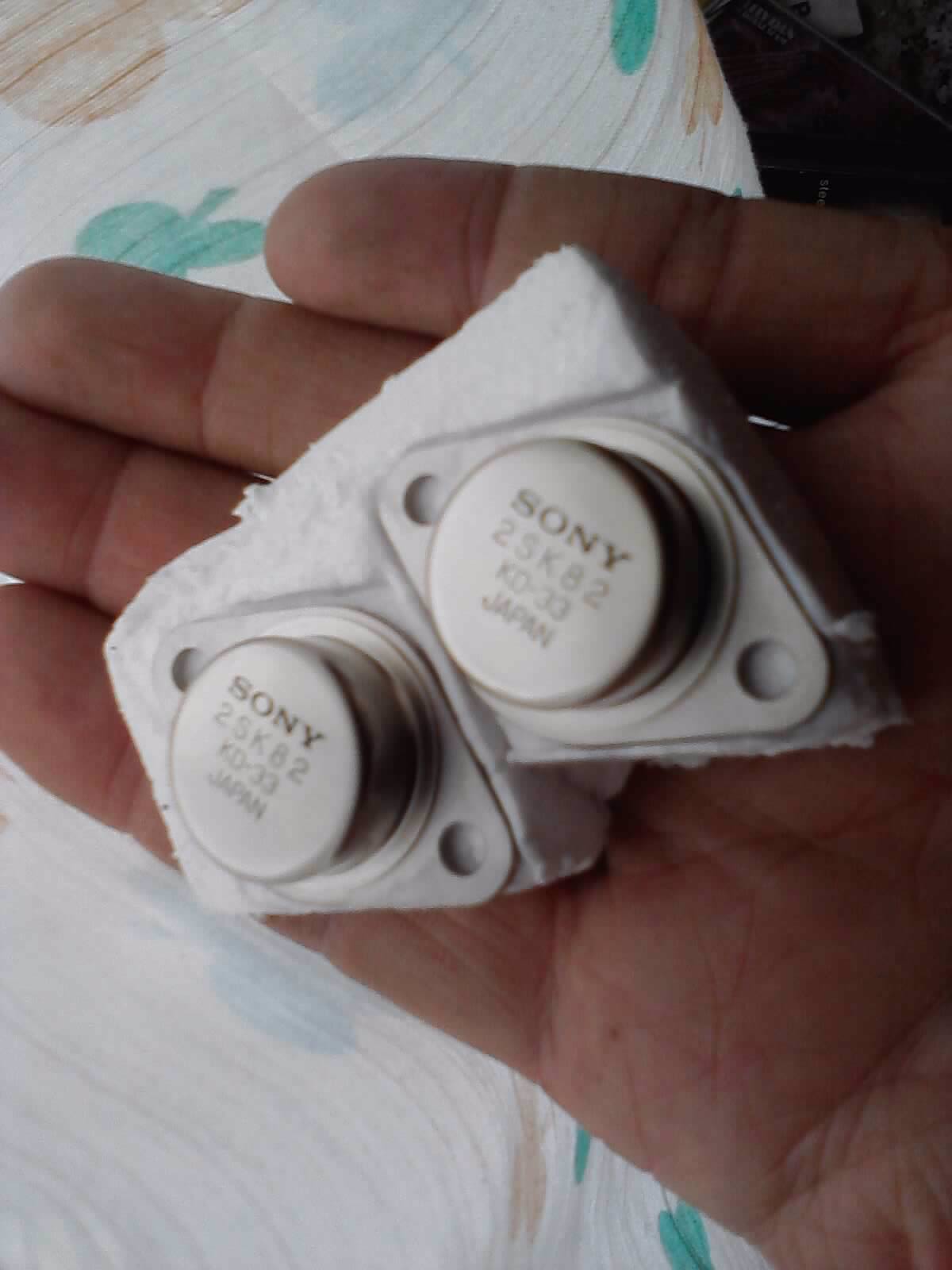

Mine 2SK82 KD33 arrived in the post Yesterday - Hurrah!!
So before I get the rest of the gear, heat sinks, trafoo and such...will be a project in the course of the spring!

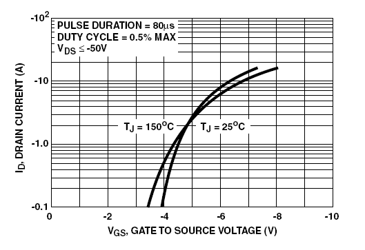

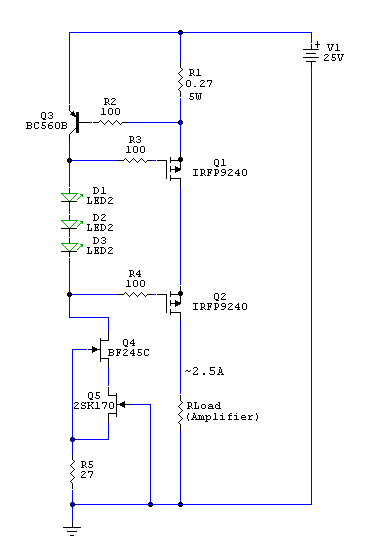

Maybe a cascode Mosfet CCS with JFET cascode current source tail. Should bring very good HF PSRR. IRFP9240 will drop ~5V Vgs each at 2.5-3A region and will be sitting on their 0TC curves cross point. I.e. should be thermally very steady too. Dissipation will be 12.5-15W each. Current control formula is ICCS=VbeQ3/R1. 3 green LEDS ~2Vf can keep Q2 open too for that current region since their combined Vdrop>Vgs.

Thanks! I like that approach. I feel however that there is just too much voltage drop.
Here's the article I have been considering:
http://waltjung.org/PDFs/Sources_101_P2.pdf
The LM338K comes in a matching can to the Sony part and matches the simplicity of original the design quite well. Cannot get much more simpler than that, though who would have thought that low value trimmers aren't readily available (for adjustment targeting the 2-2.5A range)?
For a few extra parts, I'm considering trying Figure 16A, so I'd have the 1.25 V from the regulator plus 2V Vce for the BJT, which is still a good deal less heat than the circuit you propose and it seems to perform rather amazingly (granted, these results are at far lower currents).
Anyways, should be a fun little exercise. What do you think?

Less dissipation is a legitimate goal. I don't trust that much LM3XX chips for SQ though. What is one simple can outside, is a whole bunch of BJTs inside. But its an easy exercise to know if its open enough subjectively when feeding the SIT.
If you drop from ~50V supply to ~25V supply you will need half the previous transformer bulk obviously. Even less with just an LM338K as CCS.
well, more or less than say... a light bulb? 🙂 I think it's worth a shot. Seems to be in the spirit of the project.
Light bulb is just a glowing resistor with its own dissipation bubble. Minimal parts count, no metal sink, saves you turning up the lights to look for LPs.😀
From what I know in tube circuits, LM317 wasn't a nice cathode CCS for phase splitters, we used to go small BJT cascode and it was better. I wouldn't use it solo. Its attractive to drop just ~3.25V instead of ~10V at 2.5-3A assuming Fig. 16A. I am not a fan of TL431 chip either, but for high load impedance and good PSRR is surely an option to check out that combo, maybe it'll prove as good as anything here.
P.S. If you will go power BJTs instead of Mosfets in my example CCS, the drop is going to be 2XVbe only, much less than 2xVgs. One Led will be enough too. Keep that as an option in mind.
