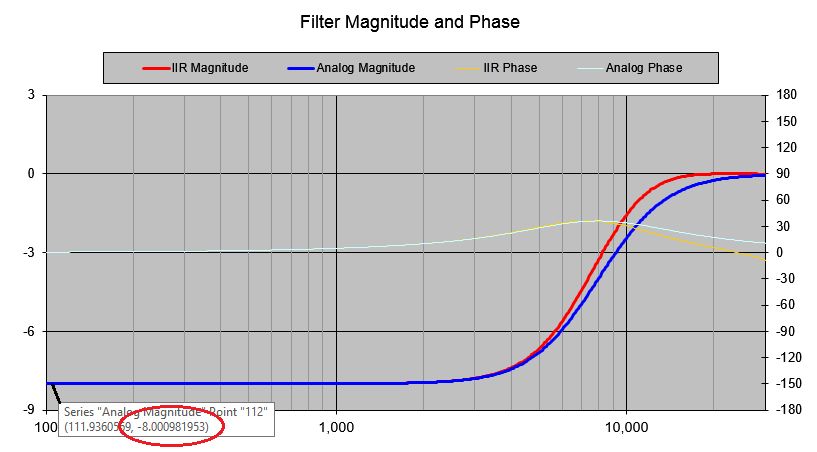

I'm working at the moment with your Ladspa filters library, and I have something strange. When I implement an HighShelf using ecasound... -el:ACDf,25,1,8,10071,0.7,6354,0.7 I get something different from what I get in the ACD excel sheet with the same parameters:
- in the excel sheet the difference between the two levels is 8dB as expected,
- but the plugin execution seems to give me a difference between the two levels nearer from10dB (so 2dB difference).
Could I have made something wrong? Specific data to provide to ease the analysis if relevant?
I'm surprised as the LowShelf -el:ACDf,25,1,0,631,0.5,1585,0.5 provided me better consistency.
best regards,
JMF

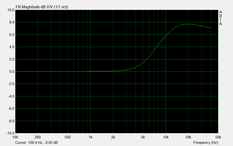

Using my current setup I made some measurements of the ACDf type 25 filter that you mention above, called from ecasound.
The first attachment shows the type 25 shelving filter with Fp=10071, Qp=0.7, Fz=6354, Qz=0.7. I actually get slightly less than the 8dB of gain that this filter should provide but I believe that one of the anti-aliasing filters is already starting to roll off the response up at 20kHz.

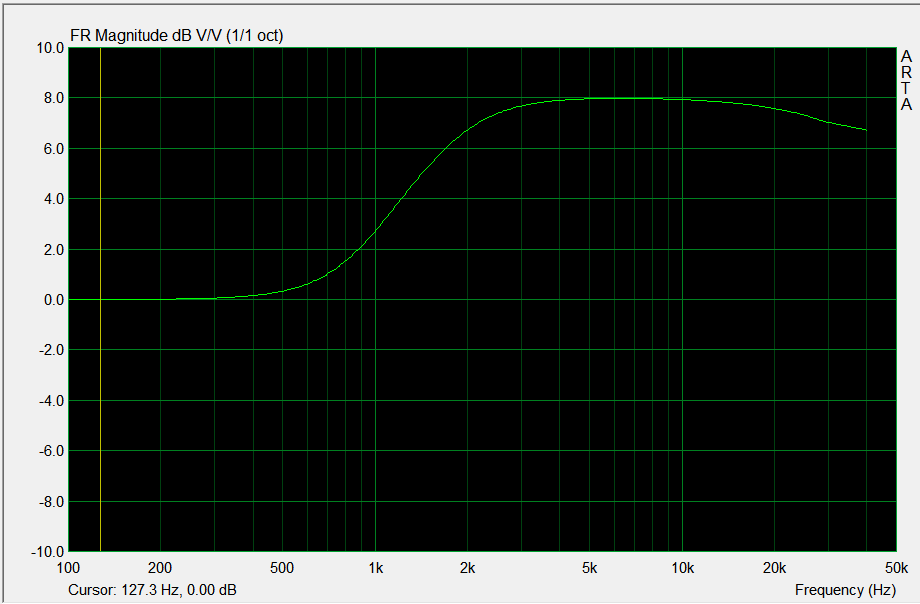

The second attachment is the same amount of boost, but with Fp=1kHz. You can see you get 8dB of boost with this filter - exactly what is expected. You can also see the high end roll off (e.g. about -0.75dB at 20kHz) more clearly in this plot.
I do not know why you would be seeing MORE gain from the filter at high frequencies. I do not observe that behavior on my system.

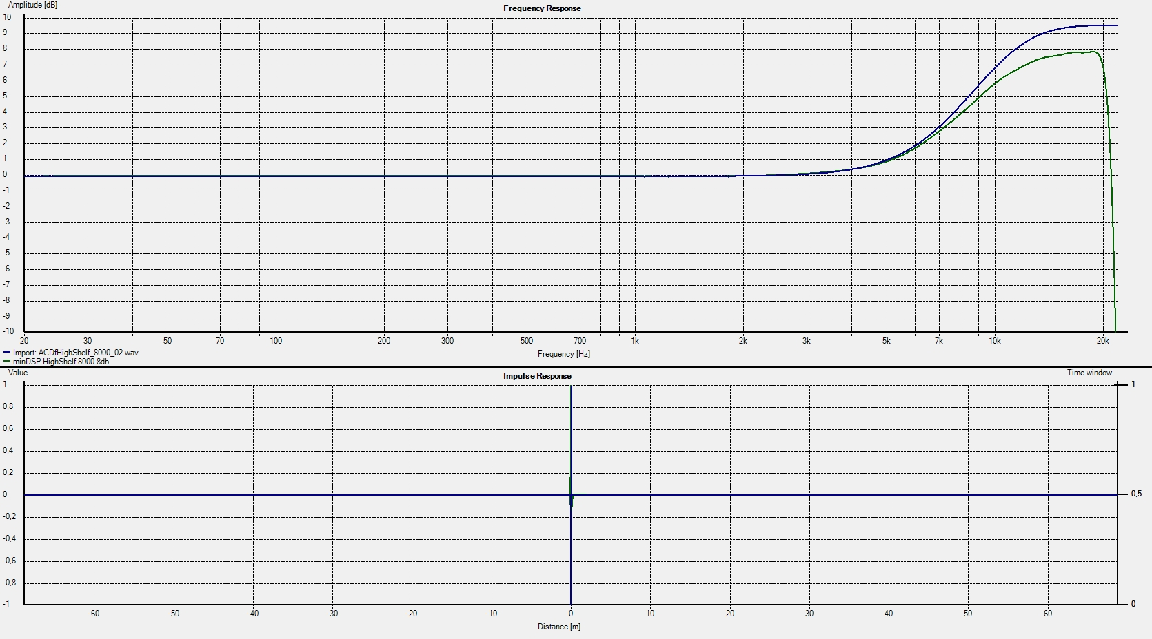

Hello,
Please find attached the response file (Holmimpulse). In thge response, in green, the miniDSP one measured through the soundcard.
The ecp file contains:
tweeter = -eadb:-10 \
The ACD one is in blue and elaborated by sending the ecasound output to a file, and analysing the resulting file directly.

Did you eliminate all the other filters when you generated the ecasound data? You don't even need to use -eadb... just set the input level lower.
Please try a couple of different tests:
1. change the filter Fp and Fq, setting Fp equal to 1kHz and Fz to 1585Hz (equal to 1000*10071/6354). Does the filter give 10dB of boost or 8dB?
2. Just remove the type 25 filter completely and then take a measurement. Does the response rise by 2dB at 20kHz or is it flat?
Honestly I do not see anything like this on my systems, so I am very suspicious of your measurement.
Also, what sample rate are you using for the ecasound processing?

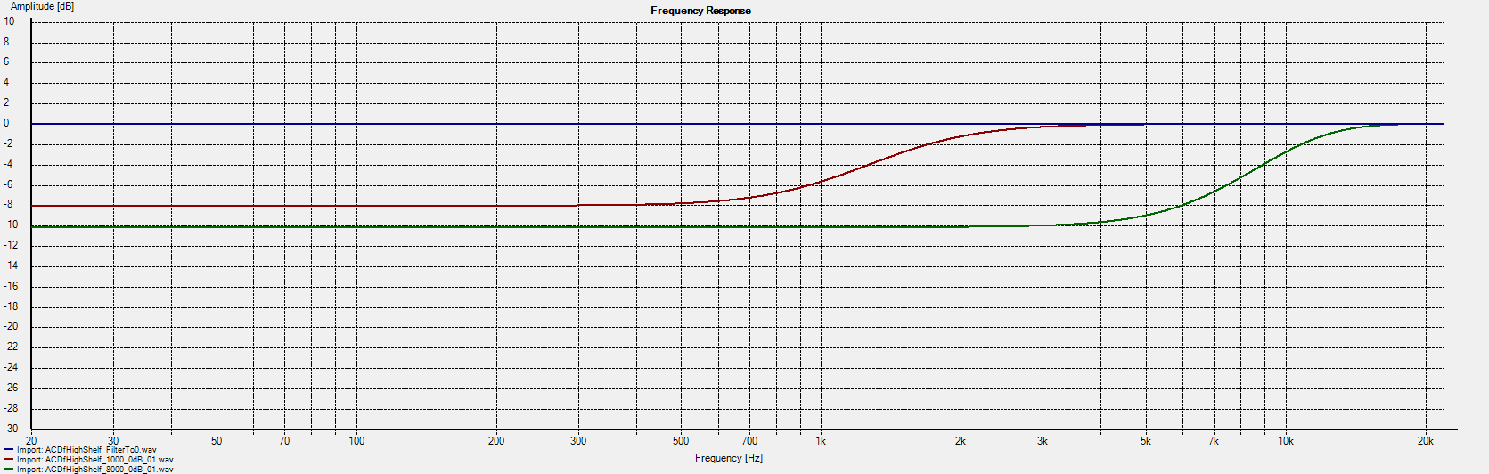

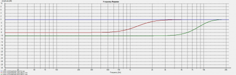

Hello,
Yes, there may be something wrong with my measurement process, which is however simple. All other filters are disabled, in fact I only manipulate files and don't go to anything physical.
I generate different output files from the same measurement file using the command:
ecasound -b:100 -i:MeasurementSignal.wav -pf:ACDfTweak.ecp -o:ACDfHighShelf_1000_0dB_01.wav
The different filters and associated outputs are (I kepdt the dB parameter at 0 to simplify):
tweeter = -el:ACDf,25,1,0,10071,0.7,6354,0.7
=> ACDfHighShelf_8000_0dB_01.wav
tweeter = -el:ACDf,0,1,0,10071,0.7,6354,0.7
=>ACDfHighShelf_FilterTo0.wav
tweeter = -el:ACDf,25,1,0,1585,0.7,1000,0.7
=>ACDfHighShelf_1000_0dB_01.wav
Then I import the resulting files in HolmImpulse, and I get the attached results:
- 8dB boost for the low frequency one,
- straight for the no filter measurement
- 10 dB boost for the higher frequency one :-(
Samplig rate is 44100
JMF

When I compare the plot in your post immediately above (post #390) and the one you posted yesterday (post#385) in this thread, they are slightly different at 20kHz (by 0.5dB). Interesting...
OK, please try one other test:
Move the filter frequencies a bit higher but keeping that same 1.585 times difference in frequency. Does the gain/loss at 20kHz versus DC get even higher?
What MIGHT be happening is that you are running into an effect that happens when a filter has some effect above 5kHz - 10kHz. With an IIR DSP, certain boundary conditions are assumed at Nyquist (0.5* sampling frequency) and DC and sampling frequency. Certain symmetries. The filter shape can be changed as the representation in the z^-1 domain nears the Nyquist frequency. This can cause deviations, but in the past I have only seen these above 5kHz, not for all frequencies like in this case. But it could be the same thing.
For instance I developed a "biquad optimizer" that can be used to eliminate this effect. See the thread here for discussion and examples:
http://www.diyaudio.com/forums/digital-line-level/257313-biquad-optimizer-iir-digital-filters.html
The second plot in the first post of that thread is sort of similar to the filter you are trying to implement.
It could be something else entirely, but let's do some more testing to check...
Edit: another test you can try is to use 96kHz sampling rate with the filter to see if this fixed the problem.

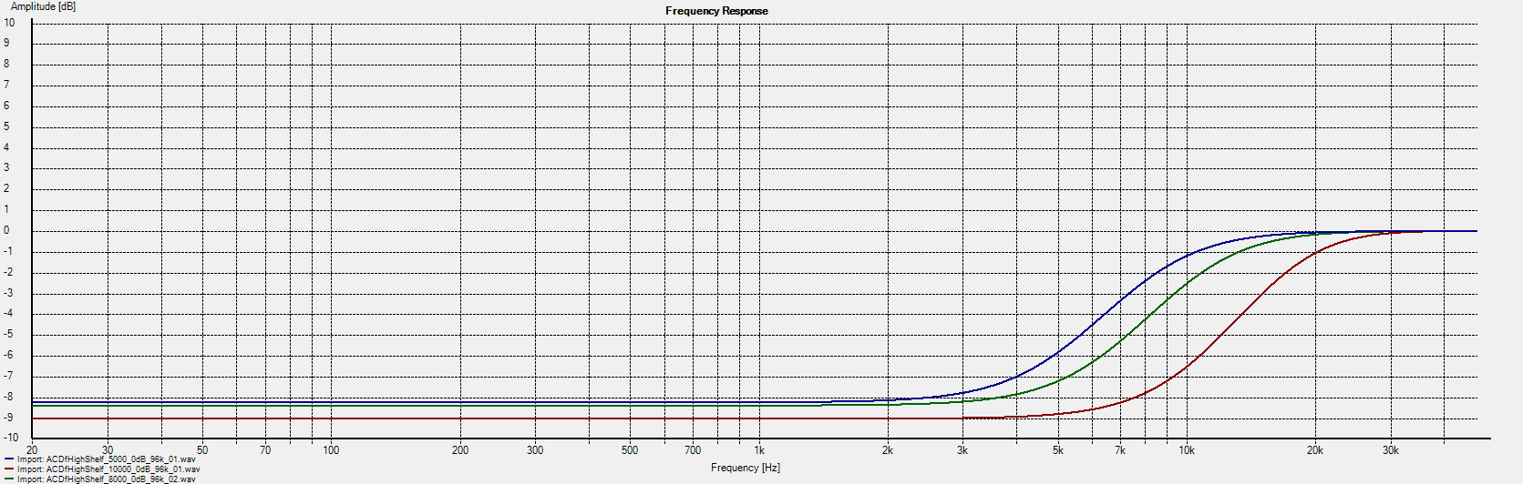

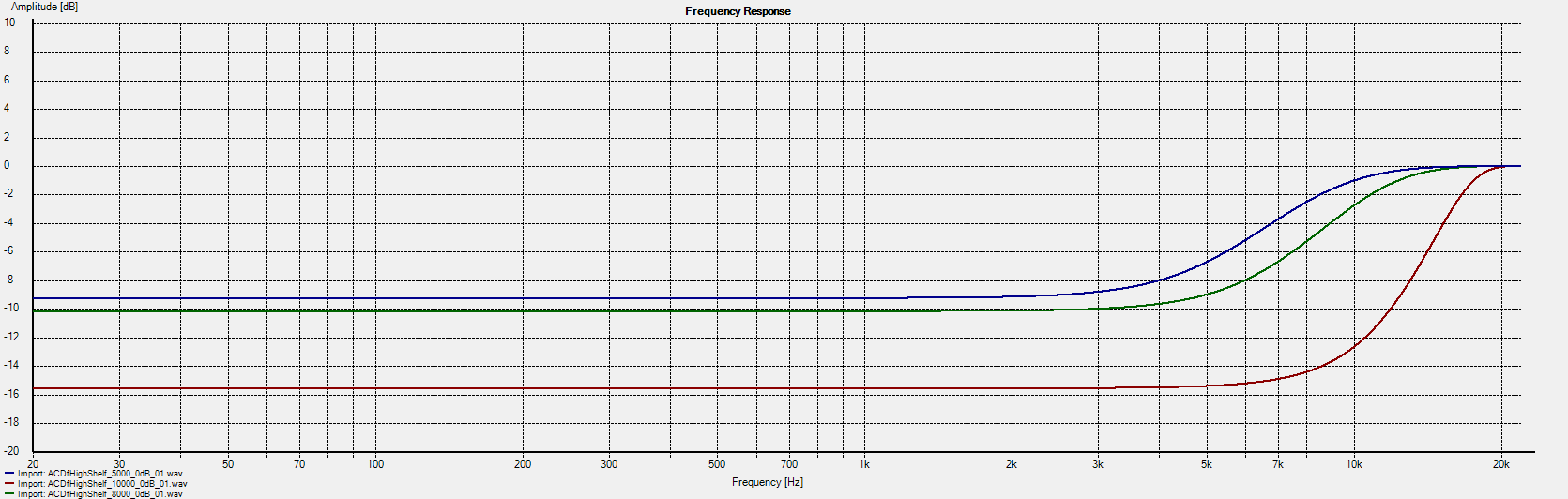

Here are the tests with higher frequencies. The higher the frequency, the bigger the boost.
See attachment.
Filters are generated with:
tweeter = -el:ACDf,25,1,0,7925,0.7,5000,0.7
=>ACDfHighShelf_5000_0dB_01.wav
tweeter = -el:ACDf,25,1,0,15850,0.7,10000,0.7
=>ACDfHighShelf_10000_0dB_01.wav
ecasound -b:100 -i:MeasurementSignal.wav -pf:ACDfTweak.ecp -o:ACDfHighShelf_10000_0dB_01.wav

You are seeing the effects of the bilinear transform and the fact that the filter is approaching the Nyquist frequency. When you change the rate to 96kHz you are farther away from the Nyquist frequency so the effects are smaller.
When I use ACD-L (the LADSPA version) I can see these effects as well. To do that, just set the "stop frequency for driver response" (cell B10 on the DriverInfo and SystemInfo tab) to something like 50kz and you will see frequencies above the Nyquist frequency (half the sampling frequency) as well as the audio band. Make sure to set the sampling rate there as well (cell B11).
I suggest that you simply adjust the frequencies until you get the 8dB change that you desire and then use those modified values when you implement the filter.
Let me know if you run into any other issues or have trouble getting the filter do to what you want.
