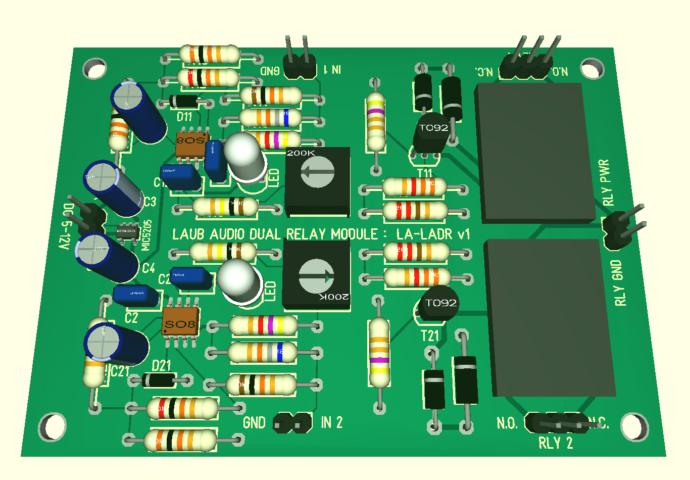

I'm finally revisiting this sub-project now that some other things have settled down a bit. As I explain above, I would like to switch an external line/signal via a relay. Back when I made the above post, the idea was to use a special LADSPA plugin that I wrote that can monitor the audio stream and generate a square wave output that would be sent to the onboard audio output or via a cheap DAC to an external circuit. The circuit consists of an op-amp active rectifier and a gain stage with a few additional components for smoothing the signal. Following the gain stage is a transistor driver for a relay with some coil back EMF suppression. The gain stage has adjustable gain. I realized that this circuit could be used not only for the square wave output that I originally envisioned for the otherwise unused Pi audio out, but it could also be driven by a logic signal if the gain stage gain was reduced to suit.

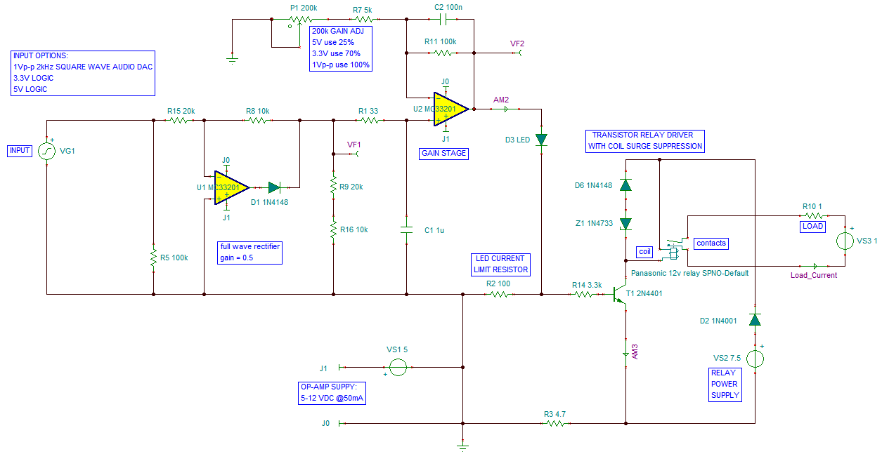

The result is shown in the attachment. The op amps are single supply SOT package dual types that cost about 75 cents each in quantities of 10 at Mouser. I happen to have a gross or two of some 12V relays that I want to use, so I will probably design a PCB for them.
One interesting use for this circuit is with the Abletec power supplies that are currently available from various sellers. These include a 7.5V aux supply and that happens to be enough to drive the 12V relays that I have lying around. The relay contacts can be connected to the standby pin on the Abletec supplies so that the circuit can be used to control the HV rails (turn them on and off). The idea is that the Pi, which is always running, would sense audio via my LADSPA plugin, send the square wave signal or toggle a GPIO pin, and then turn on the HV rails (and therefore the amplifiers). Its a great remote on/off solution. When signal is received by the board switching occurs in 10msec to 50msec depending on the gain and the on/off threshold.
You may ask why I would bother to make such a circuit when there are lots of relay board floating around on Ebay and so on. It turns out that these are typically 5V logic driven (the Pi GPIO pins are 3.3V for instance) and have "backwards" logic in that the pin must go lo to trigger the relay. This means when you apply power the relay actually triggers until you can apply a logic HI signal to turn it off. I would rather that my relays just sit there doing nothing while everything powers up and initializes and then I can apply a signal to turn it on. Also, when power is removed, the relay may do some odd things depending on which supply decays first. My approach would allow the relay to behavior to be a little more forgiving.
Another feature of the design is that the power supply for the op-amps and transistor are separate from the power that is used to drive the relay coil. This would mean that other relays with different coil voltages could be easily substituted if/when desired. For instance USB power could be used for the op-amps (yes it works on 5V single supply) while 12V or 24V are used for the relay PS. The op-amp side current requirements are low, so they could be driven from the 5V available on board (of the Pi for example) while the relay needs more current than the Pi should be asked to give, so a separate supply can be used for that. Again, the Abletec PS has a 7.5V aux supply that would be perfect for a high sensitivity 12V coil relay or two.
I like the flexibility of being able to interface with various input signals. The circuit could be used with a computer that doesn't have GPIO type pins available. For instance I own a couple of small Baytrail mini-ITX form-factor mother boards. I can use a cheap USB PCM2704 based DAC ($10 on Ebay!) and this circuit to add a relay interface that I can control from LADSPA to sense the presence of audio and perform an action.
I welcome your input and any feedback if you feel something can be improved, etc. Thanks.

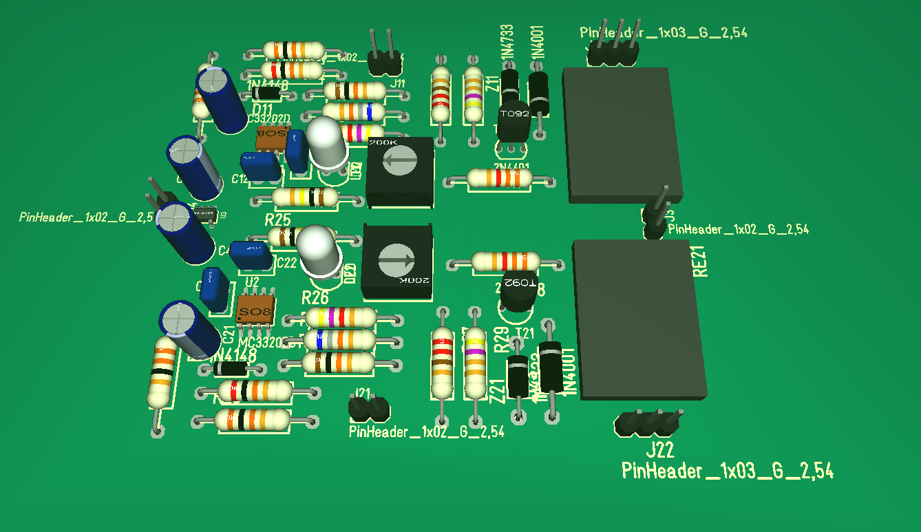

I have a nascent layout done. No routing yet, but I can see by the ratsnest that it won't be too bad. I used mostly thru-hole parts, except some active components that are only available in SMD packages.
I added an LDO regulator to the op-amp power supply. The purpose of this is as a limiter for the output of the gain stage (second amplifier). Even if you over drive the circuit, the ultimate voltage output is limited to the rail voltage, which is set by the LDO. This makes the circuit more tolerant to user error, and leaves only the gain adjustment for the user to make, which is very simple to do.
Exciting 3D pic of layout is attached.

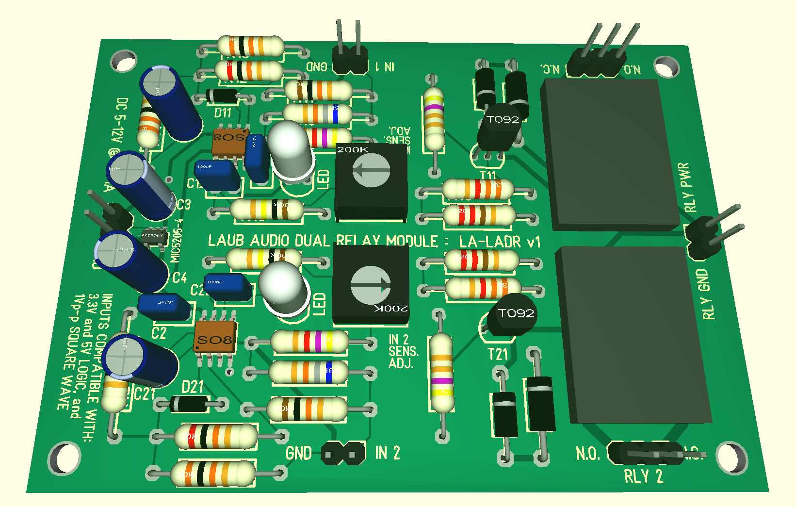

I've managed to route the board. There are two independent relay circuits, since that seemed more practical. A number of inexpensive 1 Form C (SPDT) relays can be used including the cheap SONGLE SRD-12VDC-SL-C. I already have several uses in mind for this...
The 3D view is shown in the attachment.
All done. I submitted an order for 20 boards to my usual supplier. I think this is going to be a great addition to my toolbox, and I can finally make use of some of those relays that I have horded!

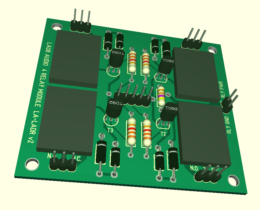

Below is a 3D model view of the final (version 1) board, populated. The relays are not as tall as they actually are in real life (they are about as tall as they are wide, 12mm or so) but you get the idea.

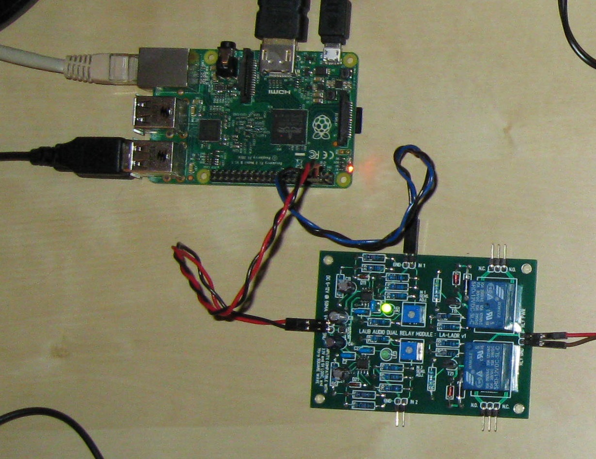

I finished assembling a relay board a couple of days ago and finally got around to testing it today.
The board is paired with a Raspberry Pi with the control circuit powered from the Pi's header: 5V (pin 4) and GND (pins 6). I connected the control input from GPIO 17 (pin 11) and GND (pin 9). A separate 12V DC wall wart is also connected to drive the relay coil(s). You can find a layout of all the header pins from the Raspberry Pi here:
http://data.designspark.info/uploads/images/53bc258dc6c0425cb44870b50ab30621
To toggle the GPIO pin I used the WiringPi library. I found that a simple bash shell script is included with the library that switches GPIO 17 from high to low every 500 msec. This used for the "hello world" script of the Wiring Pi library in which you connect an LED and a current limiting resistor and blink it. I just used this to switch the relay control input on and off.
After adjusting the gain, I found that it works like a charm. In the picture you can see the green LED of one of the channels lit up. You can't see it, but the relay dutifully engaged and disengaged with a click. I felt like I had just made a great automobile turn signal!
Since I can interface this with my LADSPA plugins, I can now control the relay any way I want, specifically based on the presence or absence of an audio signal, to provide turn-on and delay-off behavior for the amplifier power supply. I could also program other behavior - for instance delay-on, zero-delay-off would be useful as a soft-start or for waiting a few seconds after power-up before connecting the amp to the speakers.
Next step is to test with a square-wave control input. I have a suspicion that I may need to increase drive current to the transistor, but so far I'm very happy with the result!

More testing...
I needed a quick way to output a square wave signal on the Pi's headphone jack. I found that I could generate a wav file on audiocheck.net that I could download. Using the VLC player I could send this to the headphone out. I had to first reconfigure the audio output of the Pi to be sent to the TRRS jack instead of to HDMI using raspi-config. I confirmed that the file playback indeed produced audio in my headphones, disconnected the headphones, and connected the output of the TRRS jack to the relay board control input.
Nothing.
Didn't work!
Hmmmm...
I shut the Pi down for the night, thinking that I should sleep on it and debug in the morning. Then I realized that I hadn't checked the gain level in ALSA... I powered the R-Pi back on and, sure enough, when I checked the level using alsamixer it was set to 40%. I raised the level to 100% and reconnected everything. When I fired up VLC and played the file...
SUCCESS! 😀
I had to make an adjustment of the gain to about the max, but this was expected.
I did have one observation - I think that the op-amp I am using has pretty bad rail-sticking behavior on the output. The op-amp itself is rail-to-rail (within about 20-50mV) capable, and with the gain turned up I am driving the output into full saturation at the rail voltage. When the control input signals that the relay should turn off, there is a small delay of about 500msec during which time the series LED fades and the relay finally releases as the LED goes out. This seems like rail sticking to me. When I back off the gain so that the relay is just engaging when the control input goes active, the relay and LED turn off pretty much instantaneously (judging by eye). Since the delay isn't all that long and shouldn't impact the typical usage I'm not worried about it.
