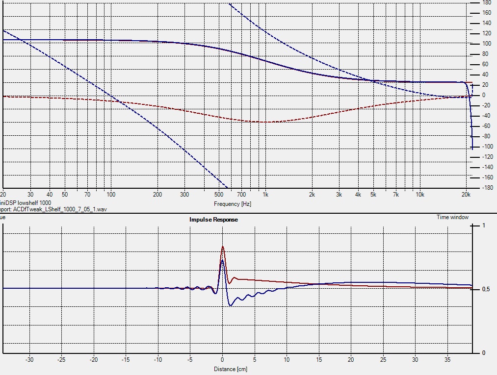

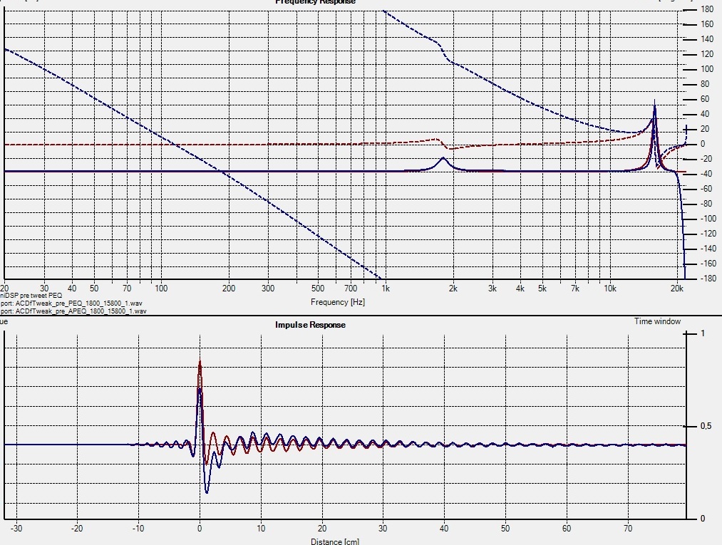

I have played with LADSPA plugins during all the week-end. My purpose is to implement active filters initially designed fort miniDSP in software DAS on a Linux machine (TBD).
Thanks Charlie's tools and tutorials from Richard Taylor, I succeeded to do mimic miniDSP initial filters in LADSPA as of frequency response. Tweaking some frequencies for shelf filters (thanks Charlie for your help) and Q factors for PEQ is needed, but with some trials and errors this can be easily solved.
I was happy untill I looked at the phase response. They don't look the same even for very basic filters. My very basic understanding of filters and DSP does not allow me to go forward. Help welcomed. I attach some examples.
The measurements are done with HomImpulse.
In blue, the mini DSP, the loop physically goes from soundcard output => miniDSP => soundcard line input.
In red, the ACDf / LADSPA filters: The HomImpluse measurement signal is fed to ecasound/LADSPA filters => output file. Then the measurement signal file and resulting file are imported in HolmImpulse, and compared to the miniDSP. The Db offset is compensated manually.

What I see in red looks correct to me.
In the first (left) plot, you have two PEQ bands. The phase response for a PEQ is exactly what is shown in red. For the miniDSP measurements you have additional phase rotation. I'm not sure where this is coming from - it doesn't look like frequency-independent delay to me, since that would increase in slope with frequency. I don't want to say that something is "wrong", but that really should not be there. The LADSPA filter phase, and frequency response, is correct.
In the second plot the phase again looks correct for the LADSPA filters. But I see something else in the miniDSP and LADSPA impulse responses. They have a component at low frequency that is about the same in magnitude, but of opposite polarity. I can make out the following:

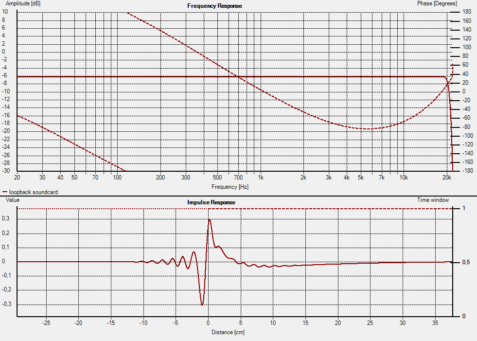

Keep in mind that you took measurements through and ACD and a DAC for the miniDSP system, while neither an ACD or a DAC are in the signal path for the LADSPA measurement. These additional signal processing operations (A to D and D to A) can have their own filters, e.g. anti-aliasing filters, ultrasonic LP and infrasonic HP.
You might measure both systems when they are set "flat", that is no user filters in the chain.
- The miniDSP system seems to have pre- and post- ringing. This might be due to some FIR component to the system (as part of the input filters for instance).
- The largest spike in both the LADSPA and miniDSP impulses seems to be about the same in magnitude and the responses look the same.
- There is a lower frequency component that produces the slowly dying tails of each impulse. This might be the DC-blocking highpass filter response. For the LADSPA impulse this initially rises up and then decays away, and the response looks critically damped (Q=0.5). For the miniDSP impulse it does the opposite - it initially falls and then slowly rises (the decay is rising back to "zero") and because it crosses "zero" and then falls back it is probably Q=0.707.

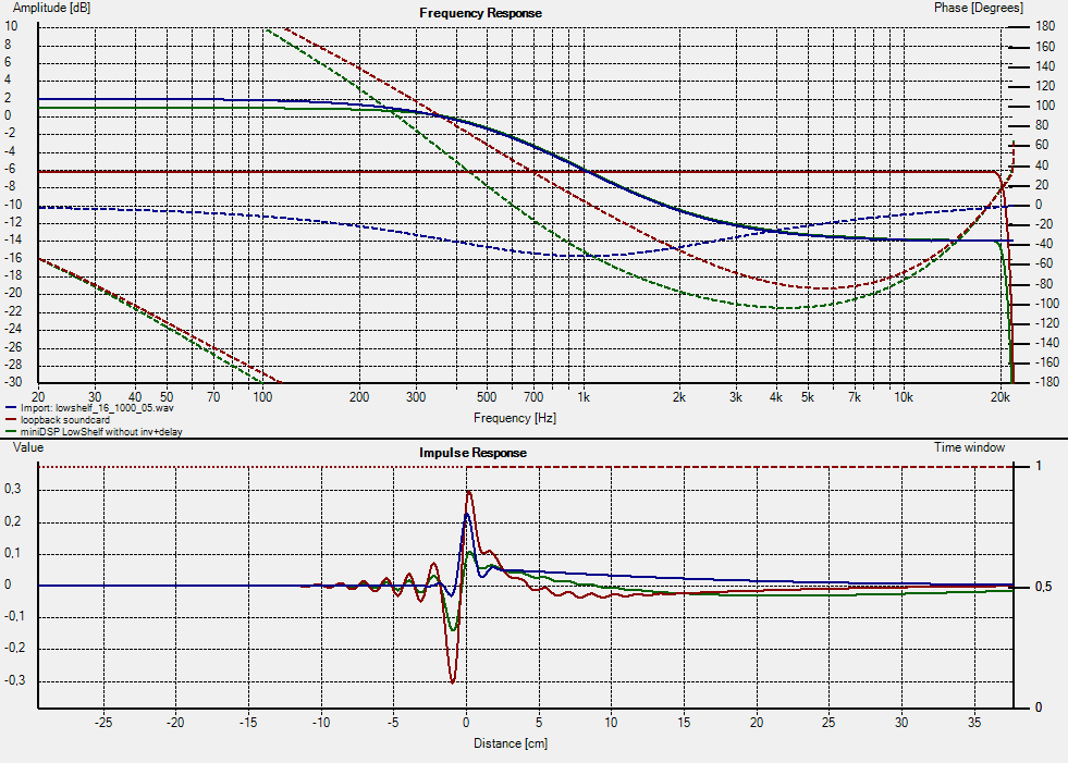

Well, what would be the result with minidsp applying a dummy filter, or no filter at all? 🙄
I don't remember how close to a dirac looked the last loopback measurement i made with whatever soundcard i owned... Pre and post response, always some as far as i remember...😱
Btw, the phase response in blue looks like a bandpass 20-20000hz inverting filter, "centered" hence shifting around 1Khz, . Removing the inversion would remove the phase shift. In the red curve there is no such inversion, nor bandpass effect added to the correction.
I did some comparisons in REW a while ago comparing a LADSPA LR lowpass filter with the built in DSP lowpass in a Crown XLS2000 amp. I think it was a 4th order. The results were more or less identical.

Charlie,
I'm working at the moment with your Ladspa filters library, and I have something strange. When I implement an HighShelf using ecasound... -el:ACDf,25,1,8,10071,0.7,6354,0.7 I get something different from what I get in the ACD excel sheet with the same parameters:
- in the excel sheet the difference between the two levels is 8dB as expected,
- but the plugin execution seems to give me a difference between the two levels nearer from10dB (so 2dB difference).
Could I have made something wrong? Specific data to provide to ease the analysis if relevant?
I'm surprised as the LowShelf -el:ACDf,25,1,0,631,0.5,1585,0.5 provided me better consistency.
best regards,
JMF
best regards,
JMF
Can you turn off all other filters and just run this filter, and then provide (upload) a plot of the measurements showing 10dB difference? In the mean time I will check the code and think of why this might happen.Charlie,
best regards,
JMF
Also, what sample rate are you using?
