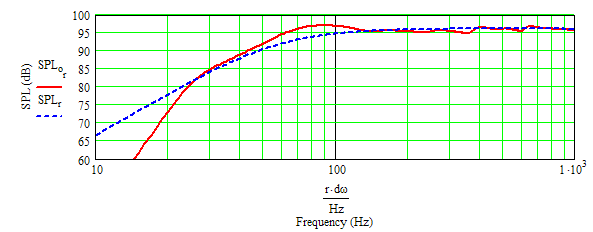

Hey just a thought. Thinking of room gain, is it safe to say these might sound okay against a wall.
Perhaps might make a good home cinema monitor, three across the front and 4 around the room for surround?
I'm pretty sure either Chris or Dave mention that earlier but I can find it. (Apologies if i'm wrong on that chaps)
James, you bet. These have potential. Definite commercial killers. The effortless sound is very important to making it sound realistic.
I think pushed up against the wall would be great. Dave also mentioned that when I was there. I would think the sub-200hz stuff would be reinforced while everything above would be forced forward because of the large baffle.
As JRKO's are tuned the sim shows a response that starts gently rolling off below 100 Hz at a 4-5 dB/octave rate, before turning the corner ar about 35 Hz and an F10 of just over 30. In a room like JRKO's and up close to a wall that likely means response flat to 35-40 Hz and responce well into the 20s.
