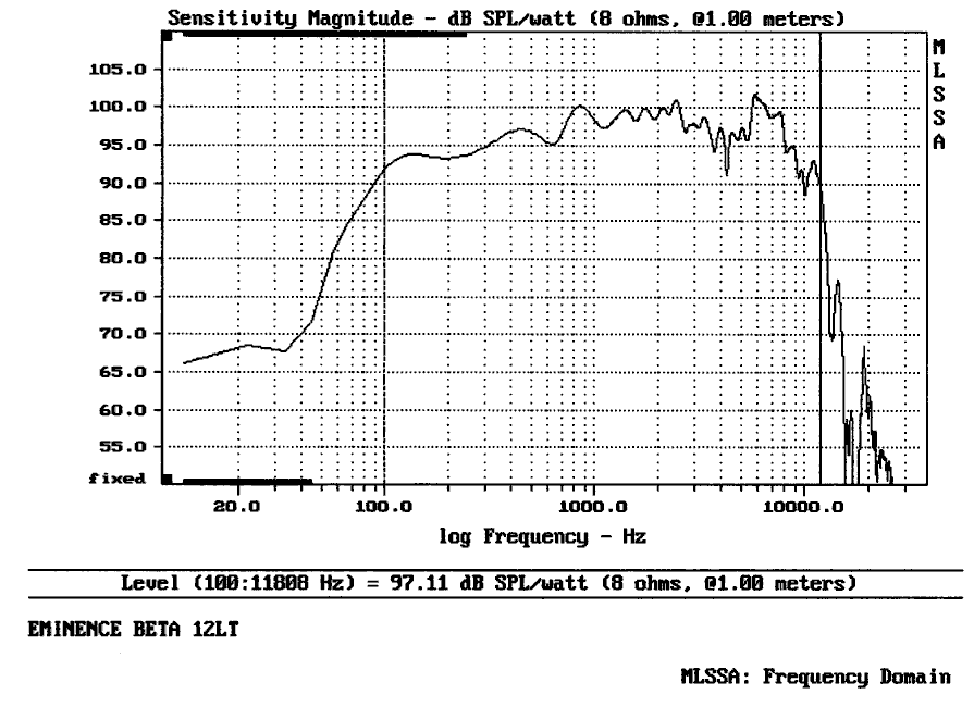

When you nix the dustcap and add phase plug the 12lta frequency response changes. The peak around 7k smoothes out. If we are critically blending a tweeter to a tweaked driver we need to consider this.

Here are some measurements by member db6546 who kindly posted them on Zilla's previous 12LTA thread to add to the 7k crossover point: http://www.diyaudio.com/forums/full-range/179161-beta-12lta-3cf-box-port-size-2.html#post2429767
They show standard, dustcapectomy, phase plugged and slow removal of the whizzer. Phase plugging does seem to raise the response considerably
For the record, I did not do those measurements but was happy to see them. I'm glad the measured frequency response of the 12lta correlates closely to other measurements.

I see some inconsistency below 1K that I attribute to my difficulty in deciding where to put the cut off point before the first reflection (snip)
Thanks for pointing out those measurements JRKO. The user made the comment I've quoted above. It looks like the gate is a little to low on a couple of those measurements, so you'll have to be careful when reading them. The waviness on a couple of them is a reflection that's contaminating the results.
Either way, I agree that it looks like the phase plug really cleaned up the top end.
Surprising to me, as I hear a lot of people claim phase plugs do nothing and are for off axis reasons only. Even then many claim they don't help and often hinder. This is an interesting example showing it really does make a difference.

Phase plug present & correct here for about a year now and wouldn't go back. As you noted the measurements that db6546 are a bit rough and I think ChrisB pointed to the 4k dropout in the standard driver (still present on the phase plugged version to a lesser degree). I've applied a smidgen at 4k on the iTunes built EQ and its brought the Emken to life. The overall dry & accurate sound I noted before has changed to a 'more lifelike' & accurate sound.
db6456 measurements also show a drop between 6k & 7k and I wondered if that could be smoothed to let my FT17H come in a bit higher? Mainly because I can only apply EQ to my 1x digital source and not my 2x analogue sources

Ok I see. The 3rd graph down is what you have, and that measurement looks very valid and relflection "free". The 4.5khz suckout is very high Q and I'm surprised it's audible to you. Chances are the additional 4khz eq you applied is broad band and just sounds better to you, but not because it corrected the dip.
Beyond 7khz could probably be boosted, but the driver is also beaming like crazy there. Give it a try. Beyond 10khz is hopeless, no eq will fix that drop. It's gone.
If anything, I'd try a broad low q notch around 1500 to 2500hz. There's a bit of a hump there, that if it came off might sound better. This might be related to the 4khz eq you applied. Adding output at 4khz may have smoothed the transition from the bump. Try putting the 4khz back to flat and taking 2 or 3db off of 2khz. See what that does. I may sound like you lost some effeciency, so beware of that and give time to adjust.
