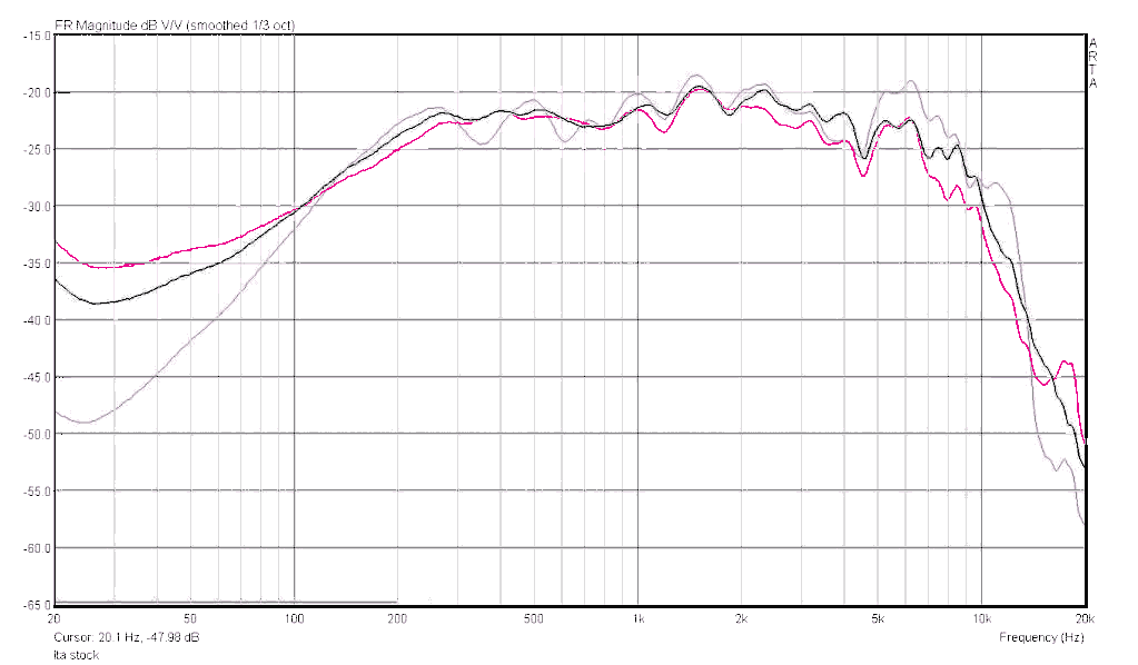

now it's time for me to blow some smoke - as little faith as I may place in simple on axis FR measures to be reliable predictors of what you'll hear in the real world, (and this one is a real roller coaster ride) I'd imagine the almost 6dB trough, almost a full octave wide ( approx 3000 to 6000), and right at the top end of a critical "telephone" bandwidth would have more effect than the smaller couple at approx 1200 and 1800.From my understanding 'high q' means the short freq range the 4k drop falls and rises over, instead of a broad slow decay. Is that correct?

Are we looking at the same FR plot Chris? Third down in JRKO's link. With the phase plug the dip/peak 4khz/6khz combo is really smoothed out. Take out the hill top from 1000hz to 3000hz and it would make it even smoother.

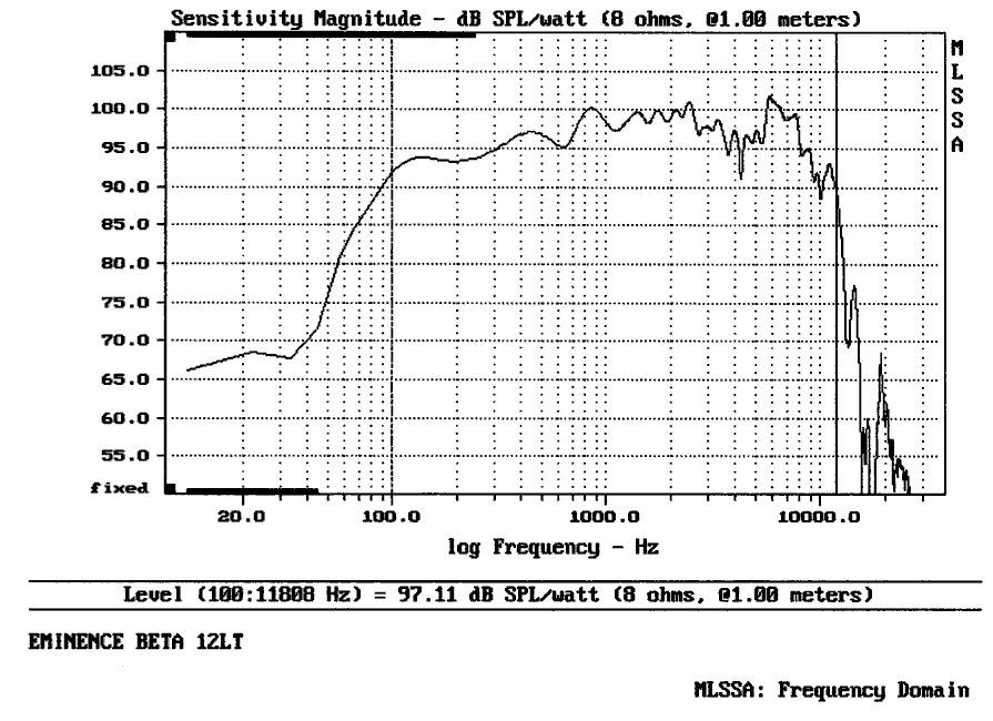

Apparently not, I'm looking at both Eminence's graph for bone stock:
http://www.eminence.com/pdf/Beta_12LTA.pdf
and another measure posted a few pages back on this thread;
and the first 3 of series of db6546's posted ARTA measures that more or less followed our own sessions so far (i.e. from bone stock to dustcap-ectomy to rudimentary but dissimilar phase plug), none of which I see as completely mitigating the notch in question

Thanks for that one Dave. Really shows the differences those mods make.
The plug really smoothes out a lot of the raggedness. I wonder what differences a coat of something and enABL treatment will make, not only to the sound but also to the graph.

I think some people miss out on this aspect of measurements (I'm looking at you Chris 😉 ). When you know something is wrong, the measurements can sometimes tell you what it is. More often than not, things improve when the measurements improve. They lead the way, as you say. And for multi-way, they're almost indispensable trying to dial in a cross over, unless the drivers are exceptionally well behaved.
