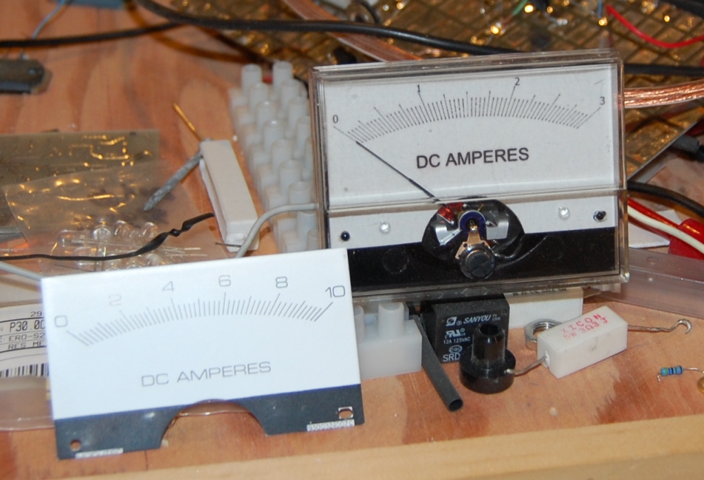

Spent some time last night re-drawing the scale for the ammeters. This is a very frustrating job and took quite a while. The results are rough but acceptable:
These meters had an internal 10A shunt and the scale went to 10A. This is too high for my supply and I decided to resize it. I removed the internal shunt and installed an external one (short piece of steel wire) with a 100 ohm trimpot in parallel with it. The wiper of the trimpot feeds one lead of the meter coil, giving me enough adjustment. These will now be 3A meters and I just finished calibrating the first one.
Thanks! No plans to light them up. Should be easy enough to see on their own.

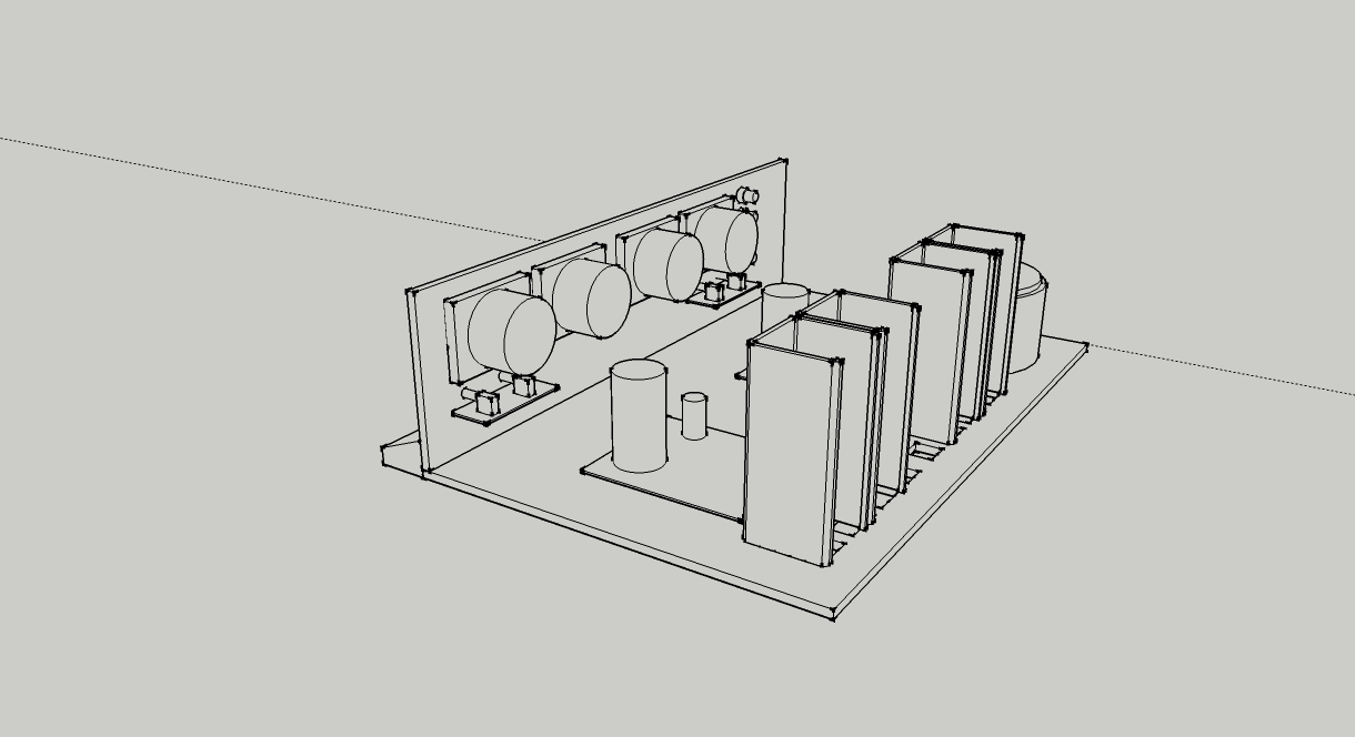

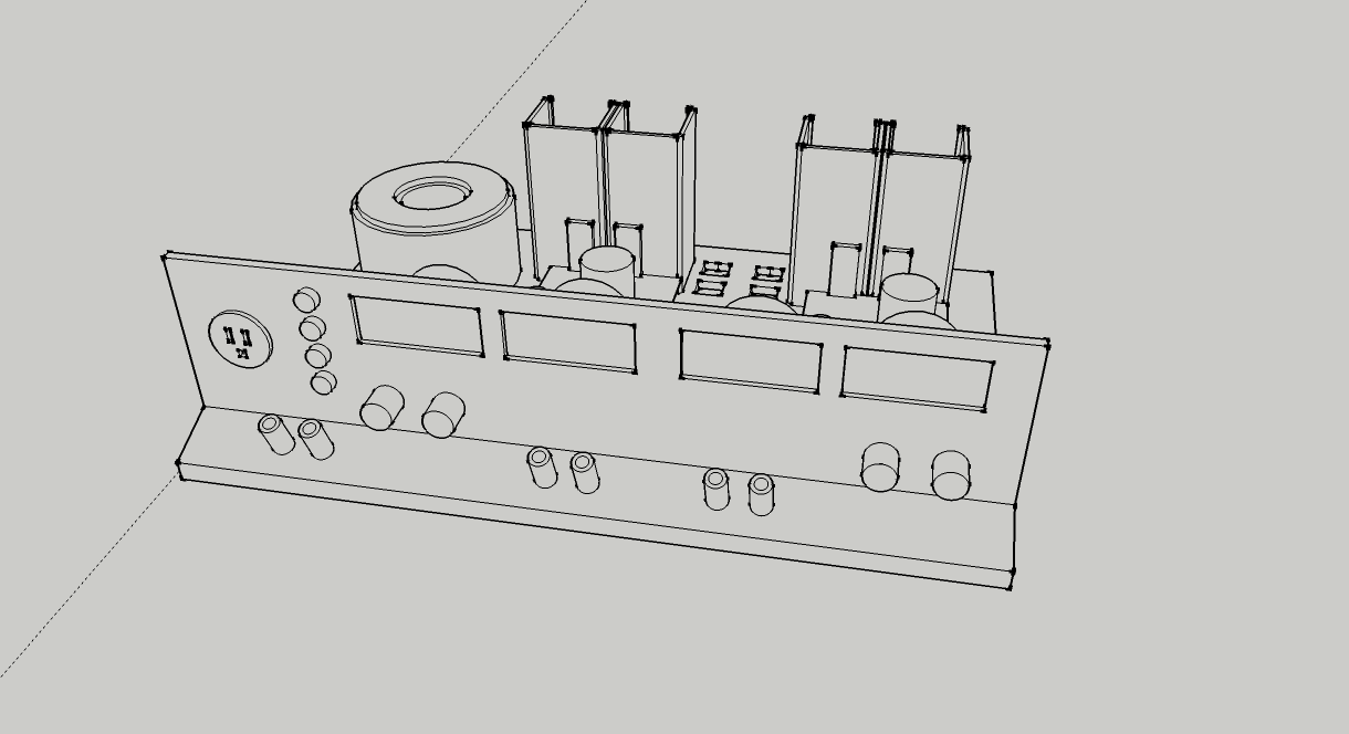

Doing some planning on the enclosure, trying to make the unit ergonomic. One of the problems with my old supply (shown in post #1) is the binding posts location. It is easy enough to attach a banana but to clamp a bare wire is difficult. In this new one, I want the posts easily accessible and to that end, I will mount them on a sloped "cow catcher" on the bottom of the front panel:
Gotta love Sketch up 🙂
The meters run across the top with the voltage and current control knob beneath. On the left is the dummy load posts and selector switches. Next to that is the current limited (via a light bulb) receptacle.
From the back:
Overall size is approximately 20" wide, 5" high and 12" deep. The first step is to build the front panel and physically lay everything out to see how big the case actually needs to be.
The majority of the case will be made from 1/4" hardboard. Some solid pine and some 1/2" BB ply as well.

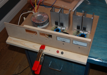

The mock-up:
Not far off the Sketchup model. Looks like everything will fit ok.
I stuck a pair of garbage binding posts in there for illustration only.
There are some things I need to finish this:

good work, so combo posts then? nice idea on the 'cow catcher tm' I would normally recommend posts from my mates at eichmann just up the road for audio purposes, but probably overkill here, although the minimal amount of metal in the signal path would be a good thing all the same, too pricey though for here.
yeah sketchup works a treat, wish I had some woodworking skills, I have to pay dearly for anything I ever want made, at least I can do the cad or solidworks stuff, but I have nothing by way of tooling really, well not past a drillpress and dremel. i'm all thumbs when it comes to wood though.

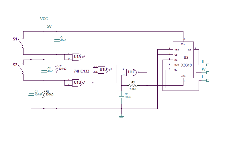

so single turn pots are enough for fine adjustment you think? I would personally go for more as single turn at 5-10% tolerance isnt going to give you very precise adjustment IMO.

Maybe digital pots for the voltage control is the way to go. 100 taps for fine adjustment plus the ability to link and unlink each channels adjustment (voltage would go up or down on both together when linked). A suitable candidate would be Intersil X9319. It can be manually configured easily and will handle the voltage (<10VDC) from the LM317.
Instead of a knob, 2 momentary switches to control the voltage.
I actually have 2 pairs of Eichmann Cable Pods but I think I'll save those for something else. 🙂
The more I think about the digital pot method, the more I like it. It is also an opportunity to mess around with one - a new experience.
The circuit I'll use:
Simple enough and fairly cheap. The X9319 is less than $5 and the NAND Schmitt trigger is 75 cents. Economical enough.

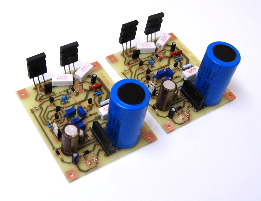

Ok, when was the last time you were running something that required 2A @ 5VDC? I never have and most likely never will..
My wireless access point draws 2.5A at 5V DC and has so far destroyed the original and a replacement PSU. Loft conditions do not help for sure (very hot in summer). Has been running last two years on a custom made PSU I built explicitly for that WAP. It is like a half-brick in size.

My wireless access point draws 2.5A at 5V DC .
Sounds like a job for the LM323 - 3A, 5V regulator. I have 1, the steel version that I got for nothing (Digikey retail is ~$35.00!) that I haven't found a use for yet.
My supply, as it is now with 2 pass transistors wouldn't have a problem with that load. Of couse, for long term operation (as opposed to short term testing), a dedicated supply at the required power would be best.

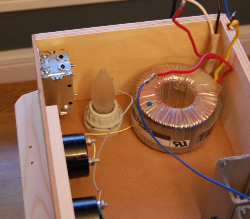

Finished the internal wiring in the case. I mounted the toroid on the side, rather than the bottom.This gives a bit more free space for the dummy load setup. I still need to figure out what I'll use for the resistors (nichrome or cement resistors)
The case needs side panels and a top panel that I haven't made yet. I also want to get the whole thing painted before final assembly.

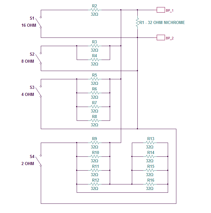

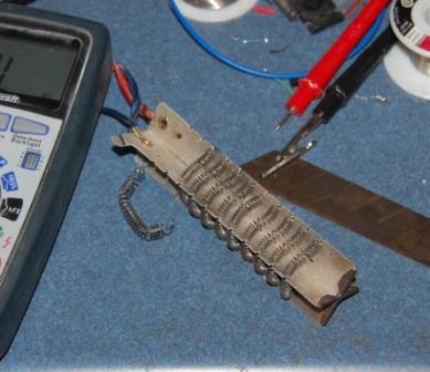

I looked at the nichrome:
I measured it and have enough to do the initial 32 ohms (attached between the binding posts) and the rest will be cement resistors:
Easy enough, just need to account for the heat produced. Should be very handy in practice.

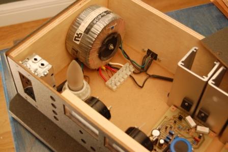

A smidge more progress. Case is ~finished and I gave it a coating of textured paint (in a spray can):
Not a great pic but the paint does make it look neat and tidy.
A look at the inside:
Wiring to the light bulb limiter and receptacle is done (except an inline fuse that is on order) and the transformer is wired.
Now that the case is painted, I can install the supplies and wire those to the transformer.
I have changed my mind on the dummy load. I will use cement resistors only and keep the nichrome for something else. It will take a gaggle of 10 watt resistors to make up the power and impedances I want, all clamped to a suitable heatsink.
Also, a lot of powered USB hubs will use a 5V supply. Quality ones will alot 500mA to 1A per port. I have several 6 ports that have 3.5A supplies.
the point that was being made by Andrew was that at 5V output the pass transistor will have to drop maybe 27 or more volts across collector and emitter, and at 5 Amps this would be 135 Watts, at 3 Amps it will be 81 Watts. That is a lot of heat to dissipate. The way I understand it even witha sizeable heatsink, eg http://uk.farnell.com/abl-heatsinks/345ab1000b/heat-sink-1-c-w/dp/150016 (this brick is 1C/W), you'd be looking at boiling egg temperatures. Certainly I have used similar on my LM3886 amps and they get very hot without a fan blowing straight at them.
