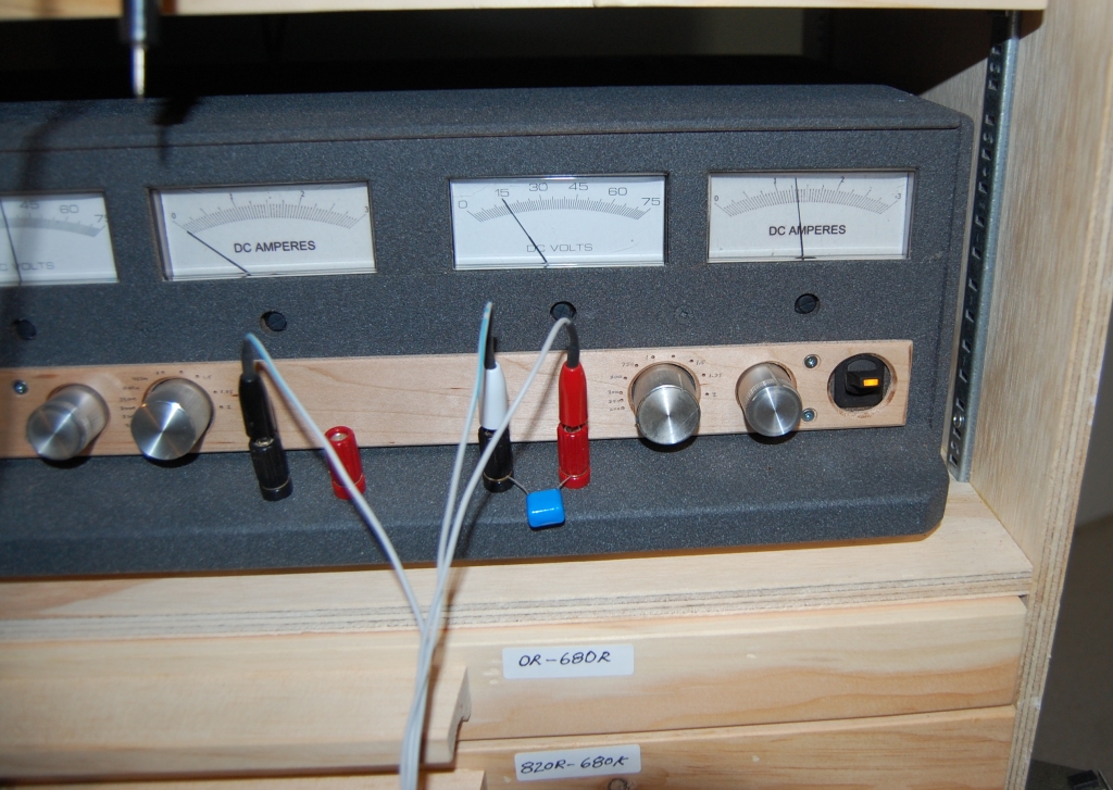

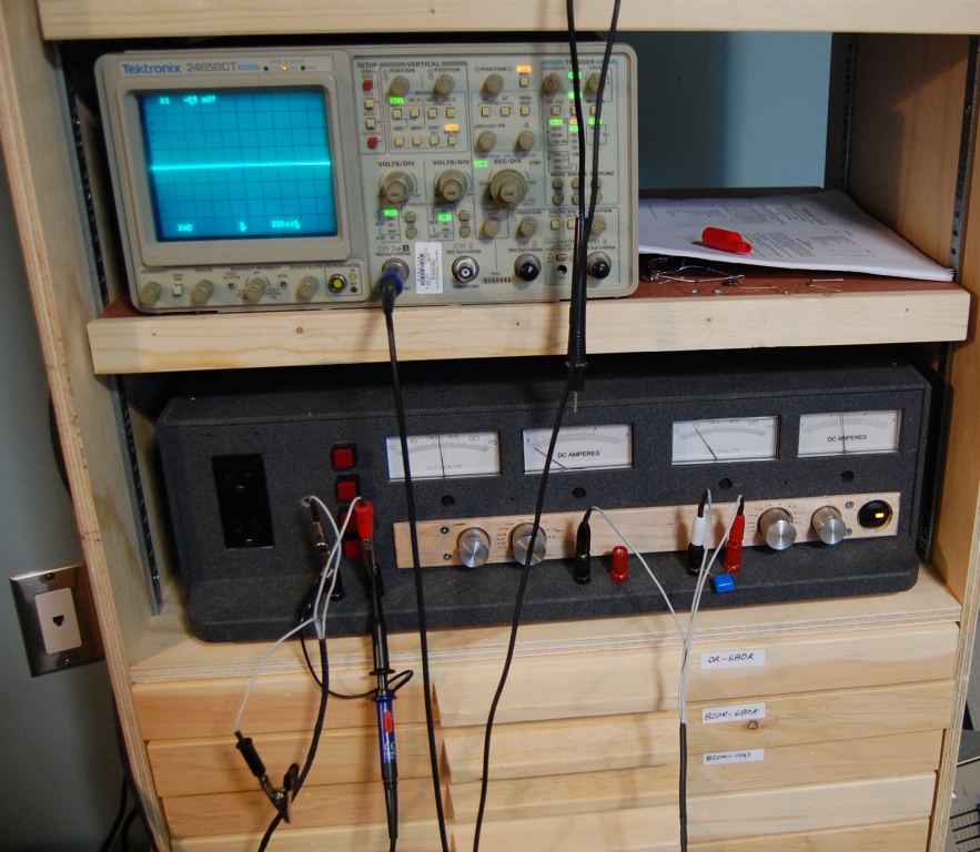

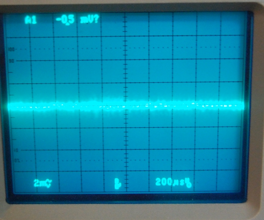

Would it bring you any satisfaction if I were to put a 1uF film cap across the output and photograph the results?
Here it is:
1uF cap across the output. Supply at 15VDC drawing ~1.3A:
Overall view, showing scope output:
Close up of scope:
No signs of instability. The regulator is still working extremely well to maintain voltage and kill ripple (as clearly seen in the scope shot).
I hope this answers some of your questions.

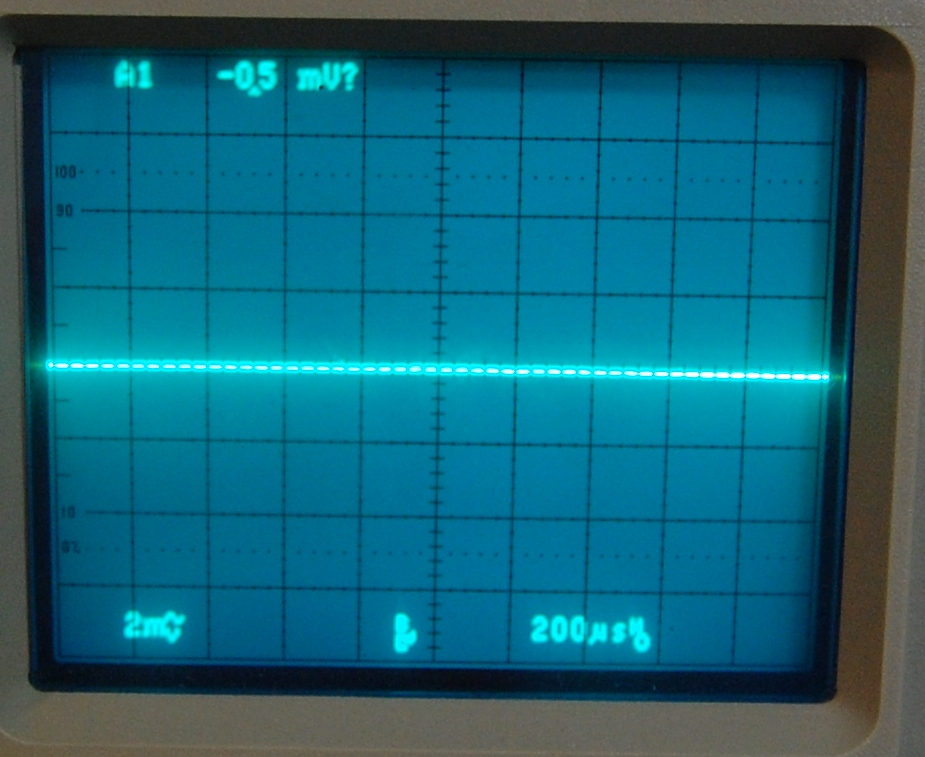

A test that would satisfy me is connecting a 1uF film cap between the terminals and testing with a square wave.
You mean the transient response test? That takes time to set up and I have other things to do at the moment. One of those is testing a new amp that is being powered by this supply. Pumping 10khz squarewaves through the amp near clipping has no effect whatsoever on the supply stability - that should be a reasonable test.
In all fairness and in the name of good scientific procedure, I disclose that the above scope shot was with the probe at 10x (not intentionally).
I redid the same load test, and here is the scope with the probe at 1x:
Still real clean with no discernible ripple or oscillation.
