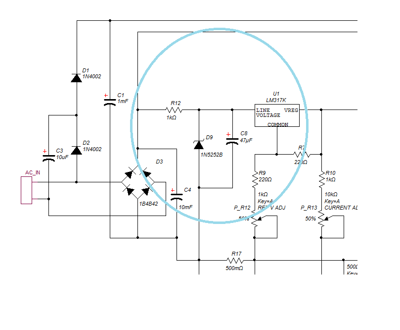

I take it you mean the voltage between the output pin of the LM317 and the negative terminal of the bridge changes. That is inconsequential however as what you need constant really is the voltage between the LM317 output pin and the negative output terminal. You want the current sense resistor R17 to be "outside" the voltage regulating circuit.
It is clear to me now about wat you are saying. I ran the prototype last night both ways and, of course, you are correct...! Again.

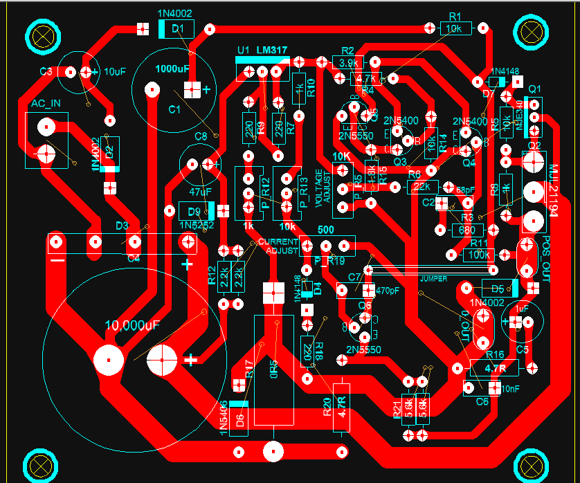

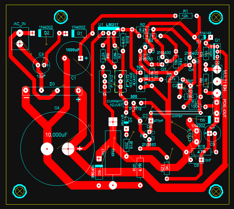

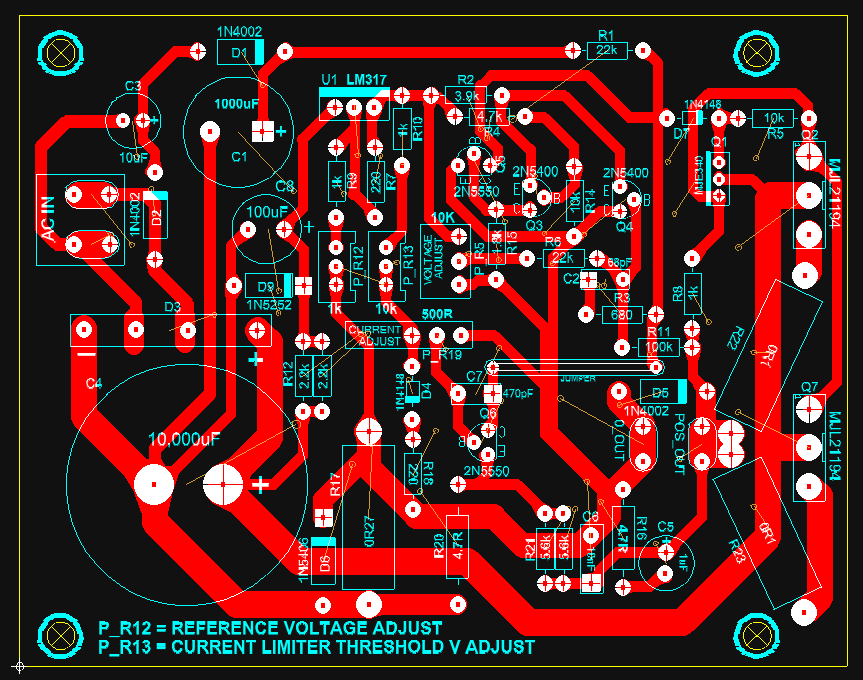

My prototype is looking pretty rough. Too many parts swapped out to try various things. I just burned out the LTP when a long resistor lead broke free. I'll need to either clean it up a bit (and replace those T's) or go ahead and make a new board, closer to the final product:
NEW: Changed the ground reference point for the LM317

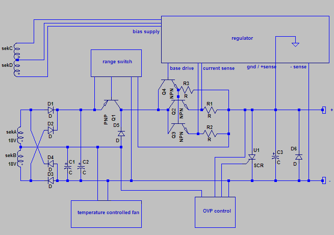

I used the 36V CT 3.5A transformer from one of those old integrated record player-tape-tuner combos to make a 0-36V, 0-2A bench supply. The winding originally used to power the tape deck and tuner was perfect for powering the "floating" regulator circuit and panel meters with +12V, +5V and -5V referenced to the positive output terminal.
IIRC I made the voltage setting go all the way up to 42V but at full load it will drop out of regulation before reaching that high.

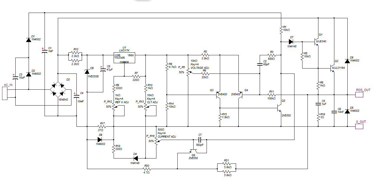

A worthy addition to the supply is a simple shunt regulator before the LM317:
This does a few good things:
- reduce the voltage at the LM to allow it to run cooler.
- reduces ripple at the LM, thereby reducing ripple considerably at the output.
- further isolates the LM from the raw supply, making it more immune to voltage and current fluctuation in the raw supply.

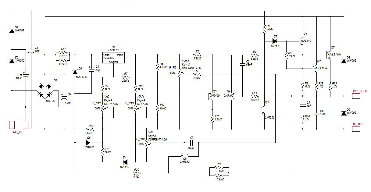

Updated schematic:
Some changes include the new pre-reg shunt. Some resistor values have changed - had an extended tinkering session last night and further refined this.
Nothing written in stone yet, all is subject to change.

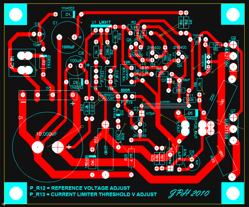

New board:

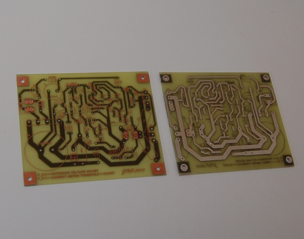

This I will etch and use as my new prototype.

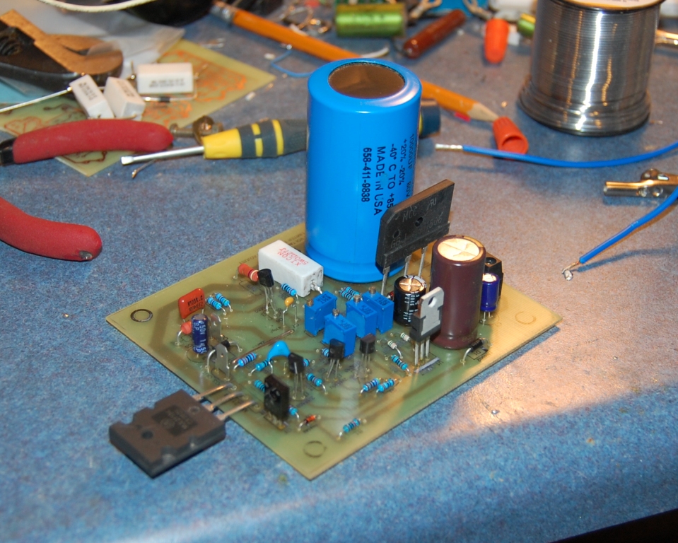

Success! 2 small things that needed to be changed:
- R9 from 220 to 1K to set the correct reference voltage (ideally ~10V).
- R1 from 10K to 22K, this was getting too hot, dropping a maximum 70V at ~7mA. Even running 2 to 3mA at the base of Q1 is enough for well over 2A at the output.
Everything else was roses, once it was "dialed" in. Constant current (set in this instance at 1.6A) deviation was just 20mA when driving an 8 ohm load from 30V down to 15V. This is actually much better than I expected.
As configured, the maximum current into any load at any voltage is ~2.5A and since the raw supply has more capacity than the earlier version, I will leave that current ceiling as is. I also want to go back and add the second pass transistor back in to spread the current and dissipation over 2 devices instead of one. I have a bunch of MJL21194's anyway, just waiting to be used.
So, back to the layout program to do the final board revision.

Refined the layout a bit more:
And made a pair:
Ready to populate. Boards are 10cm x 12cm.
