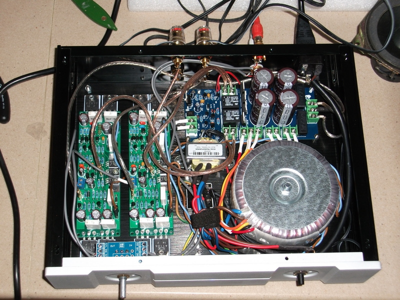

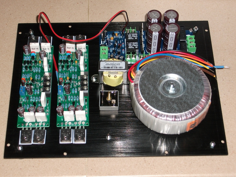

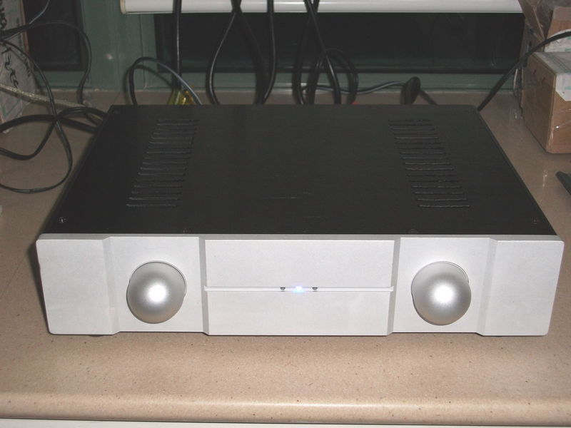

I also finished mine last week – see photos below. As the supplier told me that heat sink is optional, I only ordered 2 amp boards plus 1 power supply board (with speaker protector and soft start).
The transformer is an RS 225VA 25Vx2.
Power consumption measured at power socket is approx. 10W. The case is ice cool at normal listening level and therefore I am planning to block the venting holes to prevent dust from going in.
DC measured at speaker out:
Right Channel: 14.3mv
Left Channel: 10.0mv
So what is your heatsink, maxilogic, just the sheet metal base? Whether your normal level is very low or not or whatever the efficiency of your speakers, just be careful not to turn up the volume or short the outputs as you have no overload protection yet, either.
With the power and signal circuits close together like that, I think you will have some noise and sound quality problems there. I would reconsider that layout.
Thanks for the reminder. It is connected to a pair of Usher S-520 (86db, 8 ohms, 50W). The volume is low as we all live in a very small apartment here in Hong Kong (except for those super rich of course). By the way, the whole chassis is made of aluminum and the base is 4mm thick. I am using a watt meter to monitor the power consumption. Even I turn the volume up a bit above my normal listening level, the max. is only 14W.
With regard to noise, the input signal cable is shielded all the way from RCA to the amp board. I can't hear any noise from 0 volume (7 0'clock position) to 10 or 11 O'clock.
Anyway, I have changed my mind not to block the venting holes as it could be problem in summer.

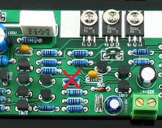

I have a suggestion. Regarding L12-2.
With scissors, cut off the capacitance. Its model for 101.
L12-2 will behave better.
In addition.
Questions about the static current.
Because CFP output make the distortion of the voltage range. Are lower than those of ordinary amplifier.
So. More static current does not have a better performance.
10-20 ma. Is the ideal, the minimum distortion performance. Because of the existence of switch distortion.
In addition.
As a result of the existence of CFP switch distortion.
So we choose high-frequency transistors as much as possible. Reduce switch distortion.
Why I choose 2 sa1186, 2 sc2837.
Because it's not much of a linear gain. So the 2 on the tube.
Interesting. So you recommend removing the components used for frequency compensation?I have a suggestion. Regarding L12-2.
L12-2 will behave better......
Was there really much problem with the stability of Rev. 2?
This is not the frequency compensation. This is just a filter.
The high frequency sound better.
Thank you for the explanation, LJM......This is just a filter. The high frequency sound better.
