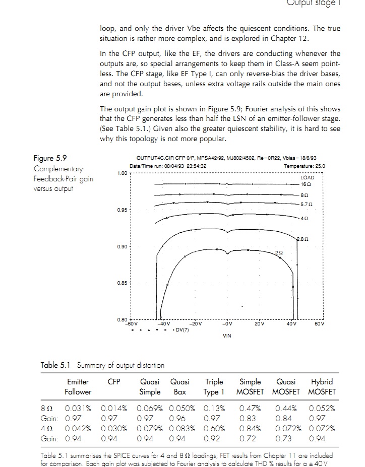

I think he was talking about a range of bias current over which it is not critical.
In the assembly instructions, it was specified as 10-20 mA per pair or 20-40 mA total.
The theoretical bias for CFP pairs is much less than EF designs and is said to be
13 mA/pair at some standard temperature, so it seems fine.
Take a look at the specs. of Self's Load - Invariant amplifier. The schematic is in several of his
books and articles. It is a blameless format design but has 2 prs CFP output stage, like this L12.
Has this topology any advantage of crossover distortion behavior over traditional class-AB designs? I read somewhere here mentioning that bias current value will not affect on performance at all. Is this true?
right
,because CFP OUTPUT,Hand in the distortion zone + -0.6V。
2 Level EF OUTPUT distortion zone + -1.2V
so CFP Can be smaller bias current value
CFP Drive transistor In conduction forever。So it does not need to work on CLASS A.

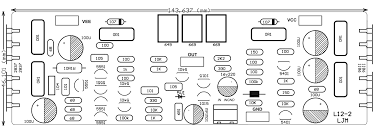

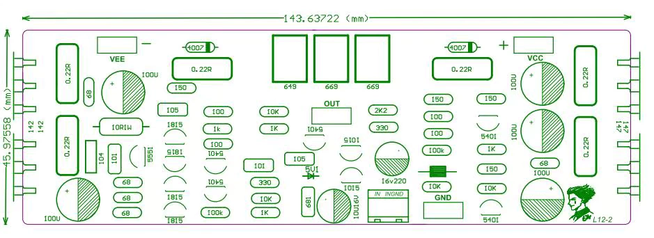

From reading the shematics of the L12-2 power amp, I was trying to decipher what was exactly the audio signal path and then that components it goes througt (resistor caps) ,appart from the path used by the power supply output?
And in the end, what's the true diagram of the power board
this one
images
, or that one?
images
Any help or advise is welcome.
best regards.
Joined 2010
This is the parts layout diagram and all the diagrams are the same. Can you point out anything apart from the logo and colour that is different? The schematic is shown and discussed earlier in the thread if you care to read it.
