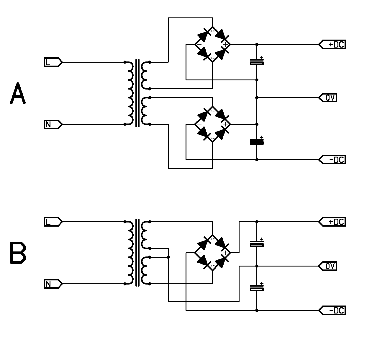

If your transformer has a small voltage difference between the two secondery winding, and you are using a single rectifier bridge, you will hear a hum that cannot be cured. in this case use two bridges, one for each tap...
Something like this?
A instead of B?

In this case the hum would present even if the amplifier is not connected to the signal source. But this is not the case. It's only there as soon as it's connected to the receiver. There must be an external ground loop somewhere between the amp and the receiver...

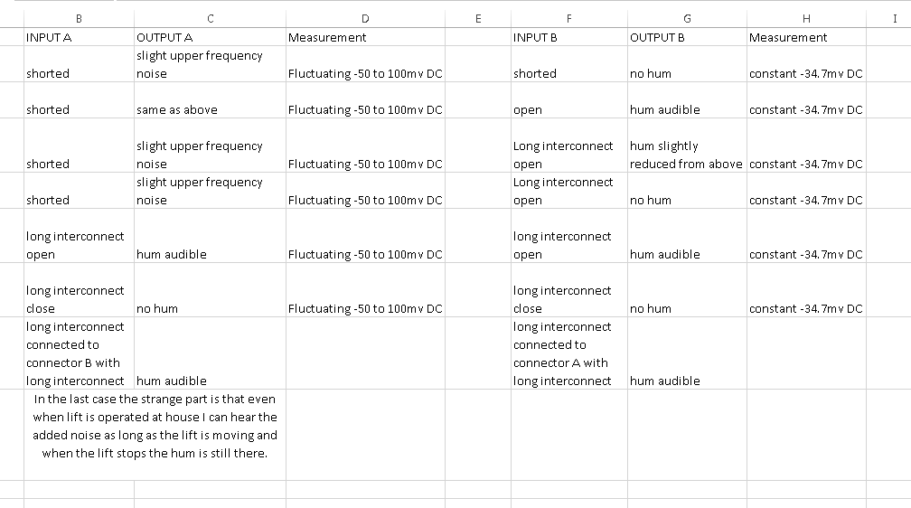

you don't need a scope.
Just measure the Hum+ Noise at the amplifier output. A DMM set to 199.9mVac is good enough
a.) both inputs shorted.
b.) one input shorted one open
c.) one input shorted one with long interconnect.
d.) one input shorted and one long interconnect with the far end shorted.
repeat b, c and d for swapped inputs.
e.) two long interconnects both open.
f.) two long interconnects both shorted.
g.) two long interconnects both shorted, but this time with the barrels shorted together.

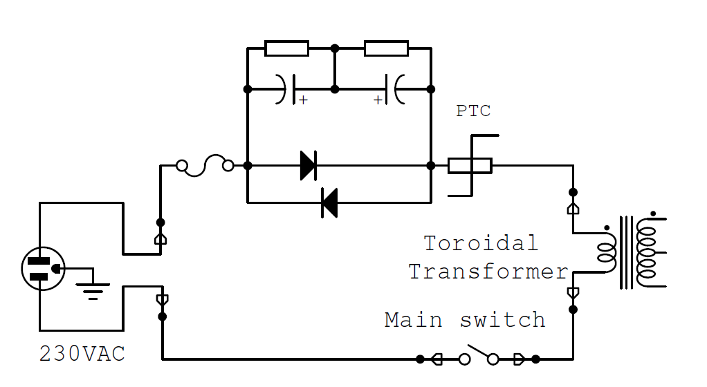

Andrew will do the above list of tests but just to know how about using this one in the connecting to the power ground.
I know that the rightside of the ckt is to block the DC which might enter into the trafo.
But i have a question regarding that how many amps does the bridge to be rated?

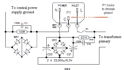

There are two bridge rectifiers.
The left side Bridge:
One is a Safety and in the Disconnecting Network. This must be capable of passing Fault current that can approach and even exceed 1kA. I have used 25A and 35A in paralleled mode for this duty. The pic shows the diodes in series mode.
To date I am the only Member that has tested and reported on this Disconnecting Network. My version passed. This connects from Audio Zero Volts to Chassis.
The diagram posted has omitted the connection from PE to Chassis. You MUST connect PE to Chassis.
The right side bridge:
This one is the DC blocker to help reduce the DC current through the primary of the mains transformer. The rated current of the transformer would be a good guide to choosing a diode bridge for the DC blocker. I have used 3A diodes, but two in series in each direction so that they don't pass any significant current when the capacitor peak voltage is <1000mVpk
I don't like the polar capacitors with reverse voltage applied to them. I use back to back polar capacitors for this duty.
the mains fuse and switch go into the Live feed.
The DC blocker can go into either feed.
In my opinion the PTC should not be there at all.
An NTC could be used but it should be bypassed by a relay to lower the source impedance seen by the transformer.
Your single diodes will start passing at voltages around 400mVpk.
That would require enormous capacitors instead of just very big capacitors.
I use large banks of 3300uF 16V, or 4700uF 10V, to ensure low impedance at 50Hz.

I have done as per you have said and here are the results of the test.
I have used the above earthing scheme with chassis ground and the PE is connected to transformer center tap / psu ground via a bridge and 100ohm+100nF combination as in the circuit diagram.
The last case is the strangest part im able to hear.
Even though there is an EMI filter Im able to hear that.
