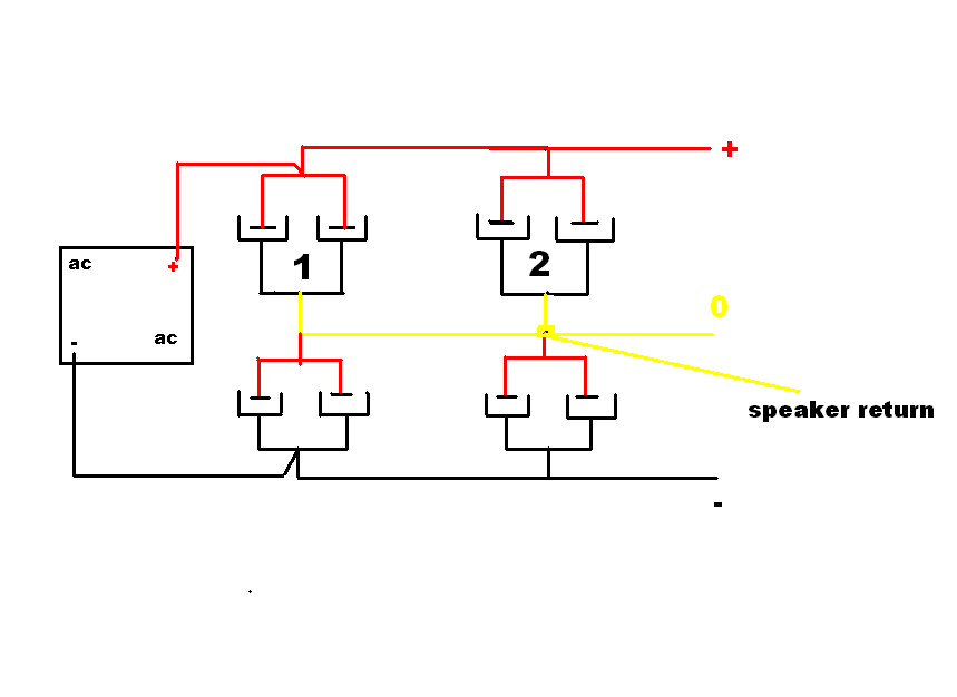

Power supply 0V and speaker return on second cap bank

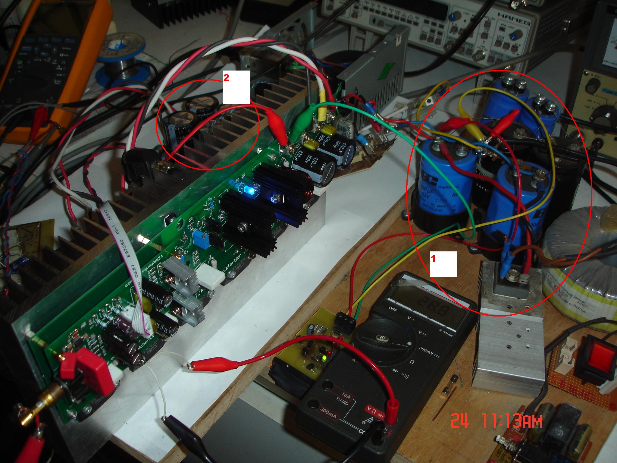

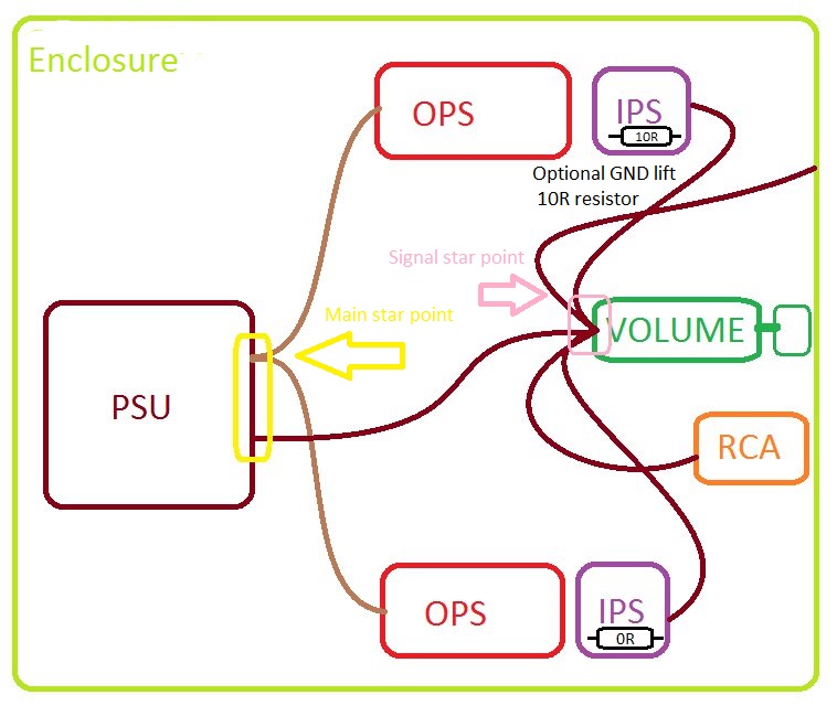

A I can see on the pic, You have one GND star point.
In my opinion better way is to use two star points (I am allways using this setup). Signal star point must be moved away from main PSU GND star point (to make sure no AC component is ''floating'' there). I am using single bridge rectifier on PSU and the ''humm'' component at FFT is very low.
I do not checked Yours PCB's but please make sure that signal GND have separate return (so the main GND connector is not connected to the NFB and input network).

Hi Jeff,what do you think about dual caps bank?
All my past experience shows very good results.
Hi Thimios.
I haven't experimented with that yet but I can see how it might remove some ground noise from the input. This would be kind of like what Borys is suggesting but a more extreme version.

I mean like this.
There are a lot of so called audio gurus with completely different opinions on connecting grounds this way, but most of them agree the grounds shouldn't connect directly between the capacitors like that due to the high current of charging and discharging the capacitors right there. I haven't tested this myself, but I can see some possible advantage to dumping the high current from the speaker returns somewhere other than where the audio ground connects though.

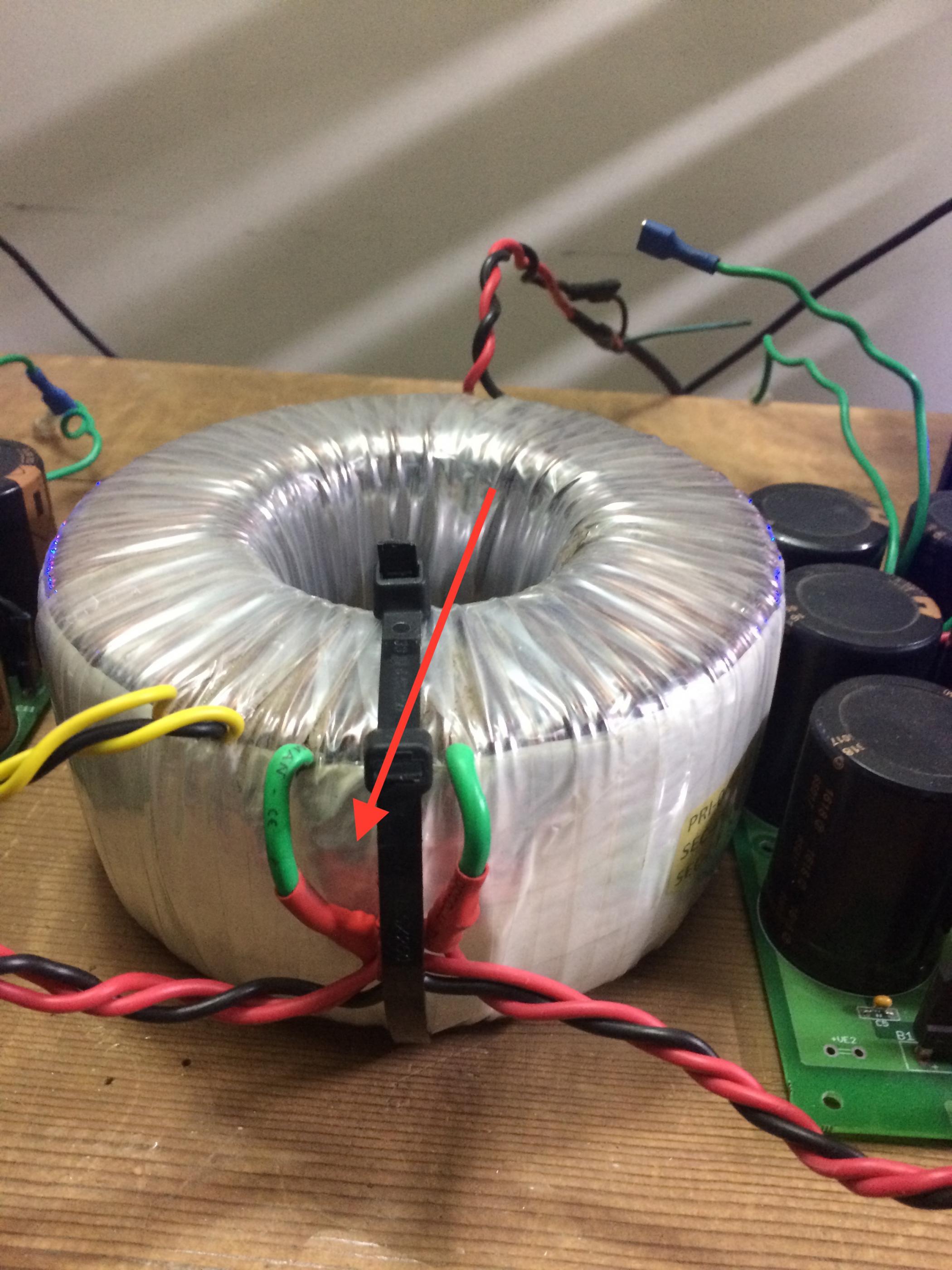

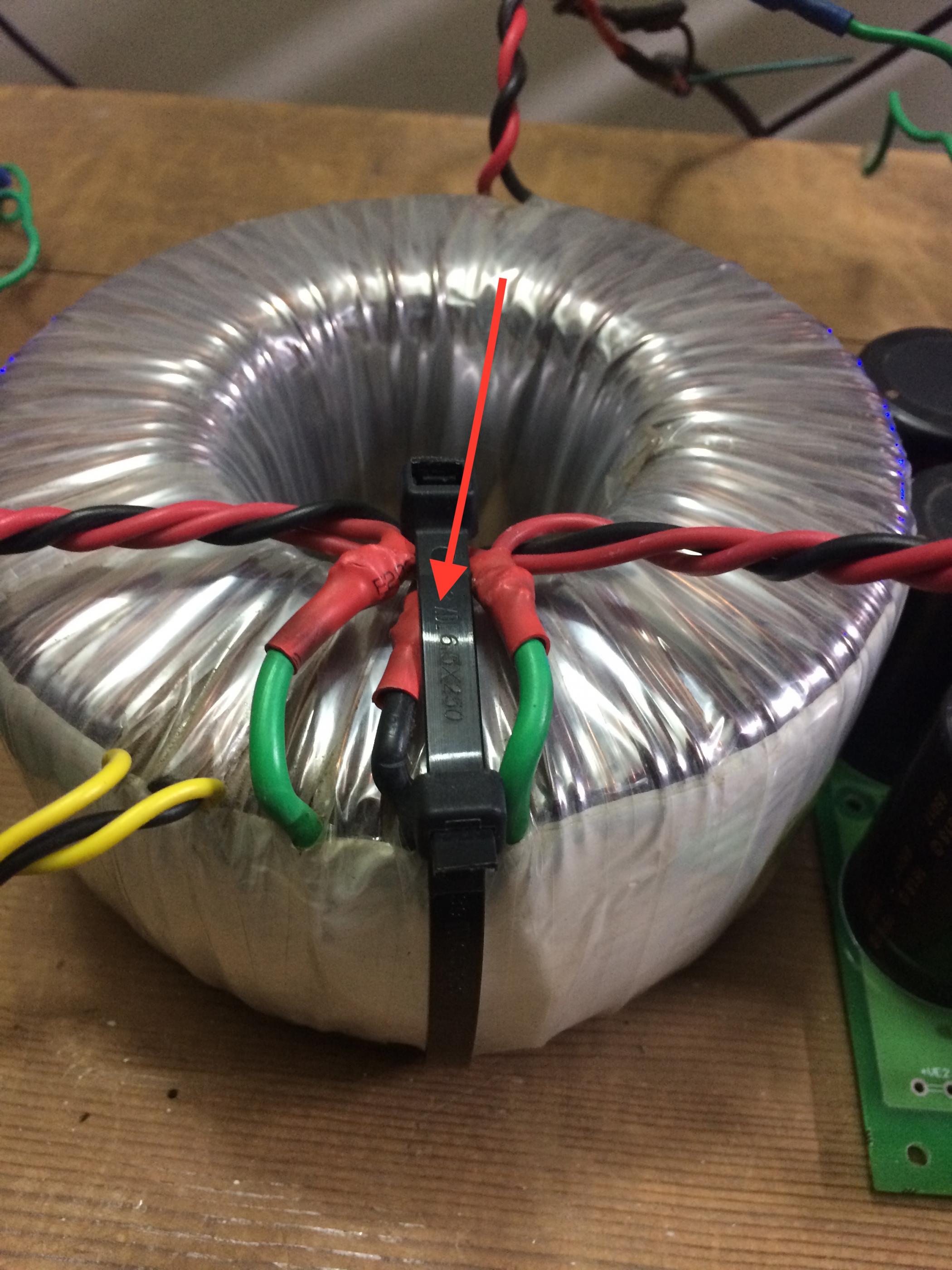

OK, problem solved. The cause of the noise was incorrect orientation of the transformer secondary wires. It sounds far fetched, but true. There is absolutely no noise now. Amp working perfectly now, have put it on endurance testing. See the photos below, the one on the left is the incorrect orientation.

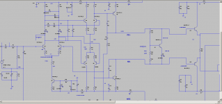

Hi Rhythmsandy,
Can you please show the exact schematic you're using and specify the rail voltage.
Valery
Hi Rhythmsandy,

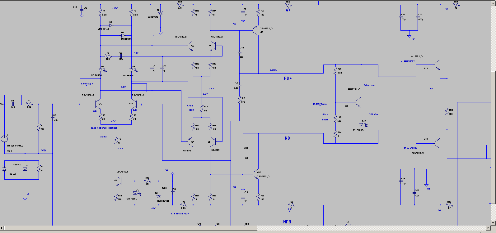

Here is the schematic and Im using 5 pairs of IRFP240/9240 at 70VDC
IPS Stage at +/-70VDC and OPS at +/-64VDC
- Kypton V2
