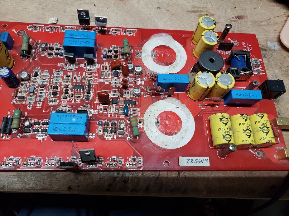

Put one FET in each bank on the side that causes the a protection issue. Remove the toroid inductor L105 or L106 on the side with a problem and power up. If this allows the amp to come out of protection, the inductor may be causing an issue.

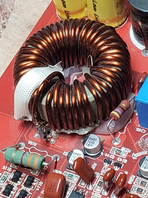

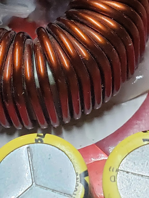

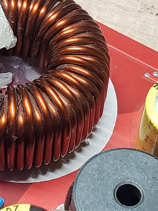

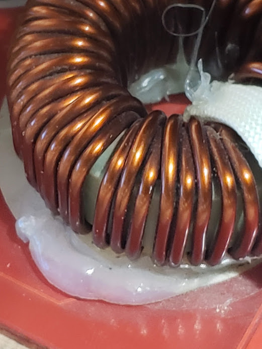

Post a pic of bad inductor. Examine the inductor closely. Look for delamination, cracked core. Check the insulator for perforations
does this mean its something to the right of the inductors if nothing changed when i swapped them and it seems to run fine without them installed?
You still have one bank on each side to populate. You should have 2 Irf9640 and 1 Irf640 on each side of board.
My mistake, you are correct. Replace both inductors and remove all outputs. Check for drive at the common side of gate resistors.
