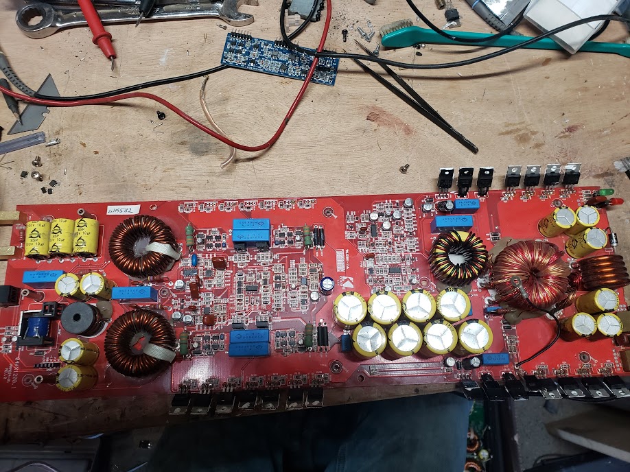

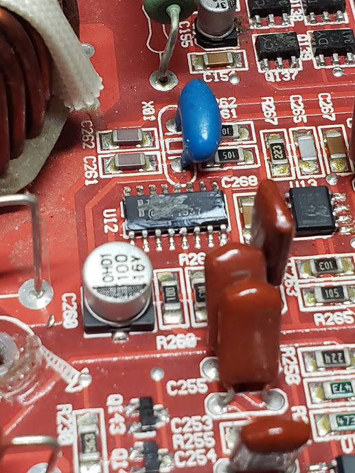

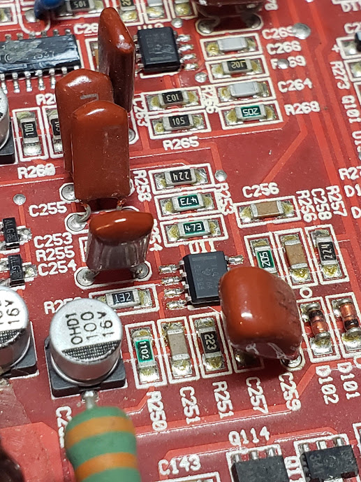

the amp powers up but no audio. I checked all the output fets already. the last place I see a signal is on the tl072 at U11. Also whats the ic at U12?

U12 is a MC14060B. Link Below. U14 is a LM361. Link Below.

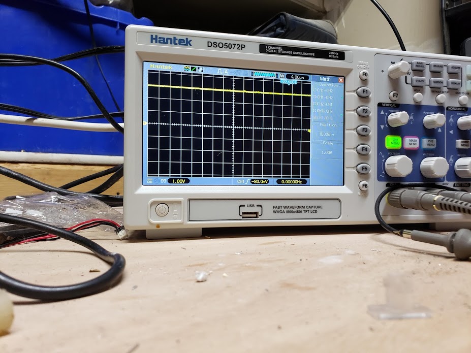

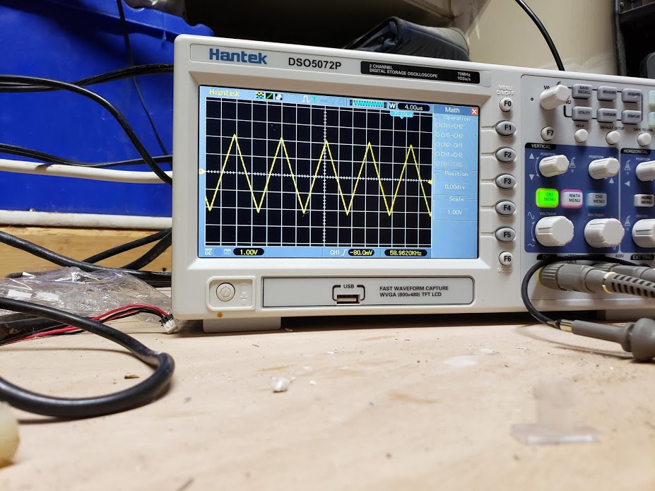

U12 is an squarewave oscillator.U12-Pin 5 feeds Pin 2 of U13-TL072C. Pin 1 of U13 feeds the base of Q103-3875GR. C266-47p at the base of Q103 integrates the squarewave and generates a triangle wave.
You should see a triangle wave at Pin 4 of U14 comparator. Pin 3-U14 is the signal or audio input. Pin 13-U14 should be the composite squarewave and audio.
If you have an oscilloscope look to see if you have the triangle and squarewave at the Pins I mentioned. Post screenshots. Also, measure the DC voltages around U14 using the negative speaker terminal for black probe and scope ground. Post the results in the following manner:

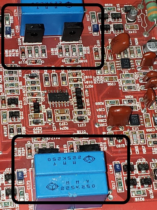

I posted your pic of main board, that's been cropped. Please take a close up of this area and post. I tried to magnify your pic, but not able to without pixalation. I will be able to edit pic and point out test points etc
The U14-LM361 may have failed. Replace if you haven't already. Also, check the DC voltages across D107,D108,D120,D121.
Check everything you see in the boxes with an ohmmeter.
Remove all of the IRF640's and IRF9640's, you will be able to troubleshoot the drive circuit w/o the outputs.
Replace U14-LM361 If you haven't already.
