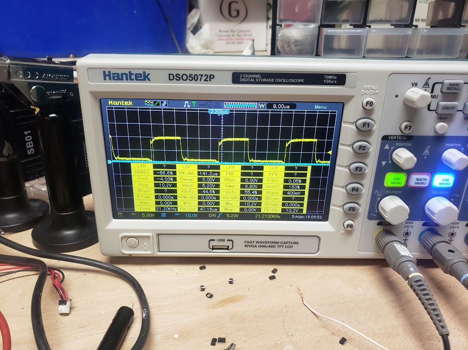

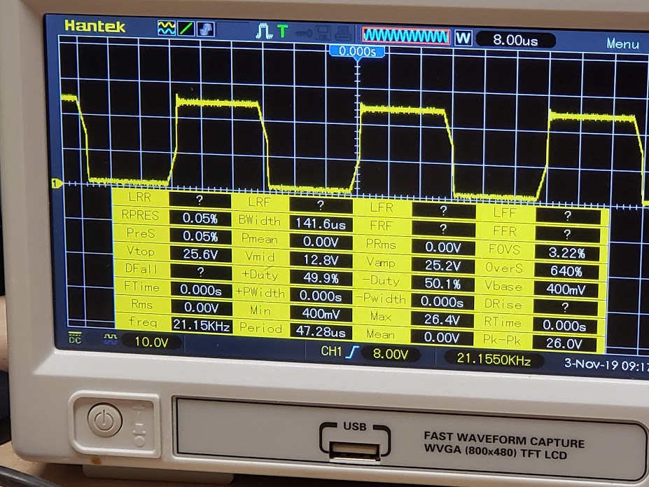

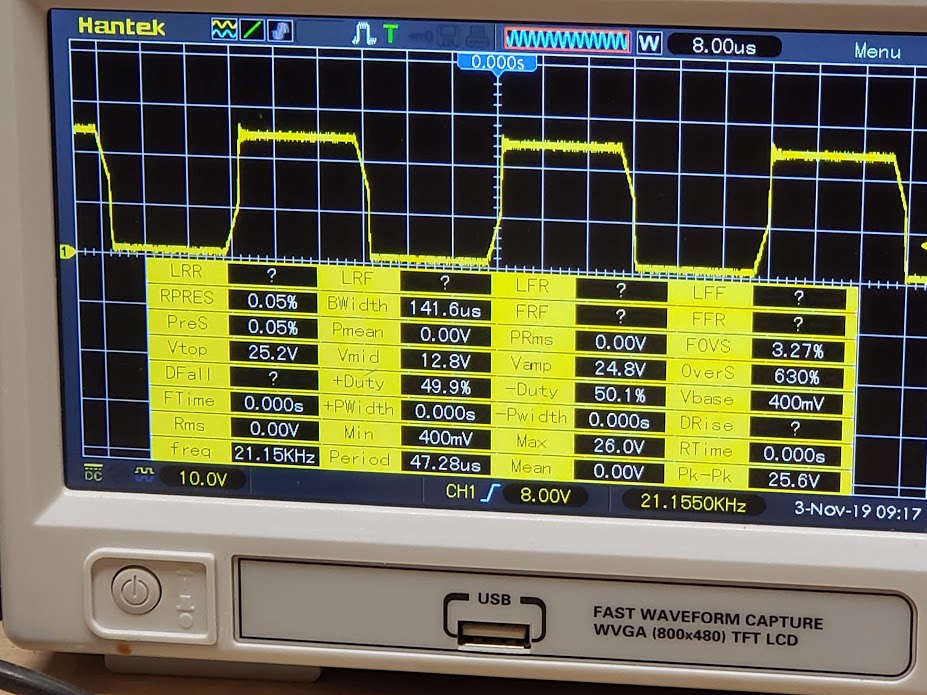

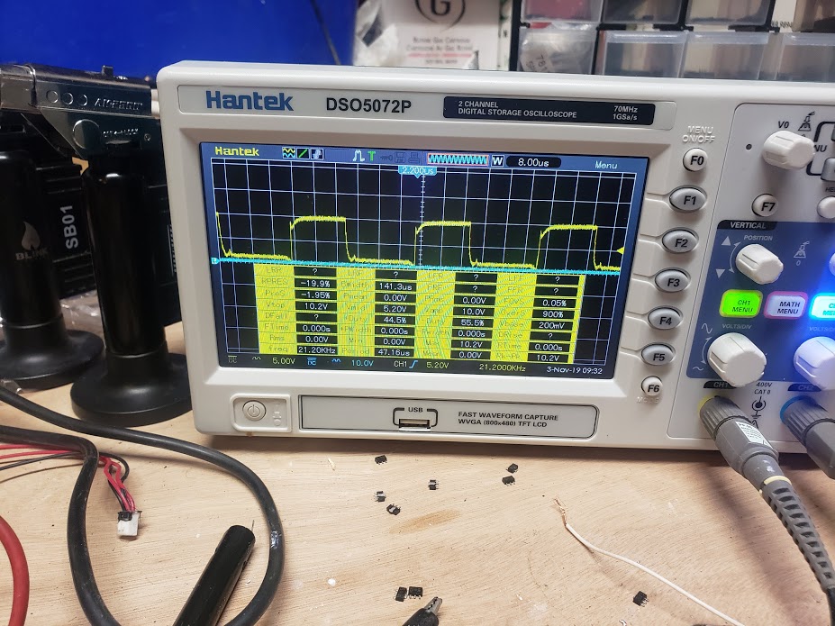

To clarify, the drive to the output gate resistors.
So, after lifting R11, what is the status of the amp? Is the green LED lit or red LED lit or flashing?
Is the power supply producing rails and what is the +/- rail Vdc,+/- regulated Vdc?
Do you have drive(squarewave) to the Output mosfets? Post screenshots for both banks on either side.

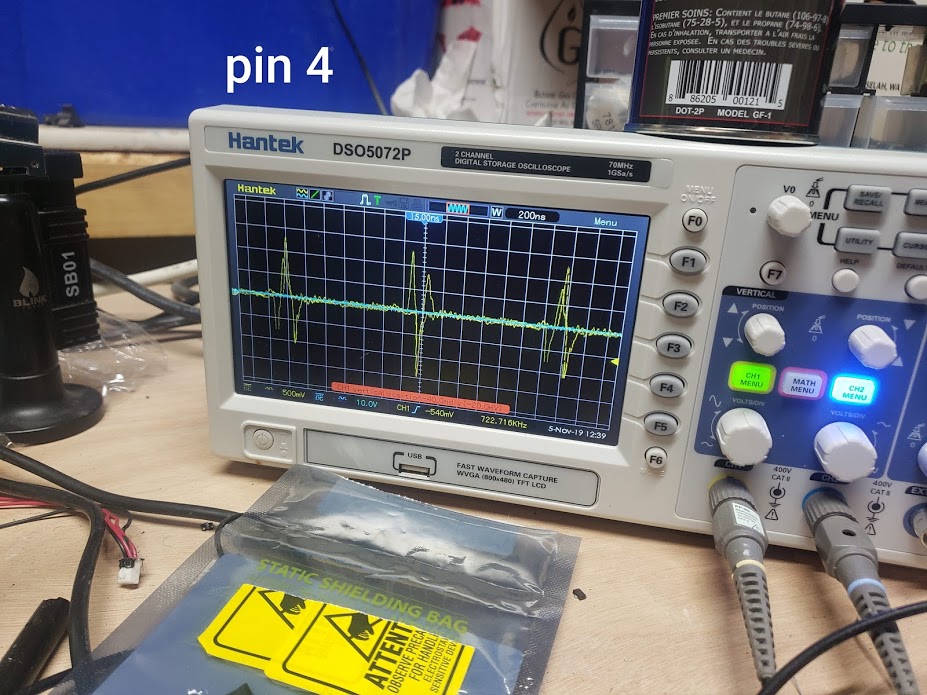

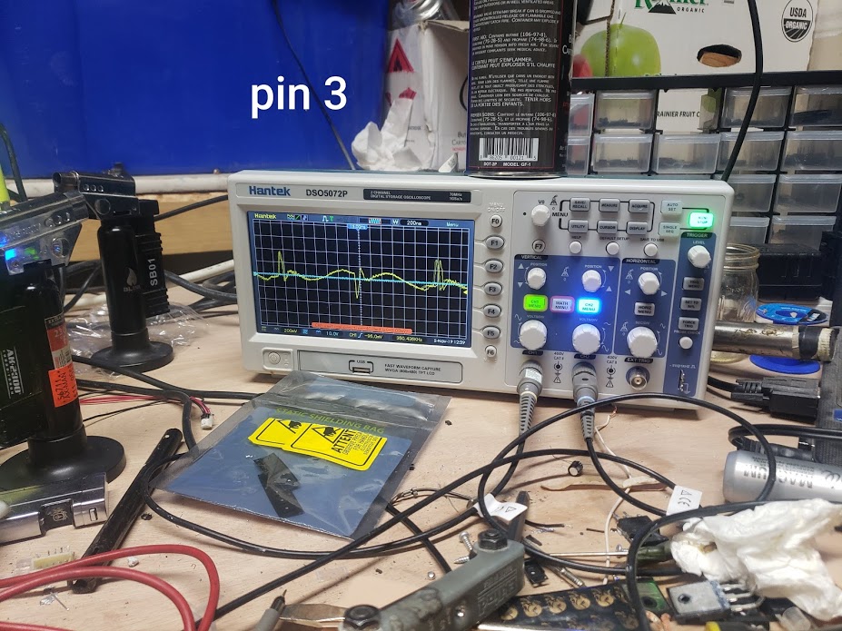

Check U14 Pin 3(triangle wave) and Pin 11(Squarewave) and post screenshots.
It's possible you will have to populate the output mosfets (one IRF640 and two IRF9640 on each side)in order to produce drive, due to the four 9640's to three 640's and feedback loop.

When you say "that resolved the issue" Do you mean the amp came out of protection? Was there ever a condition when you had drive on one side or the other?
Replace the Inductors, and remove all of the output mosfets. Lift R11-10k ohm. You will find it near Q10-3875GR. This should disable protection. If amp Powers up, check for drive/ squarewave at the gate resistors. Post screenshots for all banks.

After lifting R11 the amp powers up fine with the fets in drawing 1.3 amps at idle.
There is 63.4 volts on both positive Banks and -54.7 on both negative Banks however I did not see any Drive waves. I'm not sure I understand what "Regulated vdc" means

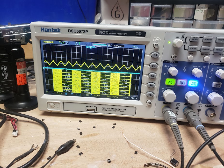

Pin 3 of U14 has -6.43 VDC but no triangle wave however pin 4 does have a triangle wave. Pin 11 does not have a square wave just 6.9 VDC.

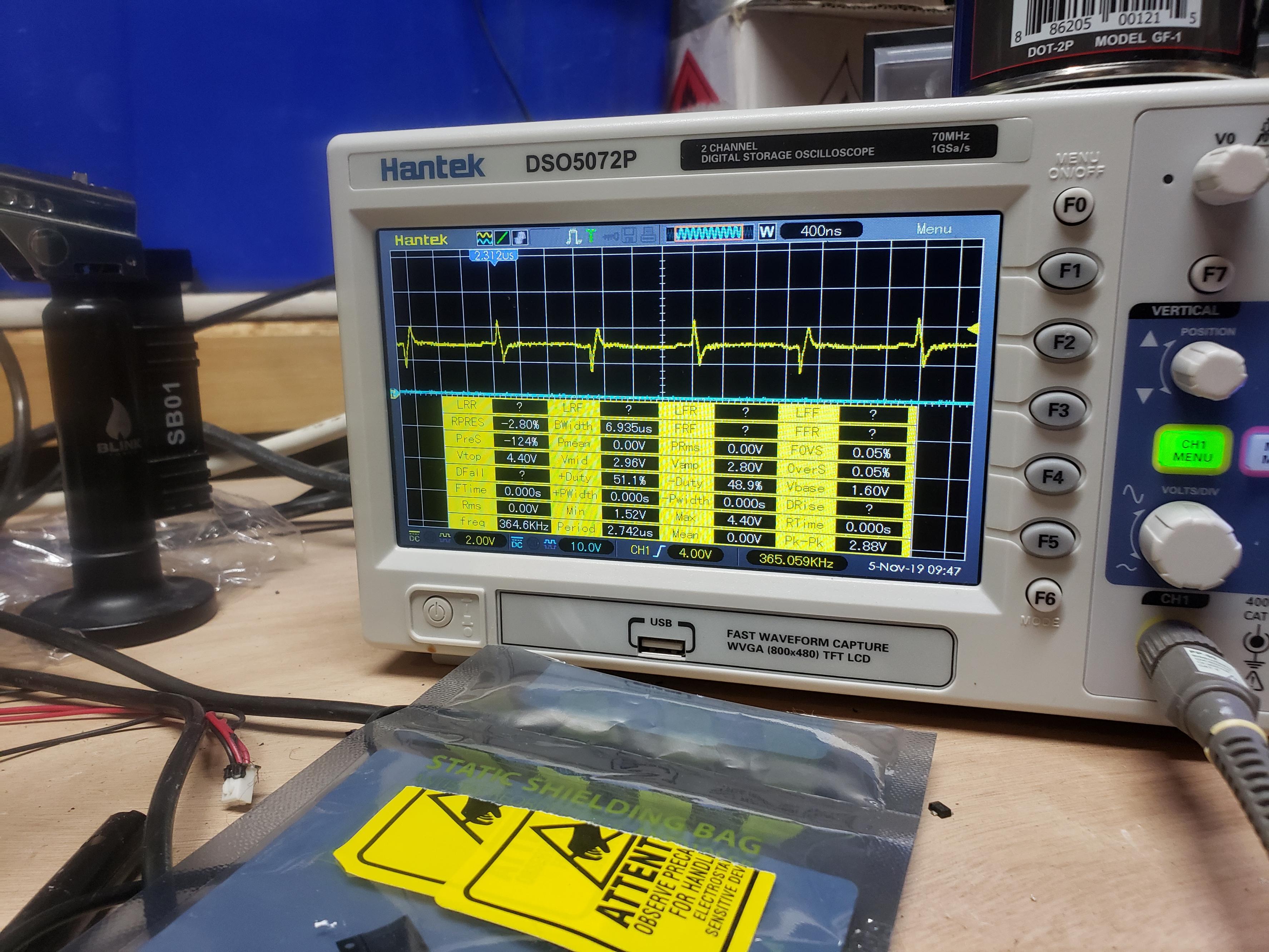

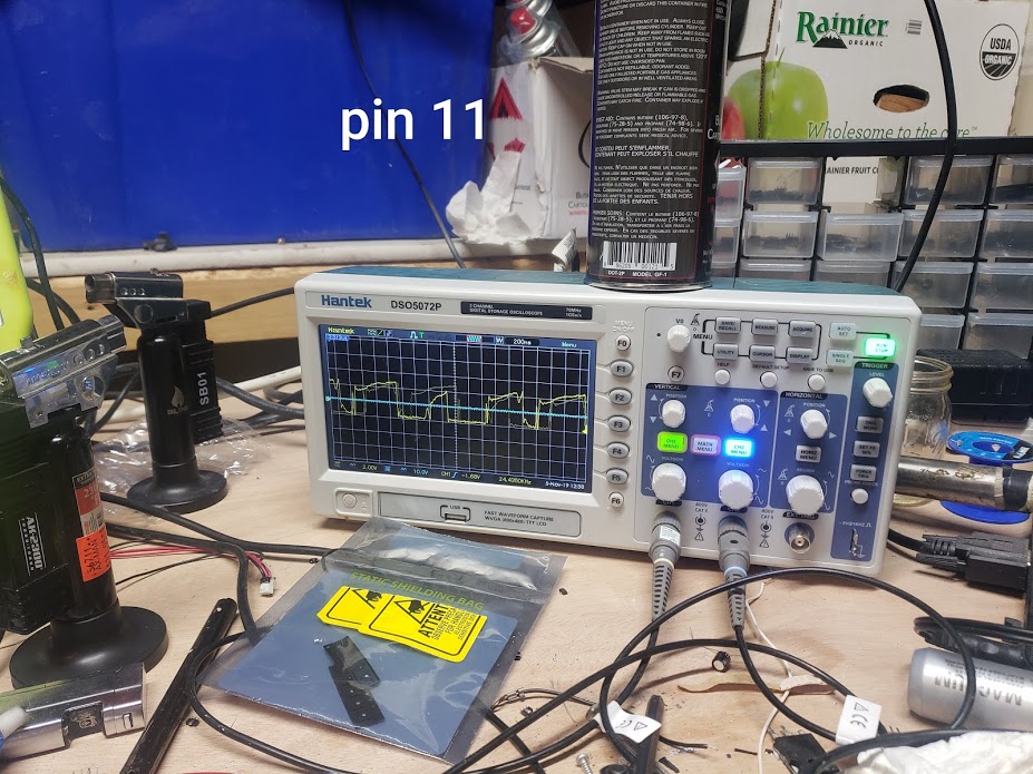

Place a jumper(Maybe 22 gauge wire) between U14 Pin 4 and C270 (Speaker Ground side) and check to see if you have drive on Pin 11. If there is something in the feedback loop suppressing the drive barring any other problems this will prove that the comparator is working.
You might consider replacing the C3503's and A1381's drivers.
I pulled both c3503's and a1381's and tested them with a transistor tester and they all tested fine
yes. I still don't see any waves but when I play 100hz sinewave and adjust the vol the voltage fluctuates with it
I was wrong. I put fets in and it is functional with pin 4 jumped. it idles at 1.7a
