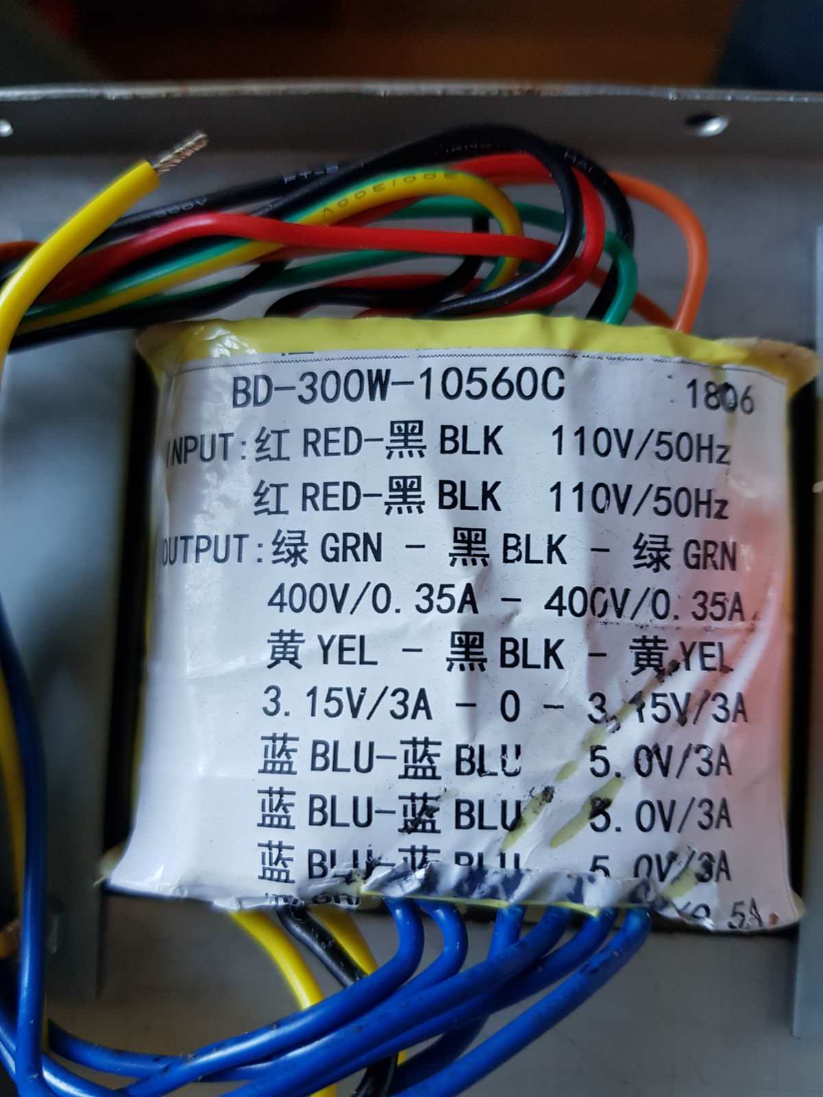

The transformer in the kit vishalk has is now clearly the incorrect one for that kit. Now I expand the picture from vishalk you can also see 3 x 5.0 volt secondaries, not 1 x 5.0 volt and 1 x 6.3 volt as well as the 400-0-400 when it should be 350-0-350.
Vishalk - sorry to say you will have to get them to replace it. It is the wrong one for that kit.
The pics in post 1 were what the supplier sent to aid his assembly.
Not pics of the actual transformer supplied.
We must wait for Vishalk to tell us which transformer he has.

Alan you don't have to tell me mate, that is the transformer and yes you're right it does not have 1 x 6.3 volts. The voltage is also 400v! I just assumed the 5v would be ok to use for the rectifier.
Will this really make a difference? Or should i just wait and get them to send the right one.

Pity we didn't spot it earlier, but YES you have to get the correct one.
(No excuse, but the pictures aspect ratio is wrong on the early posts and it is difficult to see the secondary values unless you 'expand' it...)
That 400 volt winding will result in an HT (B+) voltage too big for the supplied caps and you need the 6.3 volts for the 6N8s. Plus the proper transformer has a 240 volt mains selection... and so on.
Don't even consider using it now. The supplier will replace it for the correct one I'm sure .

You know you can slap band aids on it, like current limiters, and a bucking transformer, but seriously you should ask yourself why? All those tricks would not be necessary if you had the correct PT. And if no one holds the seller to provide the correct parts for the kit then they will just carry on leaving everyone with a bad experience.
I am sure you paid with Paypal, which can also help you with resolving any problems if it comes to that.
You're right dak808, i have messaged the seller with pictures and told them it needs sorting out. Specified i need 240v 350-0-350, 6.3v, 5v and 3.15.

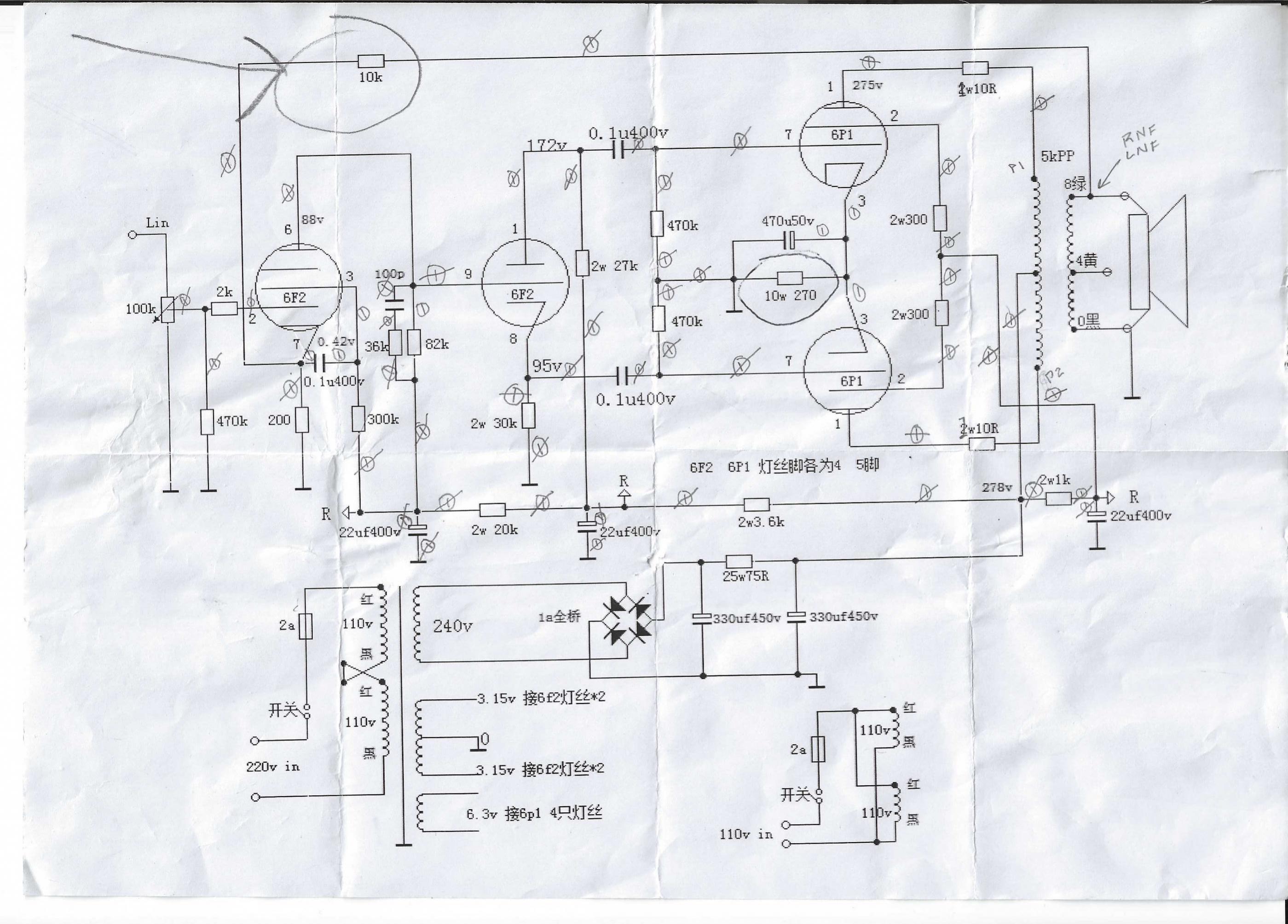

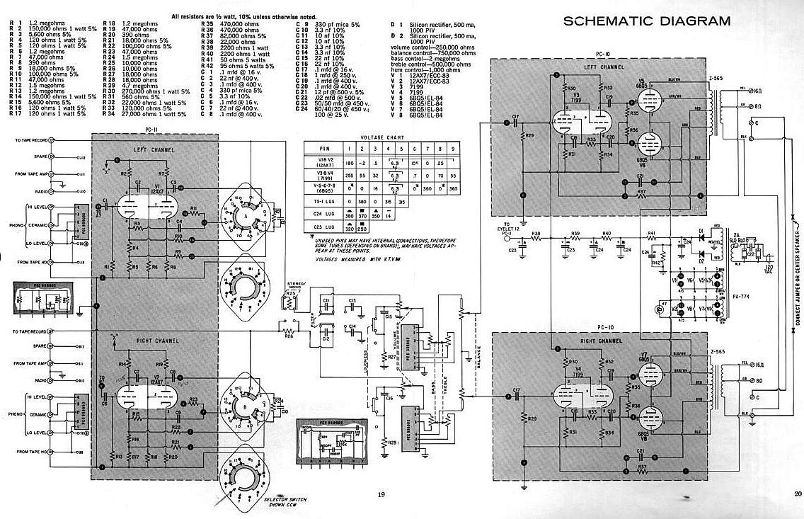

I purchased ChiFi PP amp last April. (Schematic posted below).They must use same diagramming company as mine by the looks of it. I was able to complete my amp by the schematic provided, but wouldn't recommend anyone buying the DIY kit unless fluent w/diagrams.

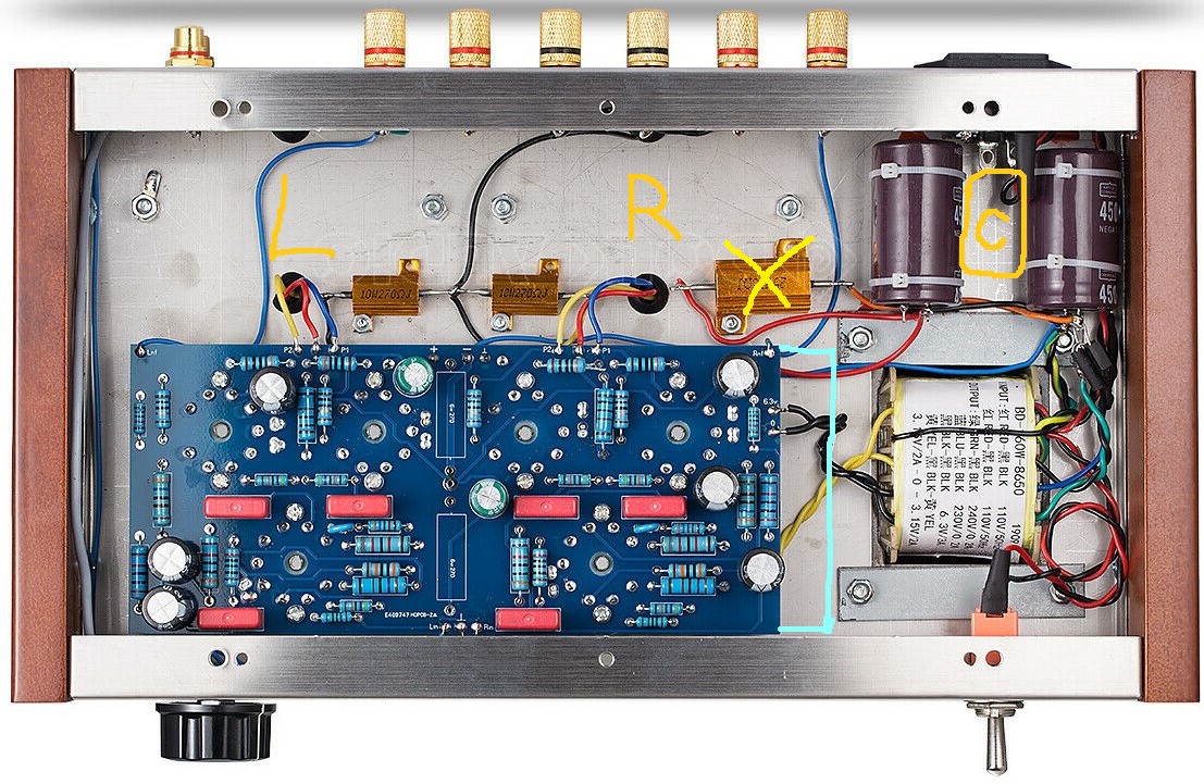

Per your Power trans issue, try adding power resistor- my kit came w/75 ohm 25W(yellow X in pic) to the 400/400 center tap line. It dropped 53V in my design. Others may be able to advise better value than that.

The new GND reference point would have to be after the resistor- Not sure of impact on noise.
Another option would be to place in circuit where red resistor label is added.

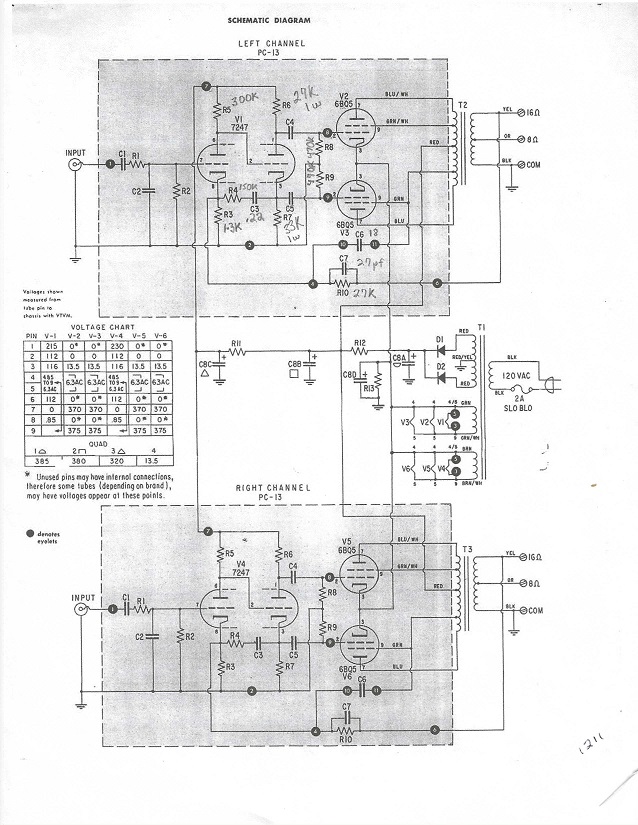

oemcar,
Your Post # 54 schematic has an interesting twist:
The concertina has 30k in the cathode, and 27k in the plate.
That creates un-equal signal amplitudes to the output tubes Push (27k times concertina signal current), and Pull (30k times concertina signal current).
That becomes 2nd harmonic distortion, and 2nd order intermodulation distortion.
The negative feedback reduces those two distortions.
Just something most do not think about.
Now, perhaps, the designers noticed that with equal concertina cathode and plate resistors, the signal amplitudes were un-equal.
If so, that would be caused by filament to cathode leakage resistance in parallel with the cathode resistor.
The problem with using un-matched cathode and plate resistors, is that the filament to cathode leakage resistance is not a constant, it varies from tube to tube, and also with the age of the tube.
The only solutions with this problem is to use equal cathode and plate reistors, and then . . .
Pick a tube that has very large maximum cathode to filament voltage rating (including the DC and peak signal swing on top of that);
and if necessary to elevate to the proper voltage to keep the DC and peak voltages of the cathode to be within the cathode to filament specs.

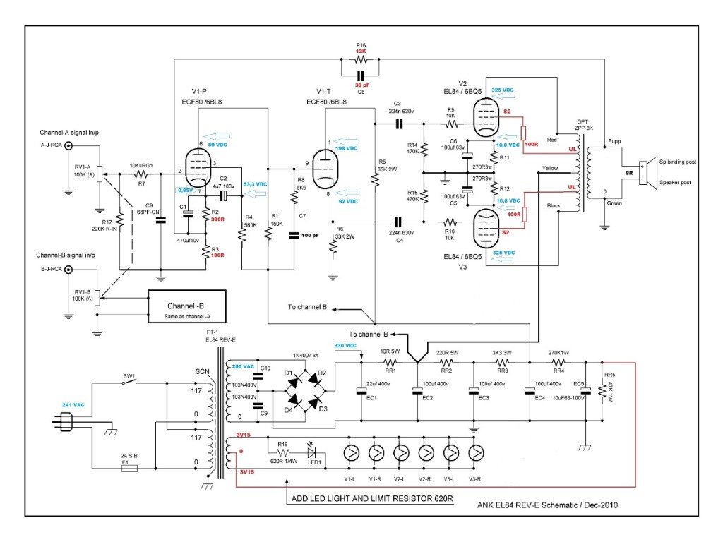

I've heard that before w/ the ChiFi design you reference. Makes sense to balance these in a phase splitter(concertina)to equally load the AC sig to the PP output pentodes.
Next design built was Audio Note EL84, which, as you can see below, were balanced. Then Dynaco ST-35 (also SCA-35) which aren't....
Point of interest-
Both Dynaco designs have RC path between cathodes that Audio Note doesn't. Could this factor into the balance?
Jim
