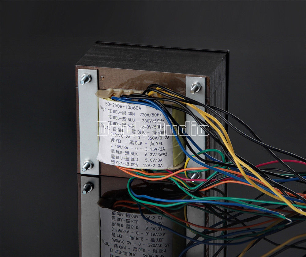

Hi vishalk, I guess they will be too high by 10% or so.
Pointless replacing the transformer at this stage (unless money is no object) the ''Bucking'' transformer is a perfectly normal fix in the UK for using 220 volt kit on 240/245 volt mains. (See the link Bucking Xfmrs on post #17.)

Alan could i just buy a toridial transformer? 240v to 20/24V? What VA rating would be ideal? Want to be able to place it in the chassis if possible.

Yes, a 50VA 20 or 24 volt toroidal will be fine.
Do it this way:
Work out the current the amp will draw when working at 220 volts. Rough is fine as long as we over calculate the need. Heaters need 46 Watts, the HT (B+) needs 85 or 95 Watts (assumes the KT88s need 40 to 45 each and the 6N8ps need 2.5 watts each). Total is roughly 141, so call it 150W. That is about 0.7 Amps at 220 volts.
The bucking transformer secondary has to carry a minimum of 0.7 amps, so using the two times factor for losses and cool running = 1.4 Amps minimum. That is 34VA minimum for a 24 volt transformer. Therefore, best go to 2 Amps and 50VA.
I would build the amplifier first, and power it from the Bucking transformer externally like your example. Best to know the native level of hum it has, before adding more magnetic loops in there with so much iron... I expect there will be room in there anyway.
Alan

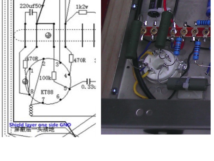

vishalk,
The KT88 tube does not have any connection to pin 1.
The EL34 Does have a connection to pin 1, it is the Suppressor Grid of the EL34 True Pentode. It must be connected to something.
Was this amp specified for using both the KT88 tube, and also for using the EL34 tube?
The KT88 has different maximum ratings for plate voltage, plate dissipation, screen voltage, screen dissipation, and cathode current; versus the maximum ratings of the EL34. Do not use the EL34 in place of the KT88 unless you check all these parameters. Otherwise there could be damage to the tube, and depending on the circuit and parts, could be a problem for other parts (i.e. less current draw causing B+ volts to go too high for the B+ capacitors) Check before trying.
Hi 6a3
There is no el34 tubes, but kt88 and 6n8p, the pins I am talking about are the kt88. Please see page one of this thread. I will check the parameters, its a kt88 amplifier kit.
..The KT88 tube does not have any connection to pin 1....
It should be the metal (base) shell.
(I note the JJ 2006 data says different.)
It would normally be tied to ground.
If tied to cathode as shown, there is a small slight shock hazard. (But it is unwise to put your hands close to a large hot bottle: I once had a hand-burn in the shape of a 6550.) There is the unlikely risk of some metallic object loose on the chassis shorting-out the cathode bias, which would be bad.
The indicated connection 8-1 probably won't cause any trouble.
The shell "should" be grounded for maximum safety and shielding. I do not think this is very important in home audio. I am distressed that a major maker shows KT88 p1 as "G3" (though picture shows G3 to K).
I'd just leave pin 1 floating.
Which is indeed the only thing you can do with the short-count socket they shipped.
PRR,
Good catch. Pin 1 is the shield. And I could never understand the need for a shield at (only) the base of a Beam Power tube. Also, the JJ that says it is G3, just seems like a reminder of about the only Power Pentode tubes that have G3 on pin1 is the 6CA7/EL34. Curious.

Today, that first post link says 110 - 120, 220 - 240.
230V +/- 4.3% = 220 - 240V
If you look at the pics shown in the first post the PT only has 2 110vac inputs. So there is only 220v or 110 vac input voltage.
However the ebay ad shows 110,120, 220,240 vac input.
Thus there is a discrepancy that could be disputed. These issues should be challenged to ebay and any other outlet that sells this type of equipment.
