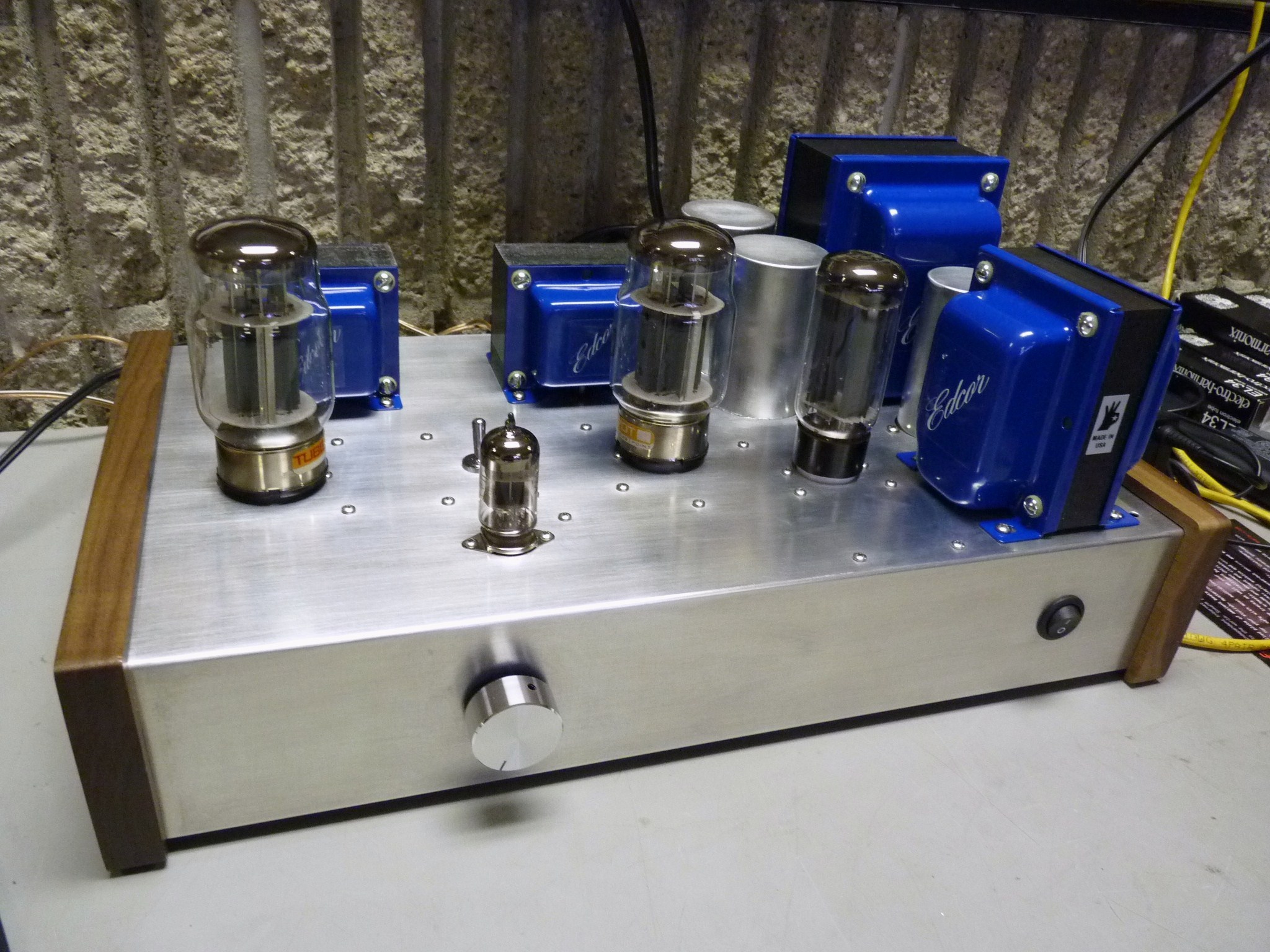

I have just finished the amp using the Edcor transformers. Just as I expected, excellent sound, plenty of bass, transparent highs. Inaudible hum on my 98dB speakers. When measuring across the speaker terminals with my Fluke 85 I get 1.4mV of AC noise. I will be taking more accurate measurements when I put the scope on it in the next couple of days. I will now be able to complete the first edition of the manual. For those of you looking to provide your own transformers, I'm very pleased with the GXSE15-6-5K even with the 40-18KHz response. For a $37.01 output transformer, these are hard to beat if you're on a budget. As soon as the custom transformers arrive I will be swapping out the Edcor units.
That's really great looking! I think that'll make an excellent kit. Though the output transformers are rated at 40-18KHz, have you checked to see what the 3dB response is? Also, does the amp have any feedback? And are the two Edcors on the right both transformers, or is one a choke?

The rear Edcor on the right is the power transformer, the front right Edcor is the first power supply filter choke. There are two additional filter chokes, one per channel, for the driver tube located internally. I will check the 3dB response although my speakers have an F3 of 46Hz. The custom transformers I will be offering with the kit will be flat response from 20-20KHz. I have been wanting to try the GXSE Edcors, and while they don't disappoint for the cost, the xfmrs I am using on my previous build do seem to have a bit more "sparkle" on the high end. I expect the custom OTs that I am having manufactured to be very good on both the low and high end. When I receive them, I will be swapping out the Edcors.
No feedback on this amp. I tried feedback on my previous build and I feel that it took away from the dynamics of the sound.

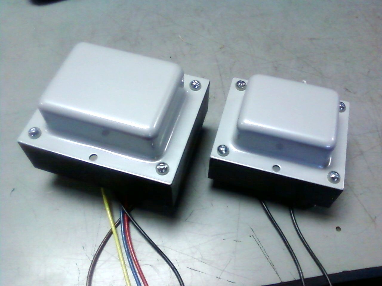

I received the first set of transformers for approval and I am working to install them replacing the Edcor units. The attached photo shows one of the output transformers on the left and the power choke on the right. For reference, the OT measures 4.5" X 3.75" X 2.75" high to the top of the endbell, and weighs in at 7.75 lbs. The power transformer is the same width and depth as the OT but is 3.0" tall, same color endbell.
