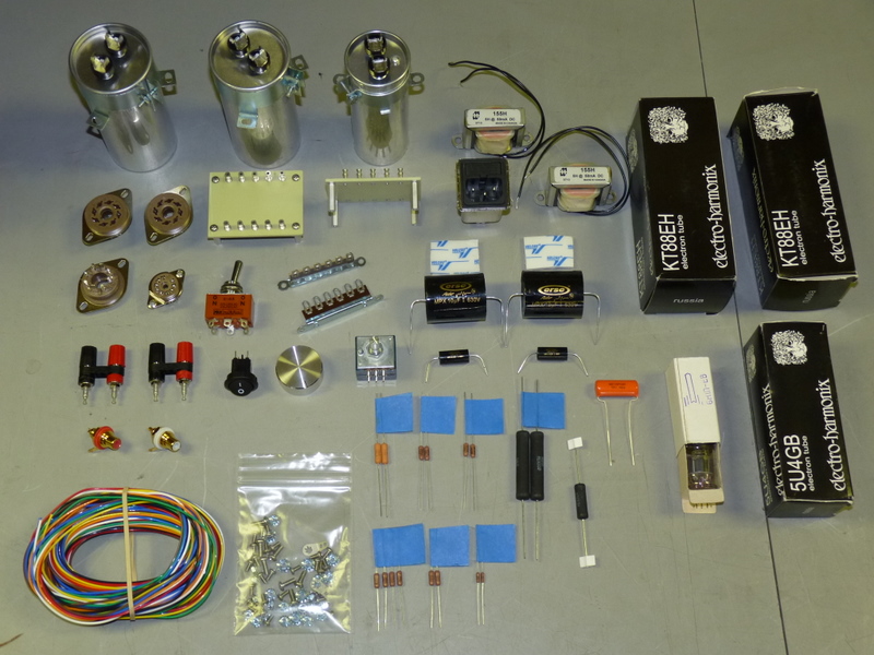

Here is a list of the parts included in the basic parts kit:
1 - Assembly Manual on CD
Resistors - Vishay
2 - 220K 1/4W Metal Film 1%
2 - 100R 1W Metal Film 1%
4 - 1K 1/2W Metal Film 1%
2 - 1.5K 1W Metal Film 1%
2 - 47K 3W Metal Film 1%
2 - 560R 10W Wirewound 1%
1 - 10R 5W Wirewound 5%
2 - 1M 1/4W Metal Film 1%
Capacitors
1 - 30uF Oil Filled Metallized Polypropylene
2 - 50uF Oil Filled Metallized Polypropylene
2 - 10uF 630V Audio Aluminum MP Film
2 - 0.22uF 630V Audio Aluminum MP Film
2 - Elna Silmic II 100uF 25V
2 - Elna Silmic II 220uF 100V
1 - 0.1uF 400V Orange MP
2 - 0.1 uF 630V MP
Connectors, Hardware, etc.
1 - IEC Power Entry EMI/Fuse
2 - Neutrik RCA Socket
4 - Speaker Binding Post
1 - DPDT Toggle Switch
1 - Belton 9-Pin Socket
3 - Belton 8-Pin Socket
2 - 2” Capacitor Clamp
1 - 1.5” Capacitor Clamp
2 - Turret Board
1 - Aluminum Knob
1 - 100K Alps Volume
1 - 2A Slow Blow Fuse
2 - 5H Driver Choke
1 lot - interconnecting wire, terminals, hardware

Here is a photo of the basic parts to be included in the kit. The photo also shows the tubes that will be included if that option is selected.
