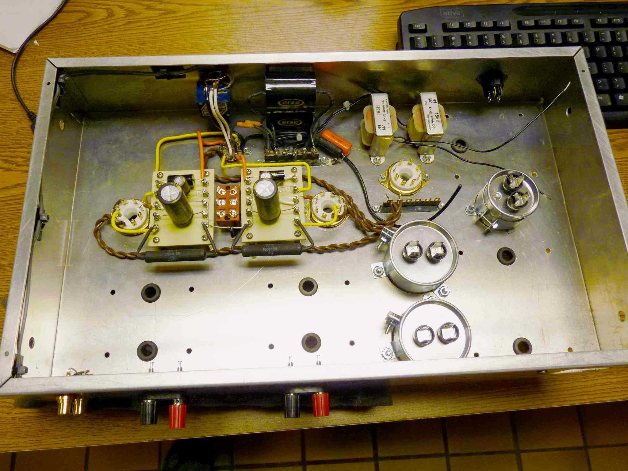

Partial Build
Here is a photo of the current build and I am documenting as I go. With this initial build I will be using the Edcor XPWR010-120/240, Edcor CXC125-10H-200mA choke and GXSE15-6-5K output transformers. I am still waiting on the custom iron and the chassis. When I complete this build I will be able to provide the basic parts kit with assembly and layout manual, less chassis, transformers, and tubes. I was able to get the price down to $299.00 instead of $319.00. I should be complete with this in 2 -3 weeks, so if you want to fabricate your own chassis and provide your own transformers and tubes this would do it for now. If you would like to have the tubes included, the price is $389.00.

I'm curious what the third motor run cap is for? I've built Mikael Abdellah's SE KT88, and it only has two ASC filter caps in the PS.

One cap is a 30uF for the first rectifier cap, and the other two are 50uF in parallel after the filter choke.

Ah, I see, I thought you had some enhancement there that I might implement in my build 🙂
Looks like a nice kit, good price too.

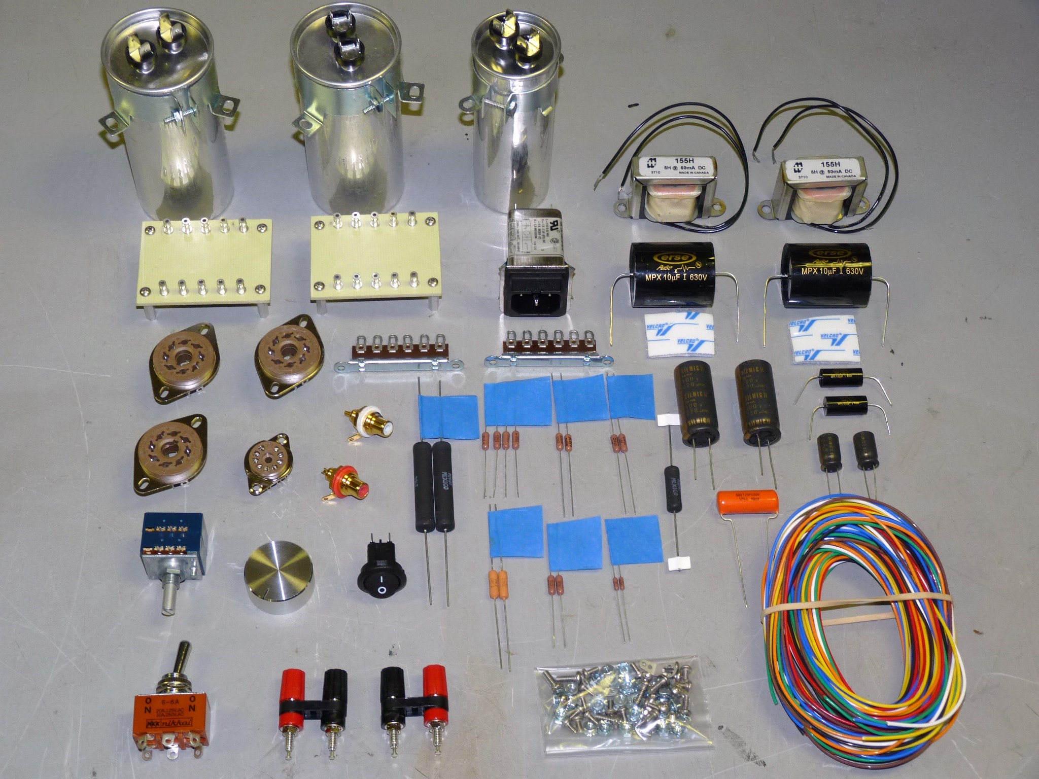

I have started receiving the parts for the amp. The chassis and transformers are being manufactured now. It won't be long, maybe 2 - 3 weeks, before I will be able to offer for sale the basic parts kits, without transformers & chassis. It looks like the chassis and transformers are going to be just after the first of the year. I need to package everything up and complete the manual.
I should be complete on the initial build using the Edcor transformers next week, which will allow me to complete the first edition of the manual.
Here are the specs on the custom lay-down transformers:
Power Transformer:
Primary: 120/240, 50/60Hz
Secondary 1: 375-0-375, 200mA
Secondary 2: 6.3-0-6.3, 5A
Secondary 3: 5-0-5, 3.5A
All secondaries center-tapped as indicated.
Filter Choke: 10H, 200mA, 500V
Audio Output Transformer:
500V-5Kohm-120mA primary, 6 ohm output, SE gap, 40% tap, 25 watt
20Hz - 20KHz, flat frequency response across band
