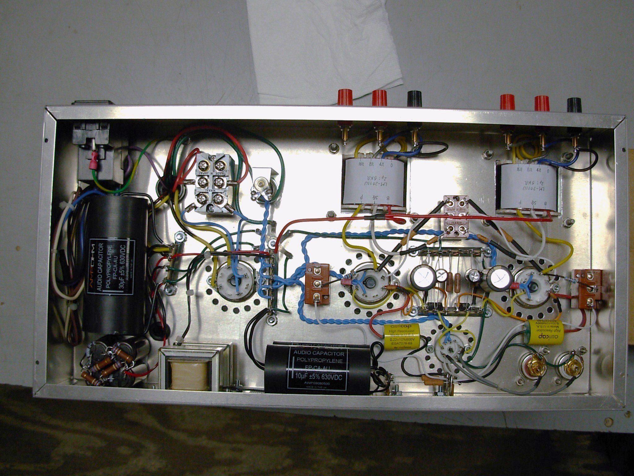

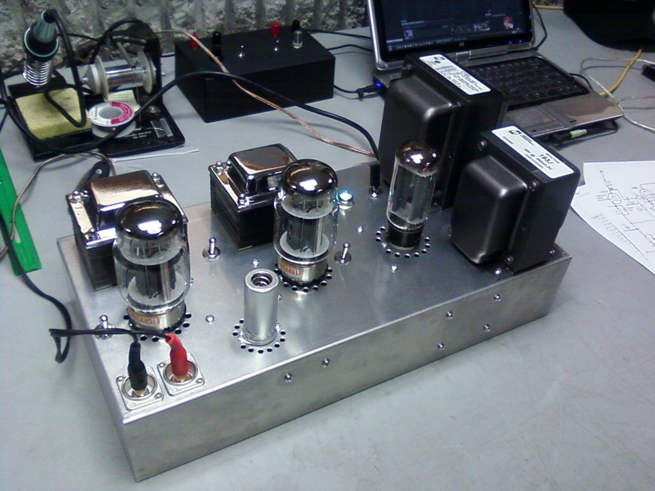

I can definitely work up pricing in a few days if there is enough interest, however the pix may be a bit difficult for what I envision as a final product. My current amp was built on a Hammond aluminum chassis using Hammond power xfmr & choke, and Mars output xfmrs. I can provide a pic of my current build however it does not represent what I would provide as an end product. I could provide an artist rendition of the final product as I see it.
In the meantime the attached photo shows what I have. The new power transformer and choke would be similar in appearance and mounting to the output transformers shown. My current build used (4) electrolytics for the KT88 B+ in a series/parallel configuration with balancing resistors to achieve the voltage rating for initial voltage surge at power up. These would be replaced with Panasonic metallized polypropylene motor-run caps to avoid the whole balancing resistor debacle.

I might be interested in a kit, its a nice looking amp!
