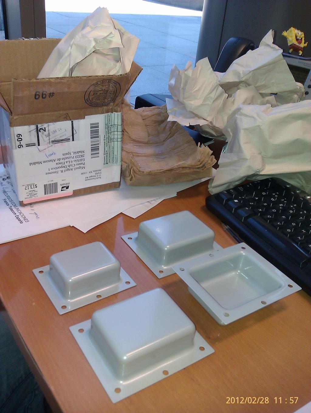

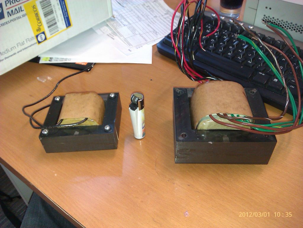

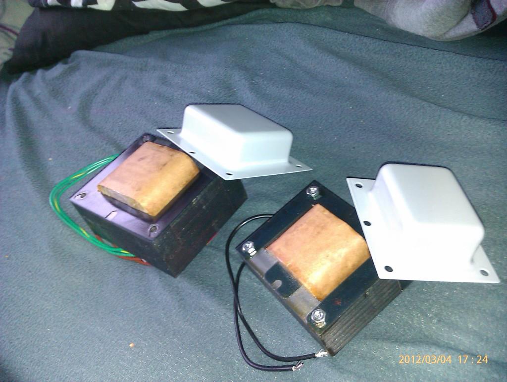

Attached are the pictures of the items as they came, when I took them out of the packaging.
1-. Transformers covers
2-. Filter choke and power transformer
3-. Output transformers

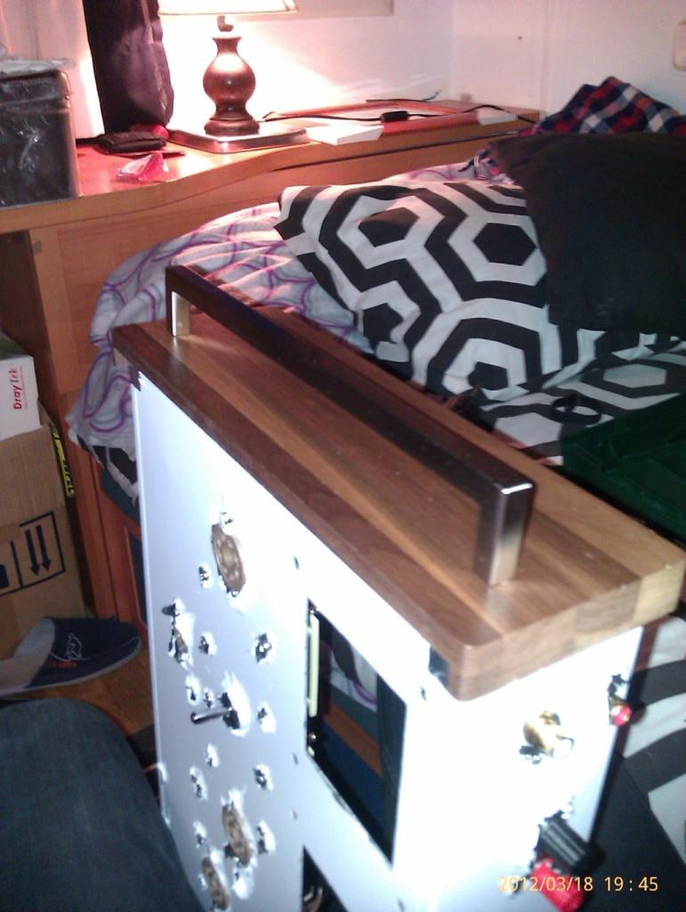

4-. One day hanging around at IKEA I saw it.... that's what my brand new tube amplifier needs! A pair of handy handles! Aestetically pleasing metal CNC finish while giving a way to hold up the amplifier: only 4€ at your nearest IKEA 🙂

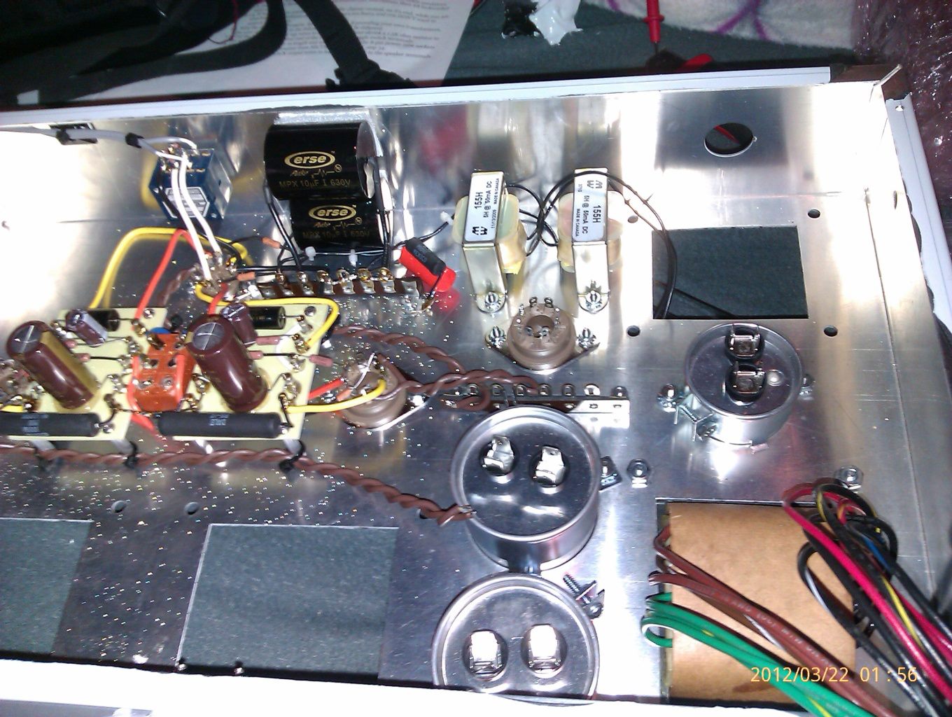

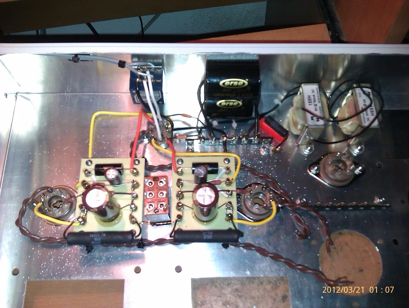

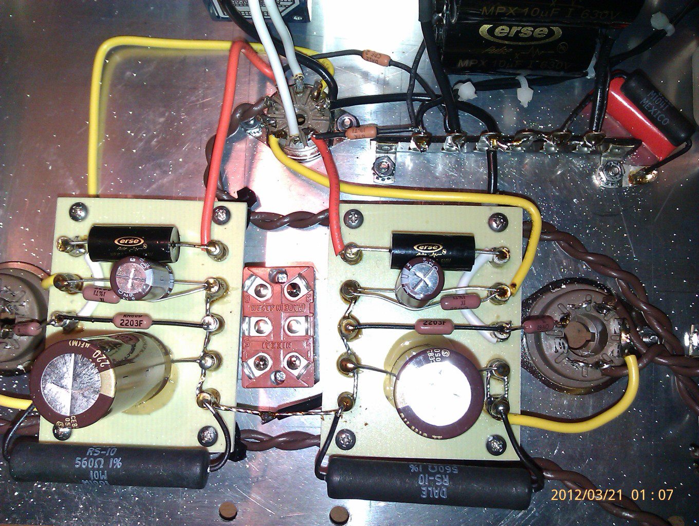

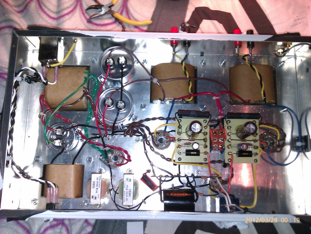

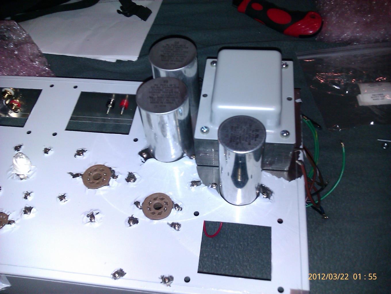

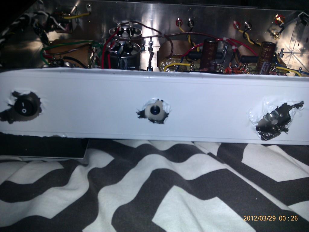

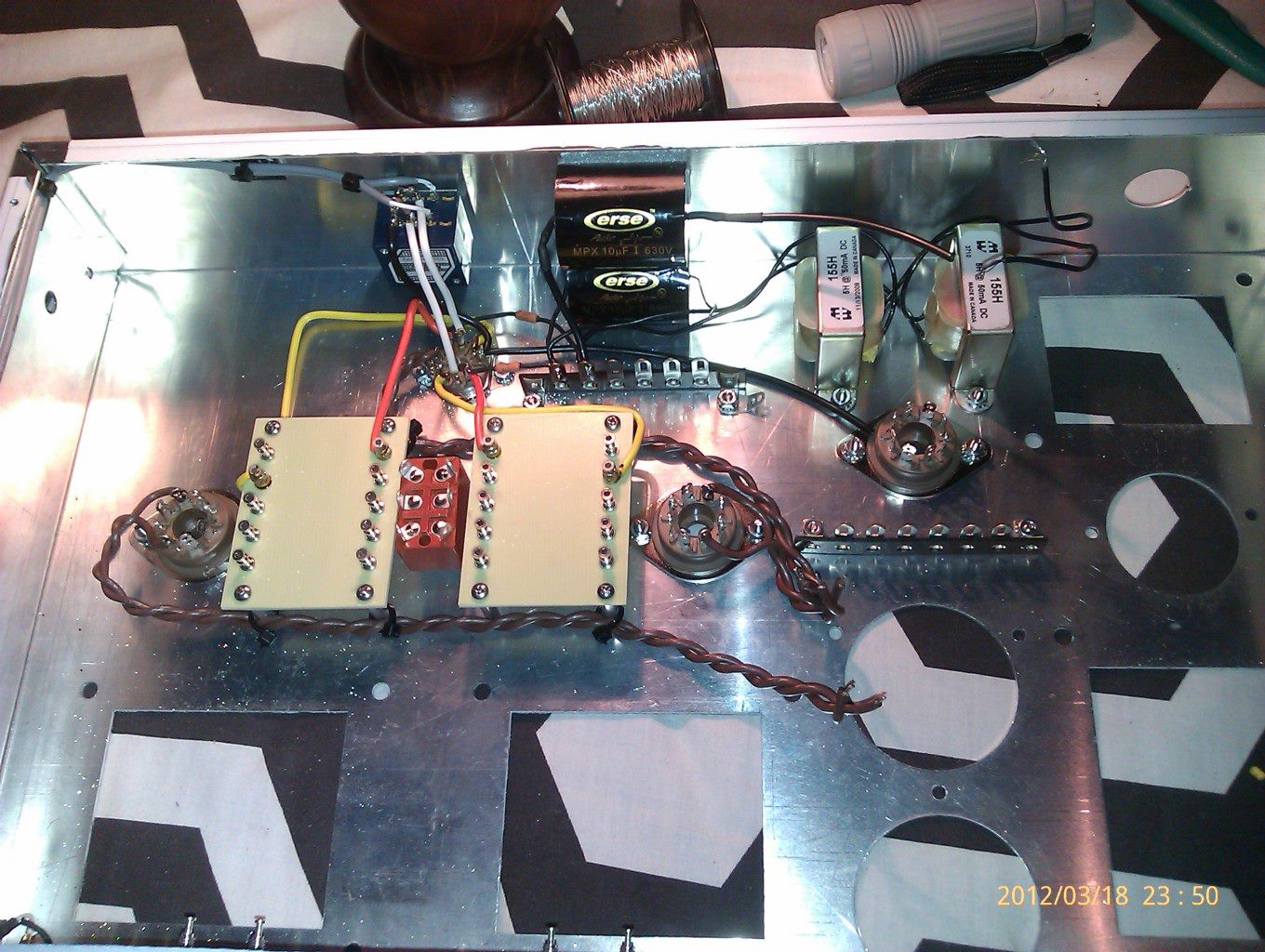

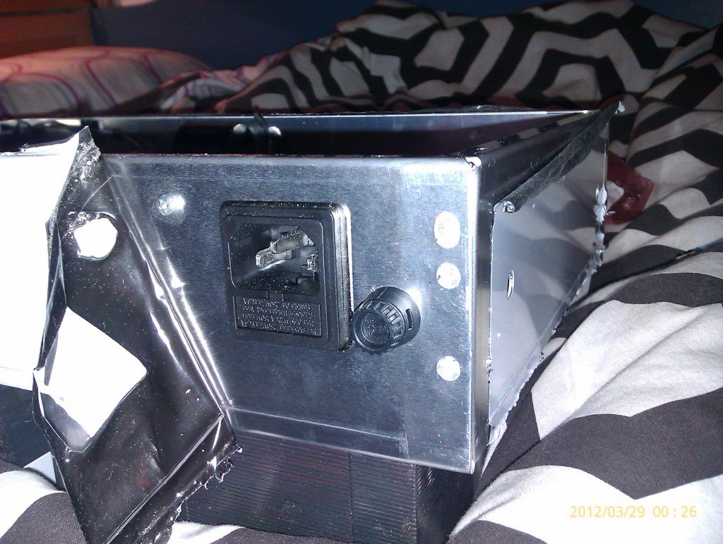

Some pictures as I went through the assembly process. I tried to keep cabling as neat as possible, all cables apart from each other as much as possible, and a quite tight twisting on cables paired (specially if they carry AC).
I have made some changes to the original assembly guide, due to different reasons:
1-. Glued not only the big 220uF capacitor, but the smaller 100uF cap against the 0.22uF coupling capacitor too. It seemed to be the only piece "dancing" in the amplifier so, why not?
2-. Neither of the transformers nor the choke are grounded. They are even isolated from the chasis by means of plastic isolators. Is it not generally recommended to ground transformer's core to Protective Earth?
I have volmetered power trafo core and... it is at 39v above ground!! quite enough to shock a wet hand if touched! The other trafos have voltage on them but not as high.
3-. I added a second fuse to the input. IT IS A GREAT FAILURE NOT TO DO IT if you live in a country where you don't know on which pin LINE and NEUTRAL are, like most european countries. If I connect it to the wall, I may be fusing the line (I don't know unless measuring with a voltmeter). If I flip the mains plug 180º, now I am fusing the neutral AND NOT the line. Which is like fusing anything.
If you live in a country where mains plugs on the wall have no polarity, it is a must to add a second fuse. Going further, it is illegal to not do it (fuse mains line). Going further, in case of failure you get a 50% chance of dying electrocuted.
4-. Another importans issue, specially when in the testing stage, is to add a permanent bleeder resistor to dicharge the capacitors. High ohmmic value enough to not suppose a considerable load to the PSU, but low ohmmic value enough to dicharge the capacitors fast enough. I can't remember the value I used, I think it forced around 1-2mA through the resistors, so make the maths assuming +400v. It takes the capacitors (with no tubes plugged) to 0v in around 30 seconds.
5-. No ON light indicator is issued with the kit, so I added a blue LED which serves two purposes:
-Giving an indicator that power is ON and the amplifier is plugged to the wall.
-Because the LED has a voltage drop of 2v, it will shut off as soon as PSU voltage goes lower than 2v (more or less). That helps to show that HV capacitors have no voltage across them.

Hi Regi,
The amp looks great. Good job. Glad you like the sound.
In reference to post #121 above, and the transformer core grounding.
Although I have been assured by the manufacturer that the transformer windings are extremely well isolated from the core, I am going to suggest the following additional safety method of mounting the output, & power transformers, and the choke to the chassis:
1. Use the plastic bushings only for the top of all transformers and choke outside the covers, as indicated in the manual. Do not use the plastic bushings between the transformers and choke, and the chassis.
2. Scrape away the varnish from around at least two of mounting holes for the transformers and choke where they come in contact with the chassis.
3. Use a star washer between the two points described above in #2, and the chassis.
I will be notifying all purchasers of the master kit with laydown-style transformers of this additional safety procedure.
With reference to mention of a second fuse: The amp is supplied with an IEC grounded receptacle for connection of AC power. I am guessing your receptacles are the grounded Schuko type? Thanks for bringing this to my attention. I will make an addendum to the manual suggesting the additional fuse for users of this amplifier with European style power receptacles.
