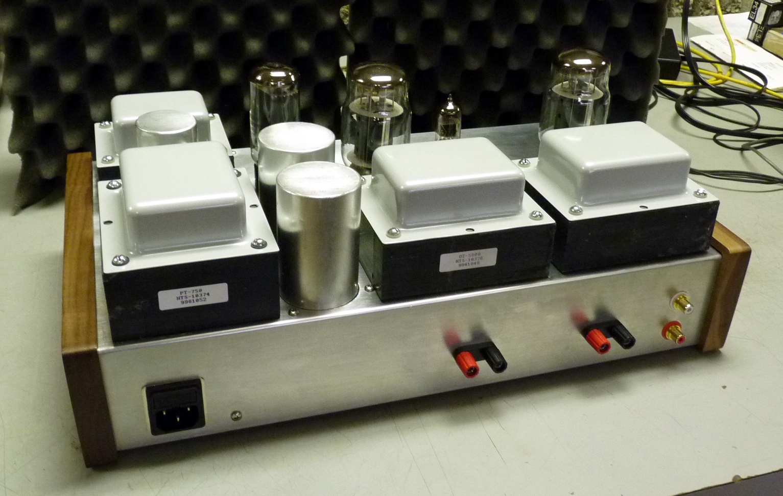

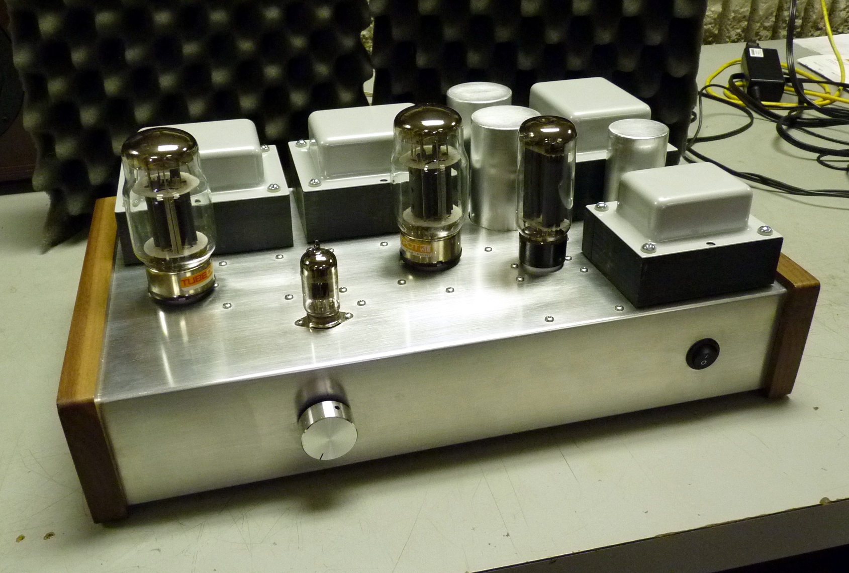

The photos of the completed amp are attached.

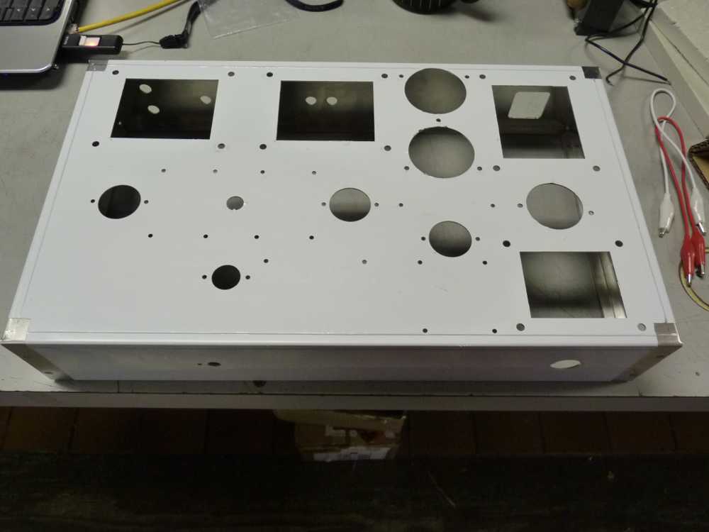

I have attached a photo of the pre-punched chassis that is included with the Master Kit.

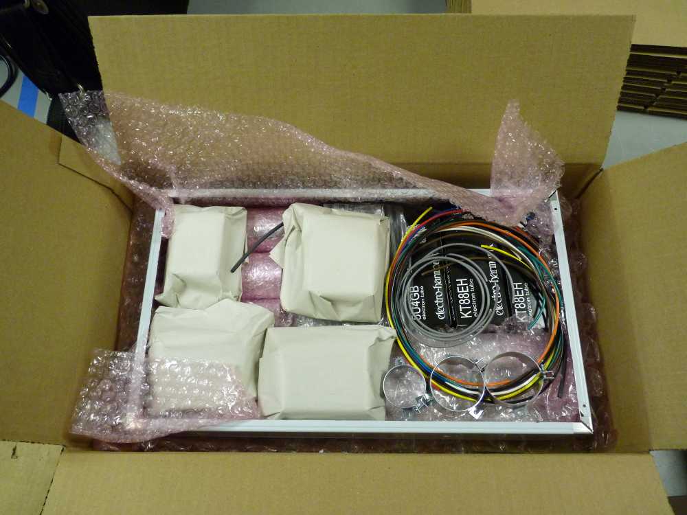

Knock on the the door, postman standing there with a box, all the way from America.
The KT88 kit has arrived intact and it's like Christmas, i must say i was impressed with the packaging, the documentation and the quality of the componants. Well done Scott i don't think i would have taken on such a task like this. I can't wait for your next project, "hint" 300b amp sounds good.
Rob
I too came home to find that the Postman had rang.... :D
He left me 2 boxes. I tore into them like a kid at Christmas! Man this amp has enough iron in it to make a small anvil! I thought the smaller box might just be an anvil. :)
Seriously, Scott did a great job packing the Master Kit. Everything arrived in perfect shape. I can't imagine how long it took him to put these kits together. Wow! All the various parts and hardware all nicely sorted into various ziplock bags.
