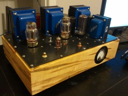

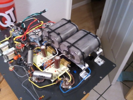

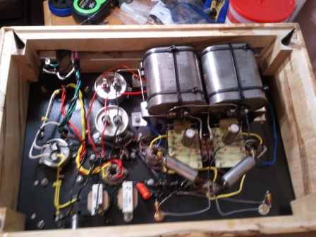

Its been a year since I first built the kit so I decided to do a rebuild with some tweaks. Heres some pics of the new version. Tweaks: led bias on driver, cap changes to PIO, and a few resistor changes. Still loving every note that sings from this amp.

Looks great! Are those giant caps in place of the 30uF plate filters?
