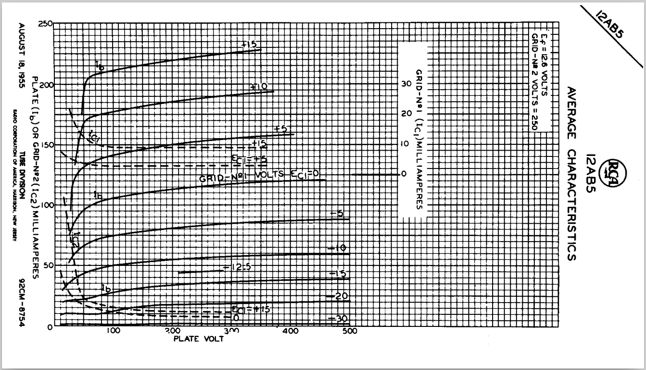

If the 6V6 is essentially the same as a 12AB5, it follows that one can expect similar behaviour from a 6V6...and it's certainly one of the few beam power tetrodes relatively easily found in a music store today.

I plan to try something similar with a pair of 12AB5s one of these days, but other shiny objects keep catching my eye first. 😱

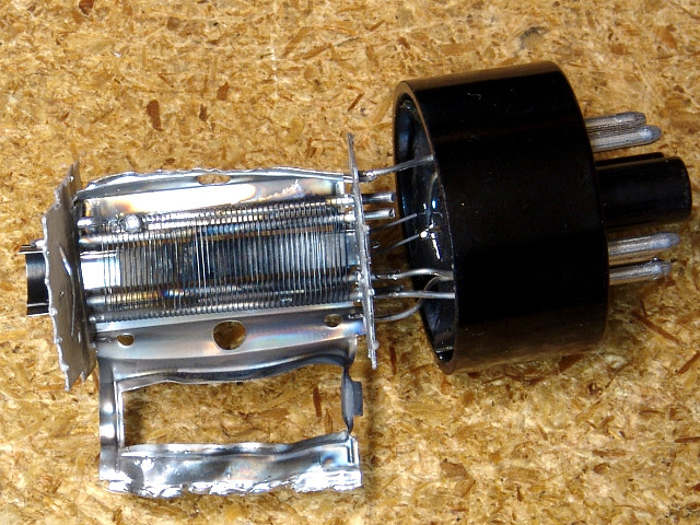

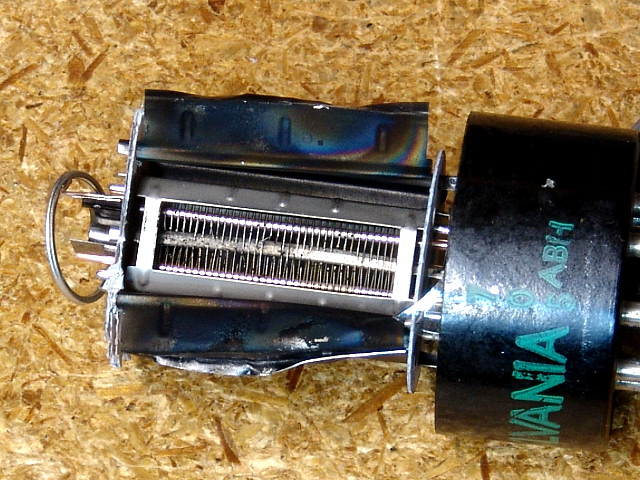

One of my most memorable experiments was when I blew the screen grid into pieces of burnt wire while extracting 120 watts from a pair of tiny 6BQ6GT sweep tube nearly 10 years ago. The driver mosfet was reduced to ash and a few other parts were dead too. That was actually done in pure screen drive. See post #5 in this thread:

If G2 gets hot enough to start emitting clouds of electrons, I am curious where they end up going.
I figured this out in post #28 of the dual / crazy drive thread. You get G2 hot enough to glow while pulling that plate down to near zero, it stays hot when the plate zips up to 2 X B+ and BANG!

This what a 6V6 looks like inside after trying to make 60 watts per pair. This 6BQ6 was another casualty, sacrificed at 125 watts to understand whey they blew up in overdriven screen drive.
