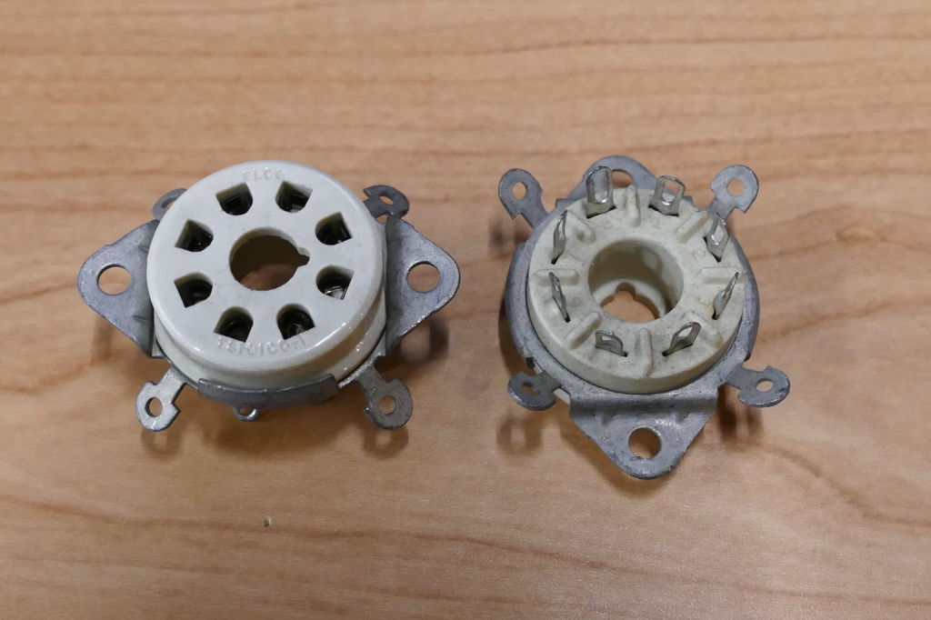

And against that, all I have is proper fusing and good NOS ceramic sockets? I'm starting to see the problem.That design will work, but expect to see somewhere over 4,000 volts on the tube sockets and OPT when you "set the controls for the heart of the sun." Peak power will be over 150 watts at about 40% distortion.
Does "the same thing" include similar stress on the sockets and OPT, or is there some relief from backing down to 450 V?I can do the same thing on a bit over 450 volts with a 3300 ohm load and AB2.

All the same, I'd like to know what they're using for sockets. Would be dissapointing to find out that it's the same thing you can buy off the interent for our purposes.
...There are "high voltage" octal sockets for TV high voltage rectifiers at ~25k volts....
Usually a 25KV TV rectifier has the 25KV on a plate cap, not in the socket.
"Damper diodes" are different. 6AU4 is rated for 4500V on an octal socket, but the pins next to the plate pin are omitted, and normally we'd also omit the socket contacts so as not to leave a stepping-stone for the 4.5KV.

KT-88s at 800V? No problem. At 2000+ V? Yeah, that's a problem.
The internals of most tubes can handle plate voltages well beyond the specs. It's the bases and sockets that are the problem. When the first "power tube," the 6L6 was introduced in 1939 it was given the same base hookup that had already been used in other octal output tubes. Nobody ever envisioned kilovolt level voltages on the plate. When kilovolt versions were needed, the tube makers simply stuck a cap on the top, and rewired the base. These are the 6BG6 and 807.

I'm trying to see if there are sockets rated for high voltage that will fit KT-88s
I found a box of NOS ceramic sockets in a military surplus store maybe 35 years ago. Those are what I use.
