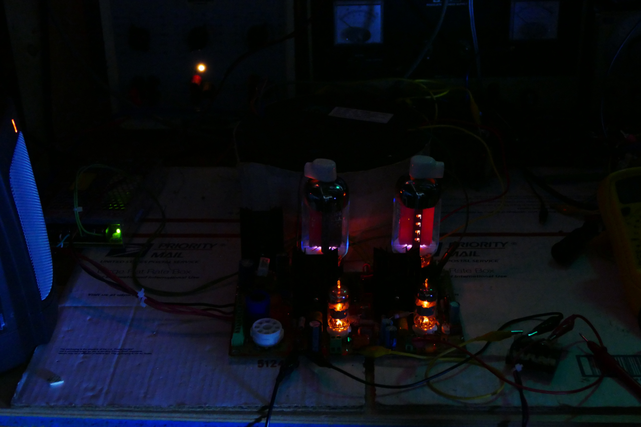

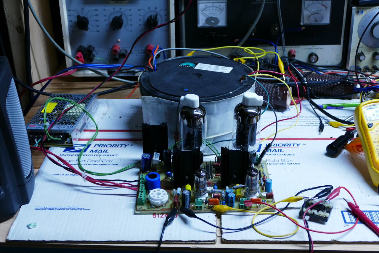

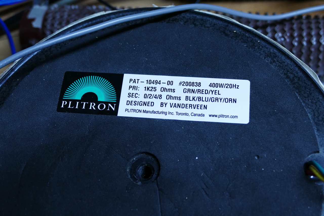

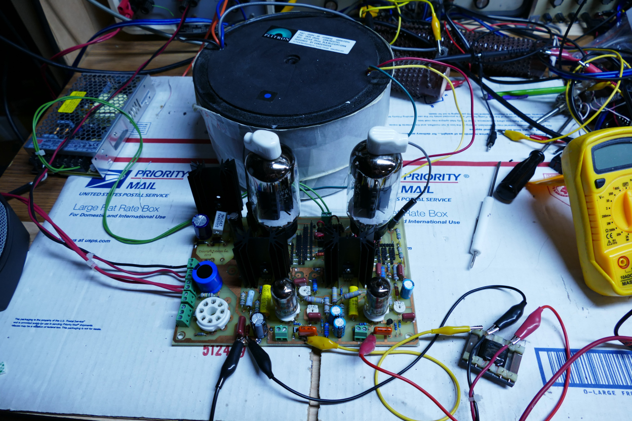

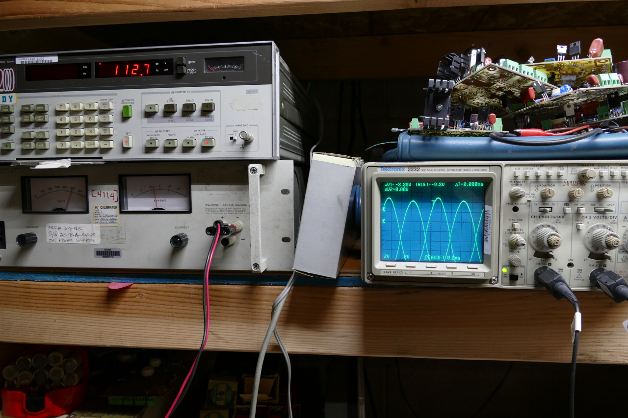

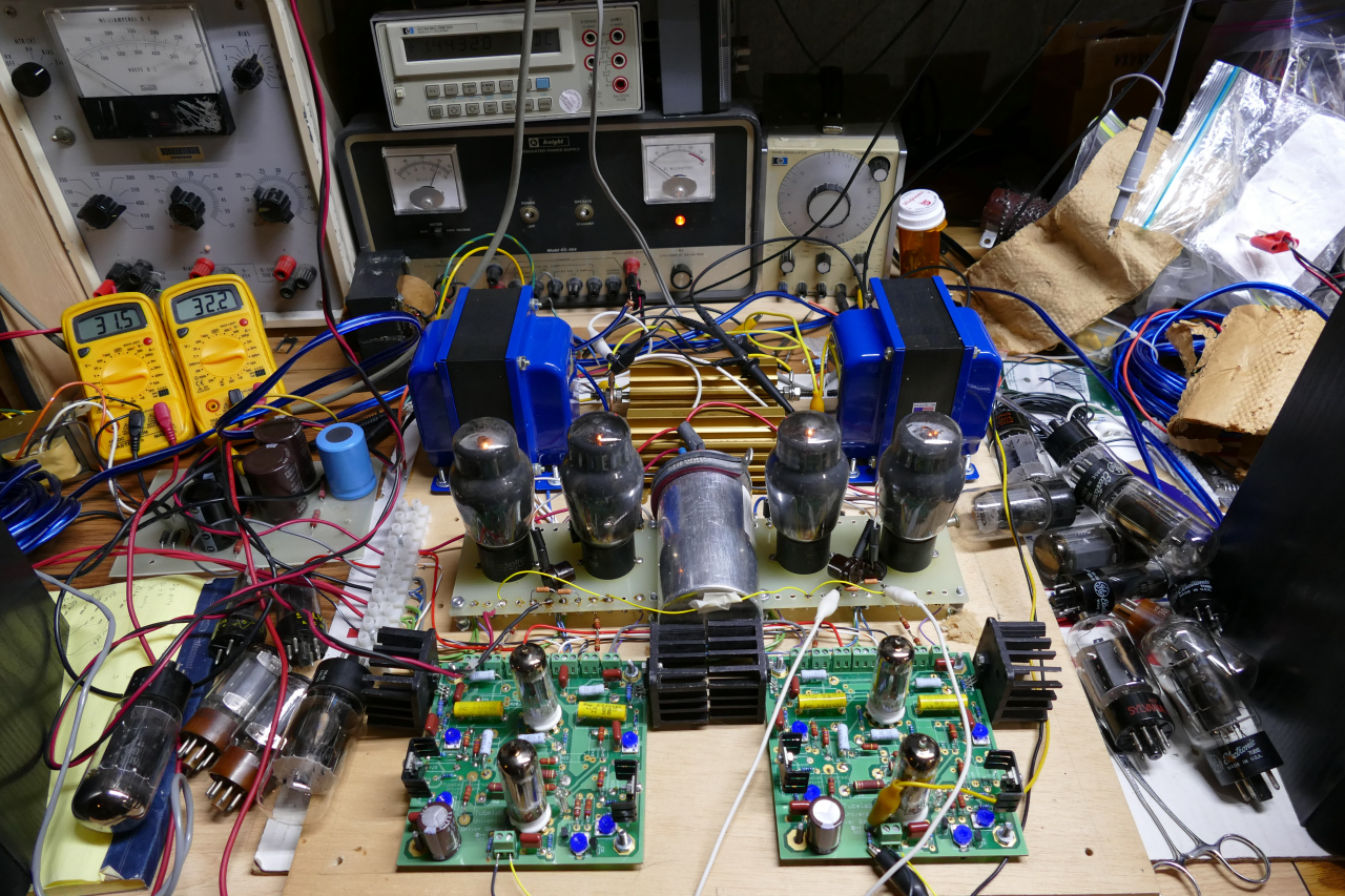

It's been over a year since I posted into this thread. During that time I have been exploring the upper limits of tube amp power working toward building that 1 KW vacuum tube HiFi amp before I get too old to move it. In this effort I have found new ways to blow stuff up.....yes I made vacuum tube EXPLODE, not once but twice.
To squeeze maximum power from a pair of tubes the plate efficiency must be improved so more of your power supply energy goes into the speaker instead of making the plate glow red. The simplest way is to use a high purveyance TV sweep (line output) tube that has a HUGE cathode with far more electron emission that could ever be needed. These can indeed pull their plates down into the 10's of volts range while passing nearly an Amp of current.
If one is convinced that common audio tubes must be used, the next best alternative is to use AB2 operating conditions. How much can AB2 help? How much power can a pair of 6L6GC's put out? Conventional wisdom says about 50 watts per pair. I was running a bunch of tubes through my test amp one day when I put a set of vintage grey glass 6L6G's from the early 1940's into the amp for a listen. These sounded good, and loud, so I measured the output power. I was surprised to read 70 watts at 1.6% THD (pictures) .

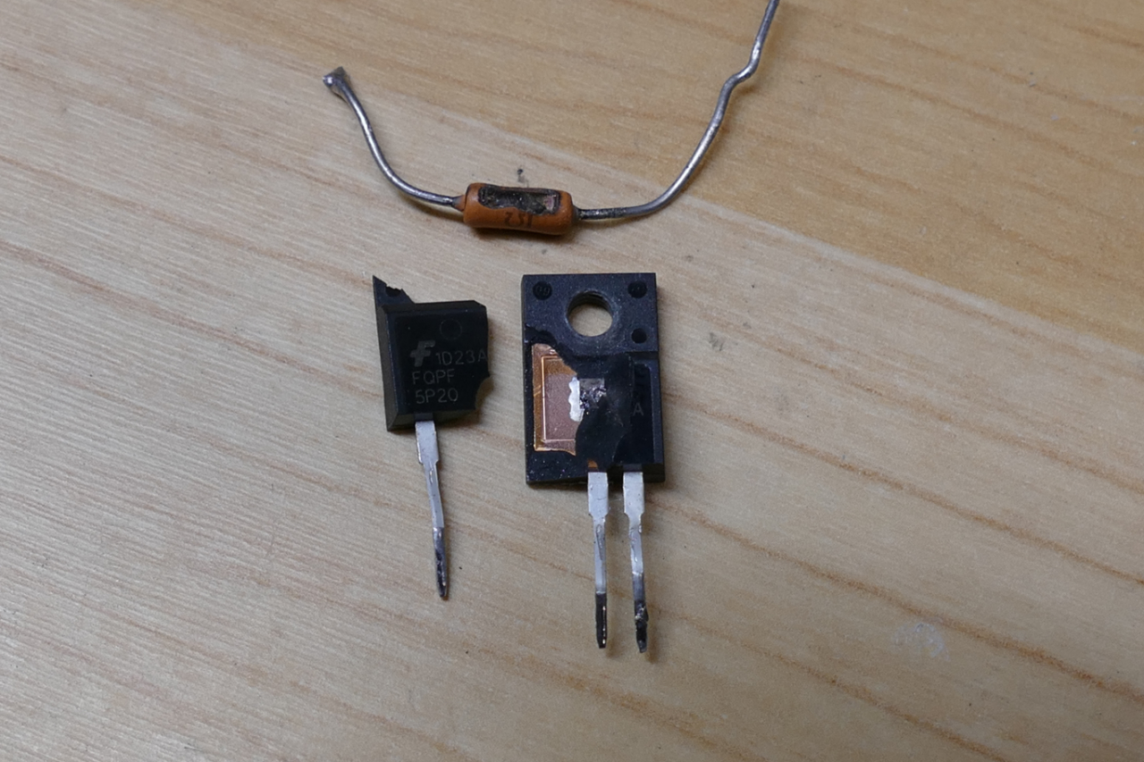

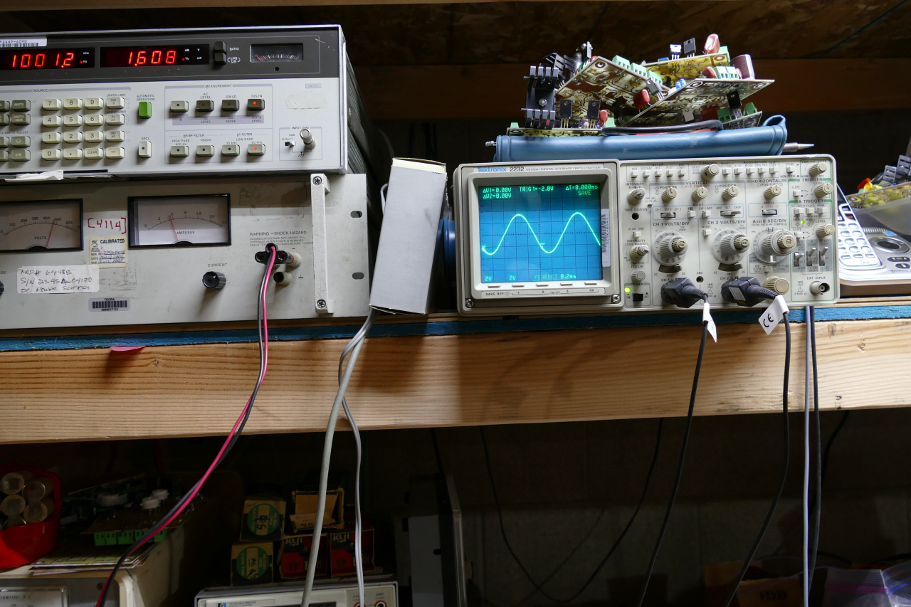

Not wanting to risk these rare tubes I stuck in some clear glass 6L6GA's from the late 40's, and leaned on them. These crusty looking tubes were probably 75 years old. I just kept turning up the knobs and the wattmeter kept climbing. I was above 100 watts from a pair when I took this picture. The next picture shows 112.7 watts at 5% THD. I decided to push things a bit farther when there was a loud bang and the fun stopped. I was at about 120 watts on 525 volts into 3300 ohms when this happened.......not bad for 75 year old 6L6GA's.

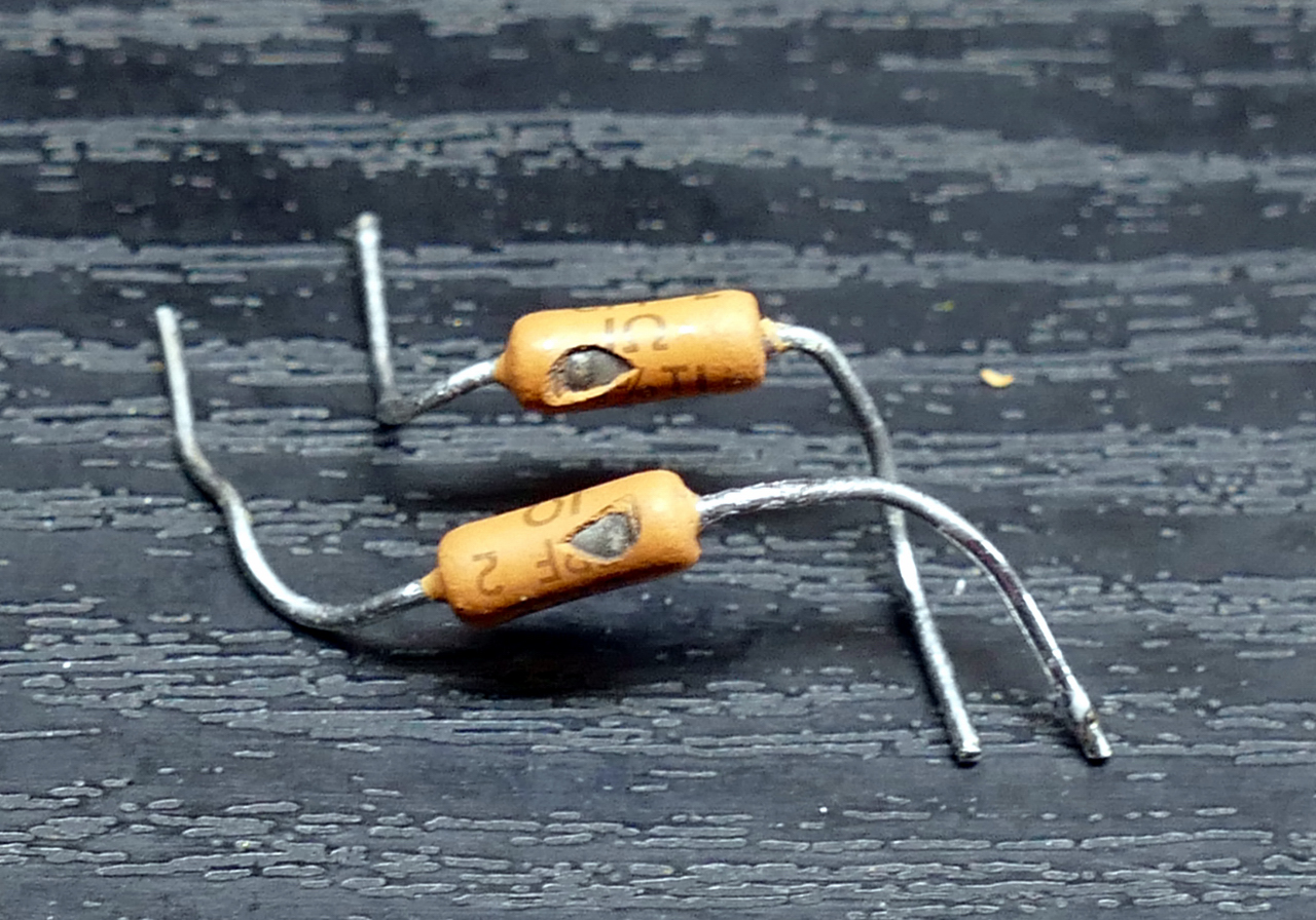

Autopsy revealed that the 1 ohm 1 watt cathode current sense resistor had exploded. That was the only failure. I replaced the resistor and turned it on to reveal the the tubes were still alive, so I cranked it up again. The results were the same, Somewhere around 120 watts the cathode resistor exploded again.
I decided to set the power supply back to 500 volts, hook up the speakers and listen to this amp for a few days. No ill effects were found in the sound, or reliability….. So what happened.
Further experiments with different tubes led me to believe that this failure mechanism is a tube arc. If you try to extract more electrons from the cathode "space charge" cloud that are available a localized arc can occur. This is not unlike secondary breakdown in a semiconductor device. If the current is limited to a low enough value (obviously over an amp in this case) the tube may lose a chunk of it's cathode coating, but otherwise survive. If enough current flows the tube WILL explode, more on this later.
If a pair of old 6L6G's can deliver 70 watts, or even 100 watts, what can bigger tubes do? My biggest pair of TV sweep tubes can do over 250 watts and sustain that for several minutes continuously. The screen supply failed on a push to 300 watts. I will probably use 3 pair in the 500 WPC amp for safety margin.
I must go now, but I'll post more later.

Quit teasing us, I want to see some broken glass!
So, I am in the middle of developing a new topology I call the Compound Electron Device which is used in a new amp I call the UNSET (SET with no true triodes), and will be used in the 500 WPC monster. It allows TV sweep tube to make pretty triode curves without violating the screen grid ratings.
I might have two engineering degrees, but math and I don't get along too well....ditto basic arithmetic. I wire up a 6HJ5 which is a 24 watt sweep tube to a mosfet and set up the test to plot the triode curves. I set up the pulsed test to run the tubes up into the 40 to 50 watt range. I tend to do the high power tests first, but I was surprised to see scattered mosfet, cathode resistor, and a cracked tube on the initial test.

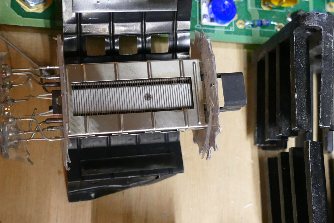

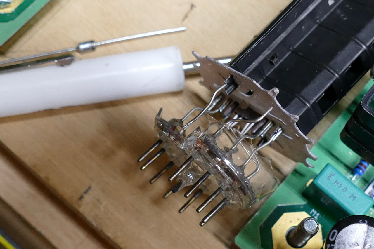

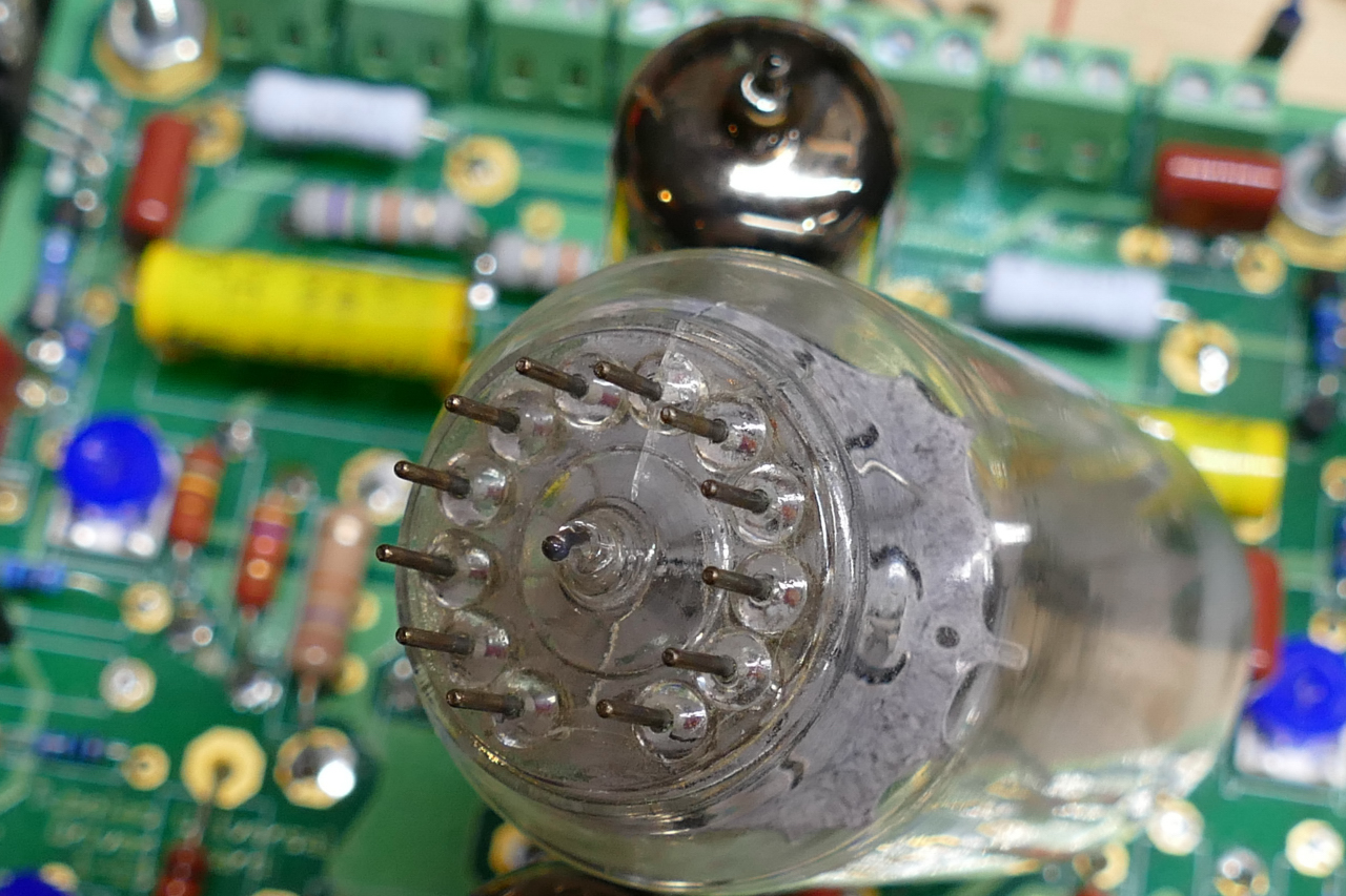

Not quite understanding what happened, I simply replaced all the dead parts and tried again. This time the tube scattered itself all over the bench and floor........OK, the dumm blonde one stops to think and realizes that 400 volts at 1 amp is not 40 watts! The big azz power supply I use for these experiments is an old style 60 Hz switcher with 1000 uF of capacitance right across it's output. The stored energy in this monster can make stuff explode and turn an OPT into a magnet.
The peak current pulse that went through the plate and cathode pins cracked the glass on the first tube and scattered the mosfet in the cathode circuit. When I rebuilt, I used a bigger mosfet. The pulse blasted the glass on the second tube and made the current sense resistor disappear. Note the absence of a plate pin. It was still in the socket.
The plate of the shattered tube was peeled back to reveal a spot about 4 mm in diameter on the cathode where the coating was gone. This is where the tube arc occurred. All the tube current was concentrated in this small spot. I believe that the shattering was caused by the plate lead being blasted in half right where it passes through the glass.

I recently took a prototype UNSET board and fed the two channels out of phase using a small Edcor transformer as a phase inverter. The balance was not perfect as can be seen in the tube color. I wired a BIG OPT across the two channels and dialed back the idle current out of class A. I then explored the upper limits of power. The picture was taken in a dark room after the board had been cranking out 250 watts for several minutes. The right tube is fed directly from the audio oscillator while the left one goes through the transformer and gets a little less drive. Attempts to get 300 watts blew the screen regulator on the UNSET board. More testing soon!
or perhaps a molten glass taking the shape of the plates....
I did that once by accident when I worked in a TV repair shop in 1969. Unfortunately the 6KD6 got real hot real quick, so I yanked the power cord. Then the tube cooled and soldered itself into the socket. I broke it trying to get it out before the boss came back.
All attempts to recreate this effect have failed. Either I get blown tubes or the tube goes gassy and glows blue, then the heat dissipation drops. I did manage to apply enough power to a blue monster to make the glass bulge outward! The technique used is the same one that I used in high school to win a bet with the teacher. I made the outer envelope on a metal 6L6 glow red....and stunk up a whole wing of the school in the process.
