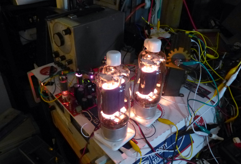

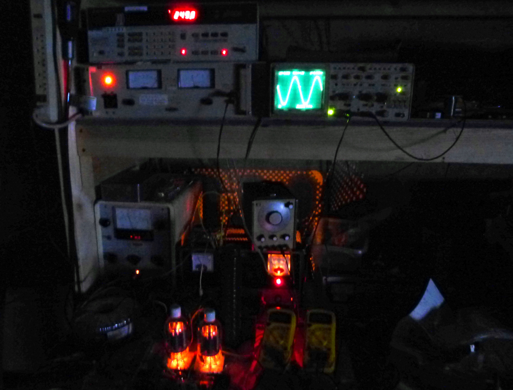

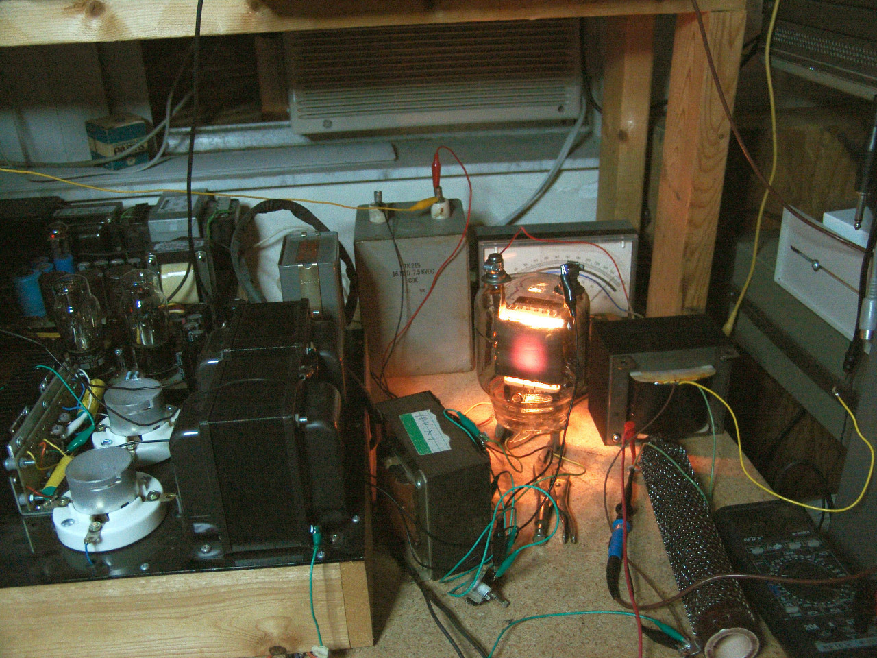

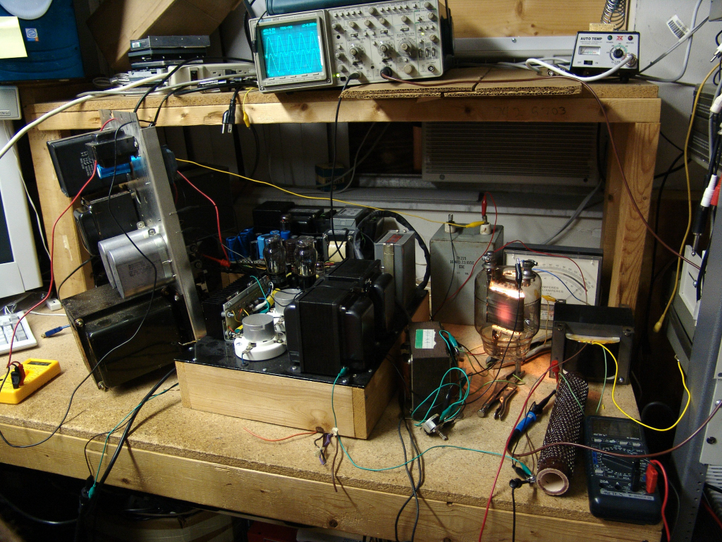

I was considering making a monster Single Ended stereo amp with these about 15 years ago and I paid a well known transformer winder some $$$$ to make me a test OPT. It wasn't quite good enough for HiFi, so I plugged my ADA MP-1 into the test amp and annoyed my neighbors with a 200 watt SE guitar amp that sounded like a Fender Champ on steroids.
This thing was an exercise in UNSAFE practices with vise grips and hose clamps serving as a tube socket, 1500 volts at 300 mA passing through a Radio Shack clip lead, and powered by the power supply from a Motorola radio transmitter made for a police station. This thing took over my entire workbench, and existed for only one week. I had a Lexan "blast shield" between me and the amp whenever it was on (except for a few photos), mostly since touching anything on the bench could have been fatal. There was also a fire extinguisher at my feet during testing.
During the "testing" nothing blew up, but I did blow the 15 amp bench breaker twice by doing speaker to guitar feedback. The low frequency growls with the whammy bar were what dimmed the lights and blew the breaker.
I still have the parts from this test a long time ago. Will I ever make that "Uber Champ"? I don't know, right now the 4 watt tube amp I built is loud enough.

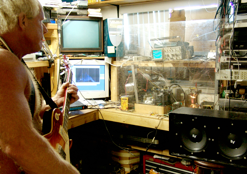

found ways to shift the timbre of their instrument up so that it would "cut through" the band's sound. Wasn't any louder, but you could hear it better.
If you notice the CRT monitor in some of the pictures you will see a spectral plot of what's coming out of the amp. Each of the vertical lines represents a single tone, or musical note. Each is at a specific frequency in the human hearing range. Even though only one to six notes ate being played, each has harmonics and they all intermingle in this highly distorted amp chain.
If you want to be heard over all the other sounds in the band, you make a similar plot for each sound source in the band, then tweak the timbre of your "instrument" to occupy the empty spaces that are not being served by the other instruments. Ideally you would do this with much cleaner notes than these. These photos were taken with the ADA MP-1 set on a preset I called "Jimi" and it is already "cranked" in the preamp. Then it gets fed to the power stage which is dialed way beyond "11."
This is also why a distorted amp sounds louder than a clean one. There are many more tones present in the speaker, and therefore much more stimulation to the ears, that a "clean" amp with a few tones. The combination of these many tones is what gives a guitar amp its characteristic "tone" or "sound."

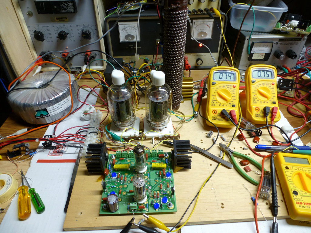

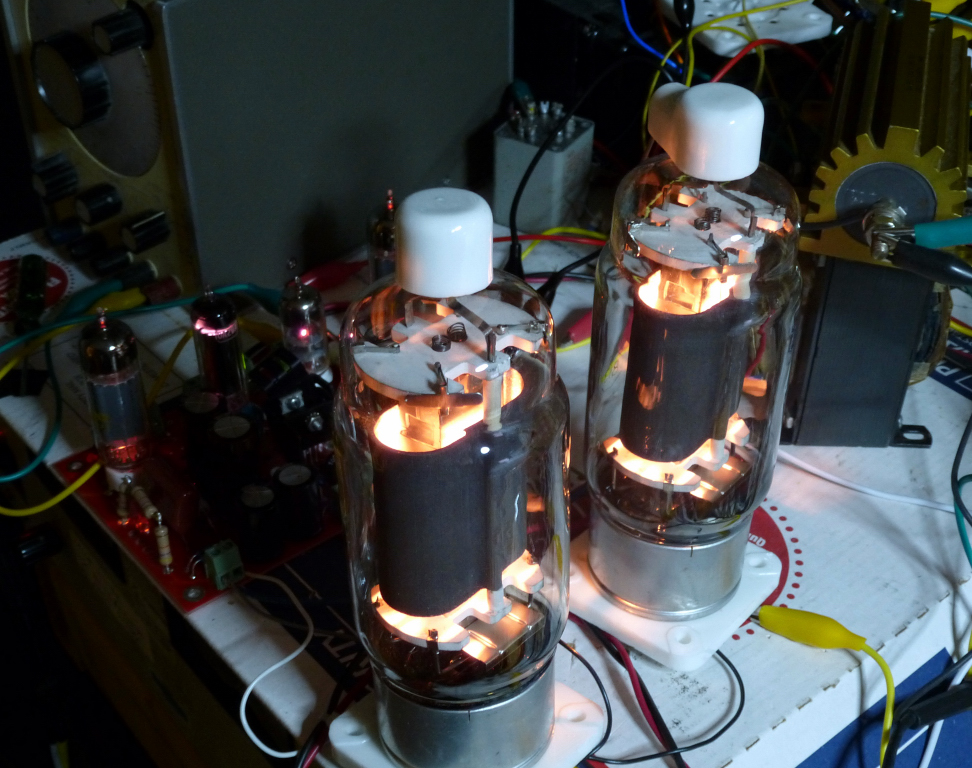

That amp has 6 X 6550's. That's 104 watts from a pair. I have done that with some really cheap Chinese KT88's.....and they are still alive.

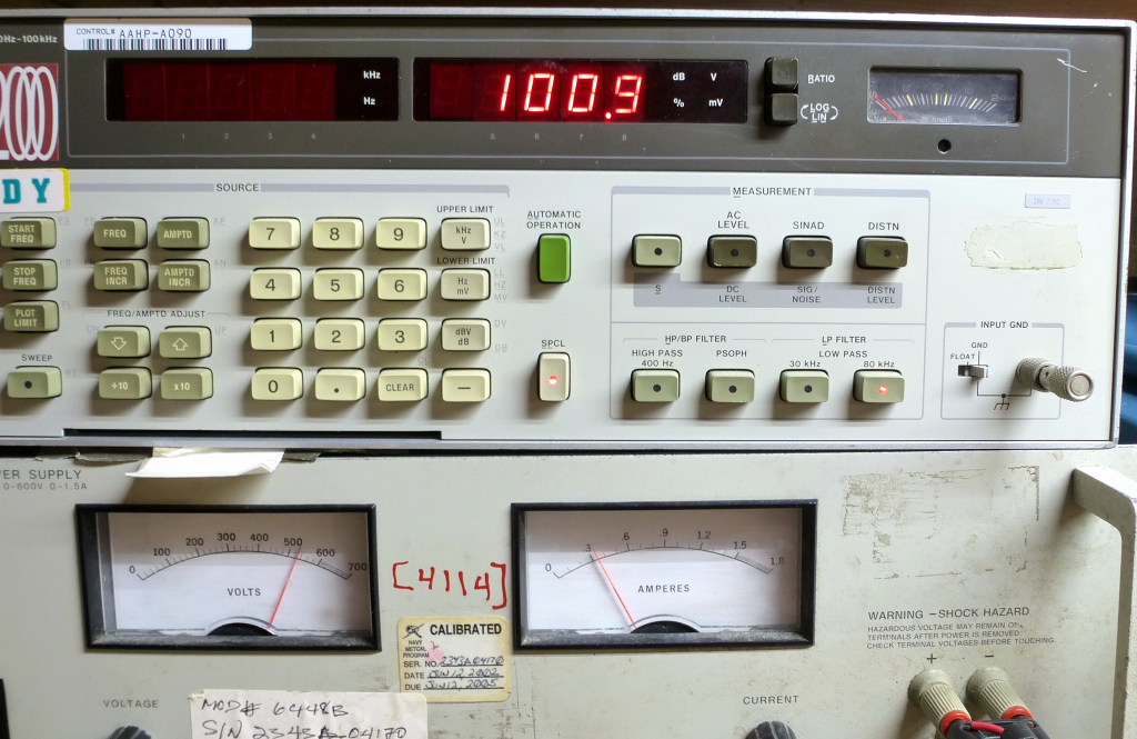

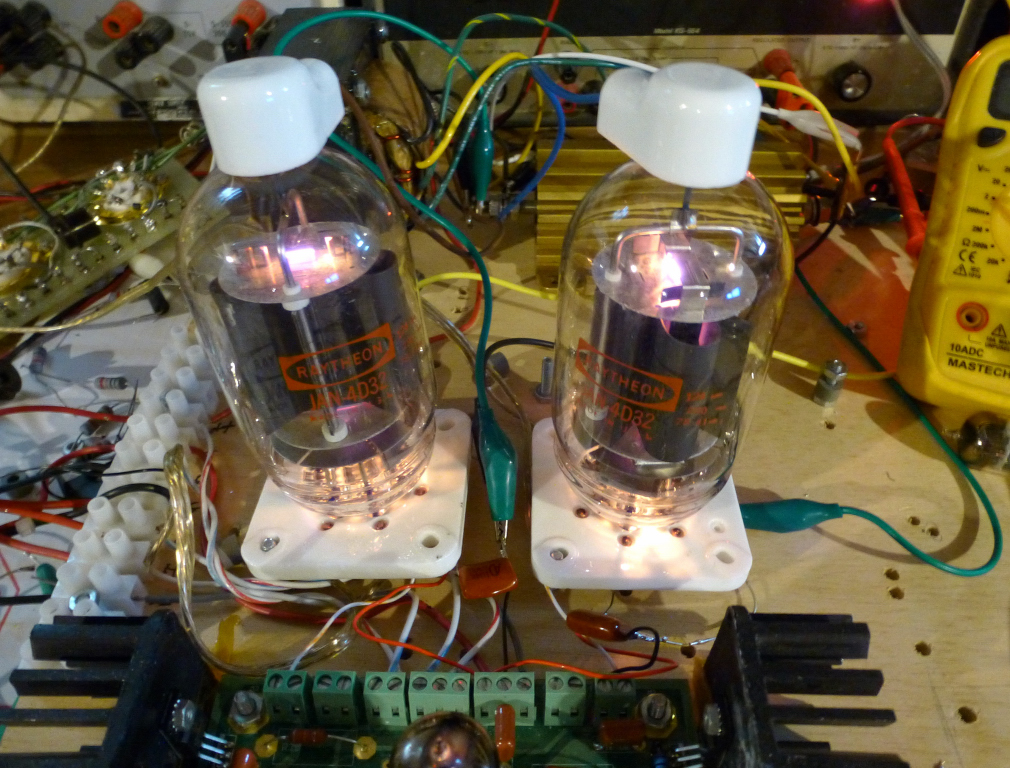

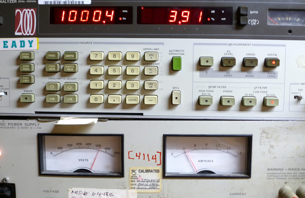

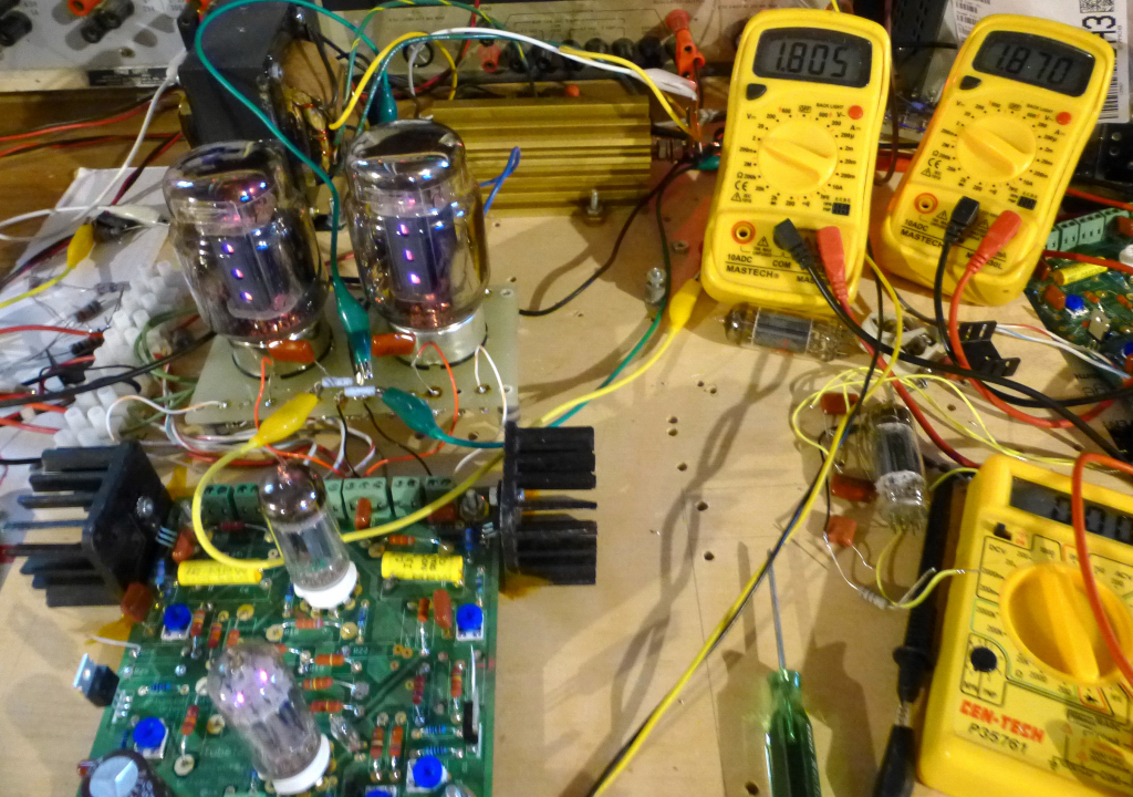

I bought about a case and a half (100 tubes per case) of some Chinese KT88's in the mid 1990's when they first started importing them here. A popular tube seller decided to quit carrying them after nearly half of those he sold came back, dead....or worse. I bought his remaining stock, cheap (about $5 each I think). I had been using Sovtek 6550WA's in my amp designs. They ROCKED, and I still have a few. The Chinese tubes blew up at 35 watts on 430 volts. This was the first time I ever saw a tube spark out so bad that it shattered. I graded out some good ones that didn't blow up and still have 5 good ones I think.

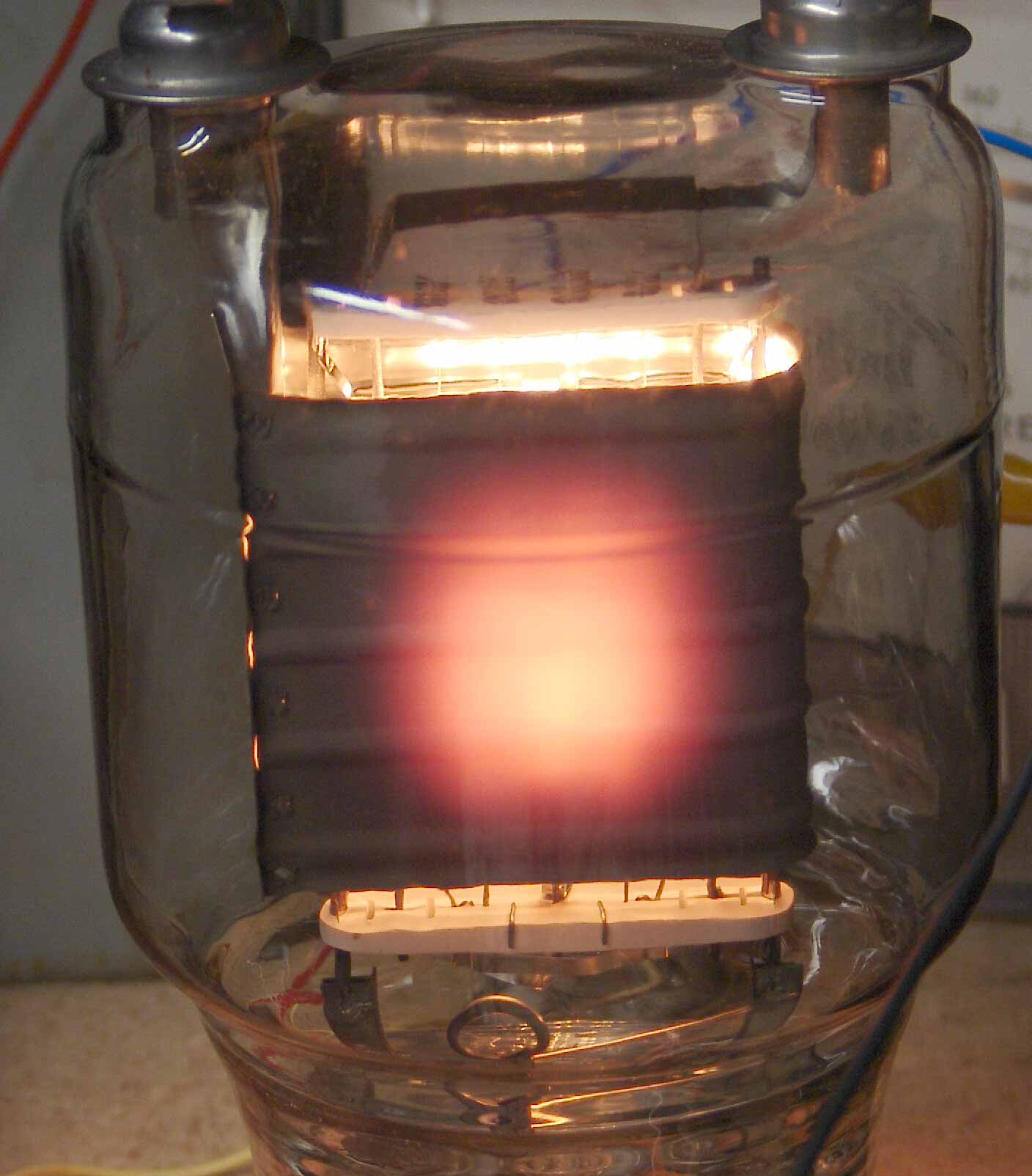

I popped a pair into a test amp. And cranked them up to 100 watts where they made 3.9% THD. Load impedance was 3300 ohms and the power supply was making 520 volts and 300 mA. That's 156 watts of DC power going into the plates, and 100 watts of audio coming out. That means 56 watts is burned in the two tubes, for 28 watts plate dissipation per tube.......well within spec!
Note that the camera I used in these pictures picks up infrared and shows it as a pinkish purple.

I have positive grid current of 11 mA and grid voltage of +12 V....11 mA makes the grids grow?
No, any of my attempts to fix the crossover distortion with different resistor values, or some idle bias applied to the driver transformer CT is what caused the grids to glow.

To get 100 W from 520 V B+ and 3300 ohms load, I need Ea to swing all the way down to 113 V and Ia all the way up to 493 mA. Is that right?
I don't know how you got those numbers, but they are within a fraction of a percent of my "dumb blonde arithmetic" numbers.
First off, the old Chinese KT88's that I have were prone to blowing up. I used them in HiFi and guitar amps back in the 90's and found that poor internal alignment caused the screen grid to overheat, or just come apart, unwind and short out other stuff inside leading to sparks and burnt parts. I found that to make these tubes live the screen grid needed to stay at or below 300 volts, so that's where I used them. I made HiFi and guitar amps that had a B+ voltage of around 400 volts or 430 volts depending on which power transformer I used. Output power was 30 to 45 watts.
When I performed this test about 2 years ago it was the first time I pushed these tubes beyond 50 watts, and I decided to quit while ahead of the game at 100 watts. I simply turned up the B+ voltage and the drive until the power meter read 100 watts then stopped. That took 520 volts. Neither tube had plate or screen glow at that point, but I didn't go further since these guys were known to spontaneously go off.
So, how do I figure out the power / current / voltage / dissipation / efficiency stuff? I learned how to do all this long before I knew what a load line was.
Most of what I used for OPT's in the early days were repurposed power transformers from the trash, or oddball transformers from military scrap. I would hook one winding up to my trusty Lionel train transformer and figure out the winding turns ratio. The impedance ratio is the square of the turns ratio. Most repurposed power transformers (HV winding is primary, series wired heater windings drive speakers) have a high ratio, so multiple speakers were wired in parallel to drop the load impedance. Knowing the P-P load impedance it's easy to figure out the rest.
We want 100 watts from our 3300 ohm OPT. Multiply the 100 watts times the 3300 ohms = 330000. Then take the square root of that number = 574.5 volts RMS. That is the RMS voltage needed across 3300 ohms to make 100 watts. Multiply that number by 2.82 to get the Peak to Peak voltage across the OPT primary (1620 volts). divide this number by 2 for a single ended amp, and by 4 for a push pull amp to get the peak voltage across the OPT in SE, or one half of the OPT in a push pull amp (405 volts here). So with the CT sitting at B+ (520 volts) and 405 volts across the half primary, the tube has 115 volts on its plate. That 405 volts across the 825 ohm half primary will draw 491 mA through the tube.
looking at the plate curves for a GE 6550, it's easy to see that you can't get there from here. When The plate curves for G2 = 300 volts round the corner around 425 mA and you can't get to 491 mA. The only way to get here is to increase the screen voltage, or increase the G1 voltage. There are no curves for either on the 6550 or KT88, so what do we do?
We already know that G2 is dissipating power, and it is near the explosion point with my cheap tube already.....note the dashed line on the plate curves. That's the screen current, when that plate is being pulled down near 100 volts G2 is starting to eat a lot of current at 300 volts, Attempting to pull that plate below 100 volts sends G2 up into the 100 mA range where it will self destruct. We don't want to feed G2 any more voltage, so we draw some imaginary lines for G1 = positive, or just test and measure current. A little positive voltage on G1 (AB2) will go a long way to cool off G2. It improves efficiency too by pulling the plate lower.
Note that we assumed that our OPT was perfect.....100 watts into it became 100 watts out. In practice, real OPT's are in the 90 to 95% range.
It's also possible to work this formula backwards......If I had the perfect tube that could pull its plate all the way down to zero volts, how many watts can I get? With our 3300 ohm and 520 volts example.....520 X 4 = 2080 P-P volts / 2.82 = 737.6 RMS volts * 737.6 = 544054 / 3300 ohms gives 164.8 watts.
You will lose some of that in the OPT, so there is no way to get more than 150 to 155 watts from a pair of ANY tubes or a dozen of ANY tubes on 520 volts with a 3300 ohm OPT. That 737.6 volts across the OPT half will draw 894 mA through the tube. You need a tube, or several tubes that can support this current, while still drawing its plate down to near zero volts.
That's how I'm getting 100 watts from 3300 ohms on 520 volts.

In my youth I made HiFi and guitar amps from TV sweep tubes because they were easily obtained for free from discarded TV sets. Some were really loud, but I had no means to measure power other than a VTVM across the speaker leads, which gives rather meaningless and highly inflated "guesses."
In the 90's I made amps that were often sold, and as the OP states, if you want to sell it, it has to use tubes that you can buy at a guitar store, so that limited my power levels to about 75 watts per pair of Sovtek 6550's or about half that with the Chinese tubes. Many of my amps were simple singled ended designs based on the Fender Champ. I called them Turbo Champs at the time.
I had made a test load that used 4 X 8 ohm "non inductive" white cement resistors from Radio Shack all clamped to a fairly large heat sink in series parallel for 8 ohms total. This worked well, so I used it for years.....
...until I stuck some large TV sweep tubes into a dead RF amplifier that used a 600 to 120 volt industrial control transformer in reverse as a power transformer. Unloaded B+ was in the 800 volt range. I wired a rather small (80 watt) OPT up to the tubes and started cranking it up. I was using an HP331A to measure the fun and somewhere beyond 160 watts, one load resistor shattered, and it's mate simply went open. At this point the OPT burst into flames, and the HP331A fried (smoke). Before I could recover from the panic, the diodes in the power supply shorted, tripping the breaker in the panel, and ending the fire dance.
There was a previous incident involving some computer power supplies that left parts of an electrolytic capacitor embedded in the ceiling. This left a large burnt spot in the workbench, so this was the wake up call.....
I installed a 15 amp circuit breaker for the work bench and a large red KILL button that killed all bench power when pressed. I also got a CO2 fire extinguisher and kept it under the bench in case the fire gods were ever summonsed again.
There were times when the bench breaker tripped, including the overdriven 833A test amp, a couple minor explosions where I smacked the button, and a few false alarms where I smacked the KILL button unnecessarily, but I never needed the fire extinguisher.
I did however upgrade my test load resistors since they no longer existed. I got the two big brown 8 ohm 500 watt resistors from Ebay right after the incident, which as was pointed out by someone more knowledgeable than myself are NOT non - inductive. Testing revealed that it really didn't matter below 10 KHz, and the error at 20 KHz was well below 1%, but I found the Gold colored Dales on Ebay rather cheap. They are good for 120 watts. I use them for "low powered" tests like squeezing 120 watts from those 13GB5's in the background.
