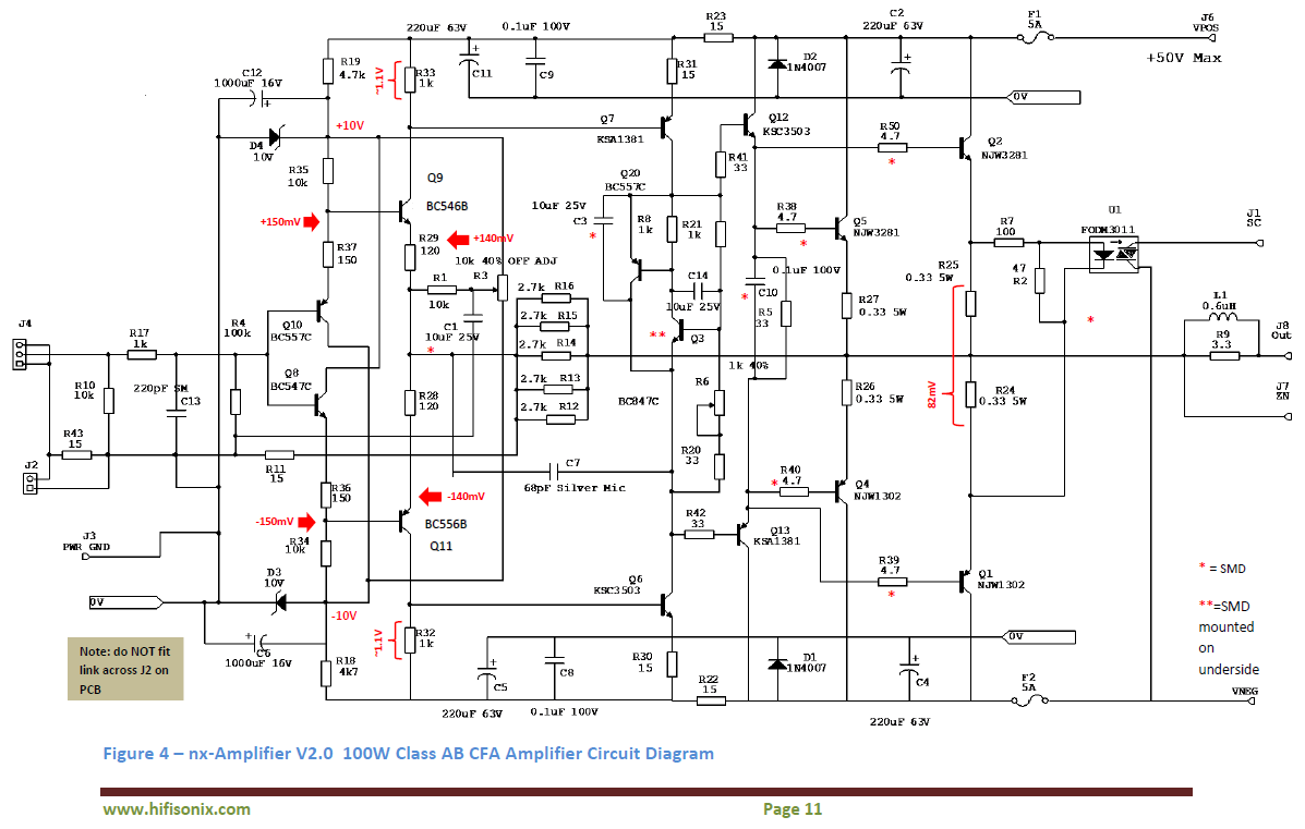

This has been an ongoing issue for years. In the sx-Amp You had to match them and the guys were already struggling in 2013 with this issue.
On the nx- amp and later designs, I use beta enhancers so the hFE deltas between the complements are less exposed.
I think the biggest issue we will face in the coming years will be the lack of decent complementary VAS devices - high Vce, low Cob, flat hFE vs Ic etc etc.
I don’t see anyway out of this other than to use a cascode since there are plenty of high voltage bipolars around and feed it with a beta enhanced low voltage stage.
Another challenge awaits us . . .
Hi, would you please circle the "beta enhancers" in green, on the attached nx- amp schematic? Thanks very much.

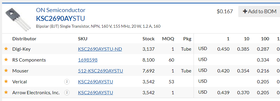

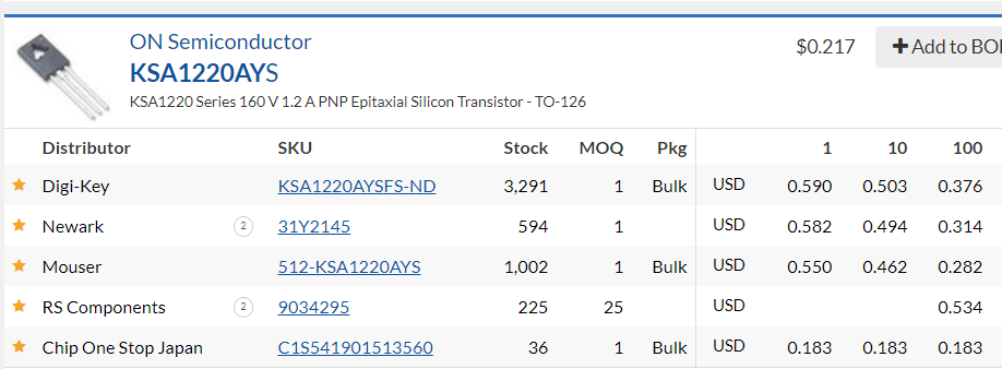

FYI, I just received 300 pieces of KSA1220AYS, which I ordered from Mouser.com in December 2018. Maybe they will start to show availability soon.
Good news: they're in stock & on the shelf, today. Buy a few tubes now when you can get them easily.
