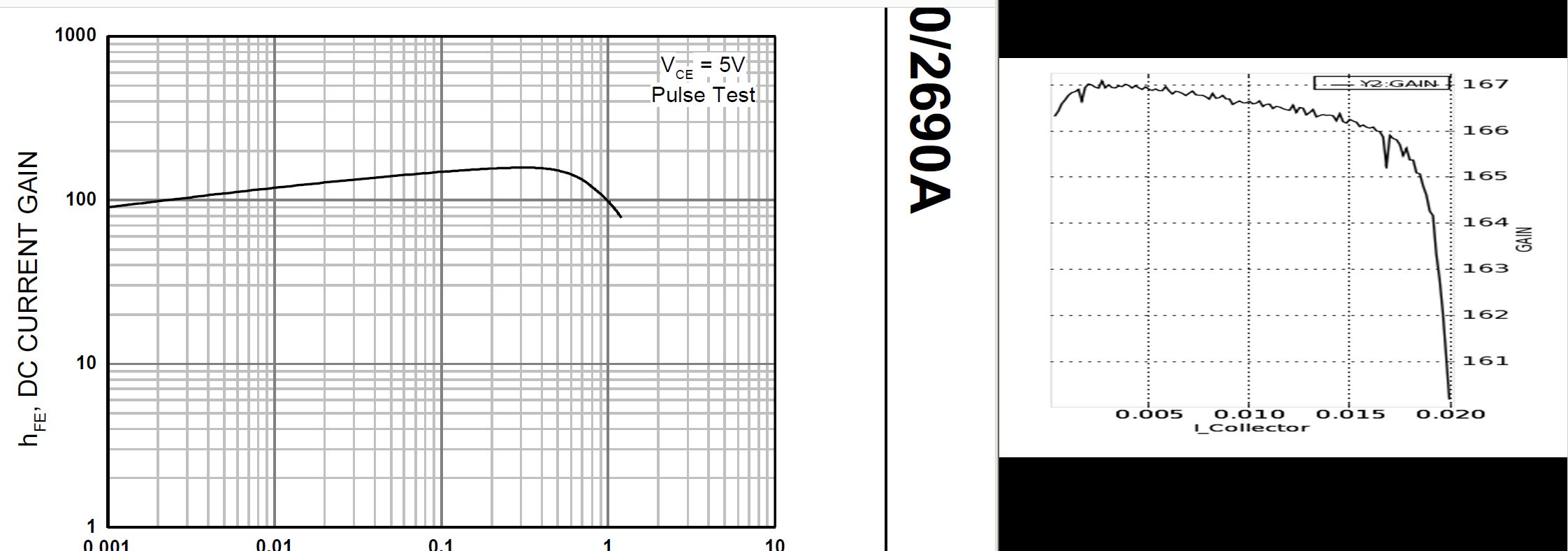

Someone has already used the TTA004B model given by toshiba ?

it's just unitilizable in a simple circuit
HFE 488 for "pspice model" and 2m for "ltspice model"
164 for the 2SA1381 cordel model in the same situation

I used in my preamplifier power supply. LtSpice showed the gain about 210, and it was approx. 230 in real life. The current was 10mA.

in fact in my amp the TTA is good, but in a simple simulation like that i have strange results
Could you try in your ltspice ?

I have an error with U1, hFE for Q1 and Q2 are identical to your simulation.
- KSC2690A and KSA1220A
