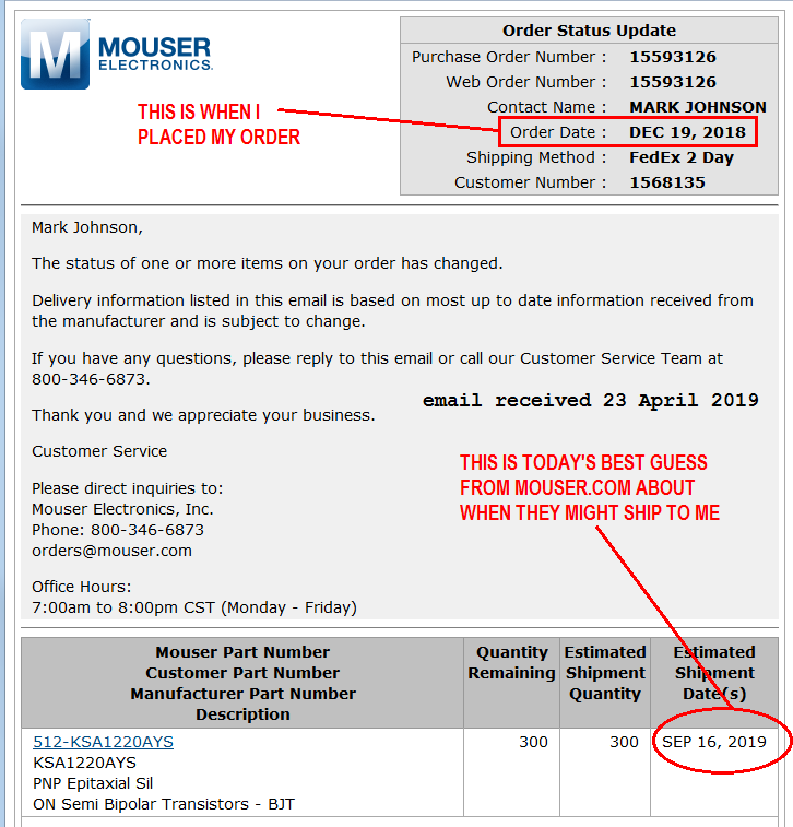

Great scam, buy up all the stock and then your competition is screwed, , including us DIY. Start selling them at inflated costs on eBay 🙂 I remember having purchasing, need to go to brokers to get supply.
Same issue with the MJL's.
Wow Mark,
300, life time buy? or eBay sales 🙂 I usually order min 12, for repairs, new designs. I am running out of A1381, stocking up on c3503 for sure.
Not a fan of TTA(C)004B? They ran fine in my simulation with the Toshiba models, but are not A1381 grade for VAS. I'll order up some TTA(C)004B to use as pre-drivers for testing. Another one that goes in and out of stock. The more we order the better chance of them keeping them alive.
Wow Mark,
Probably there was a sizeable price reduction beyond qty=250, I don't remember exactly.

This device looks like a damn good substitute for KSA1220A and there are thousands of them on the shelf at DigiKey and Mouser.
HOWEVER you will need to learn how to solder surface mount devices with a big wide power tab, to use it. You may have to lay out your own PCBs too,
Choice 1: "I'd rather sit, do nothing, and have no parts, than learn how to solder SMD."
Choice 2: "I'd rather learn how to solder SMD and have parts tomorrow".

This attitude I do not understand. Begrudging Mark the right to buy what he wants to buy?
I bought 500 pcs of KSA1381E in 2013 as a lifetime supply. It was probably $100 at the time. Feel free to hate me for buying what I want. Building on Mark's point, a good amplifier chassis is at least $200 and the large ones are more like $400+. it makes sense to me to stock up on the parts I like. I recently bought 200 pcs each of Toshiba 2SA970BL and 2SC2240BL in the original Japan sealed static bags. Spent last weekend binge curve tracing to find matched pairs at the voltage and bias current that I want to use. Curve tracing a couple hundred parts gives me a much better idea of how the devices behave than measuring just a few parts.
