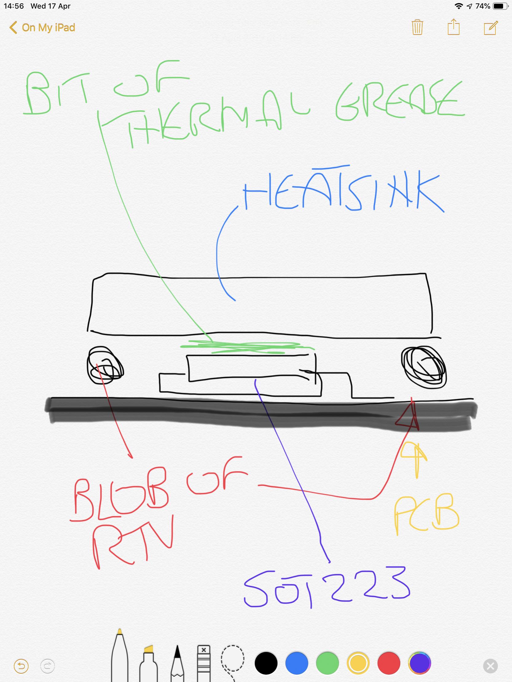

The SOT223 are very easy to use and to heatsink. I actually prefer them over TO126. I am pretty good at placing SMD 0805 and larger and SOT23 but not as neat as Syn08 who’ solder jobs on SMD look as good as a machine job.
You need a fine tipped soldering iron and a few pairs of tweezers.

With smt, it really comes down to practice. I can not see myself using sot-223 as to-126 replacements, you need copper area to cool a sot-223, so the pcb area needed for a HS can be wasted, so the apparent gain with sot-223 is erased with copper area for cooling, its all about trade offs.

You don’t use additional copper. I used small heatsinks 20mm x 15mm that I held in place with a spur of silicone RTV and s bit of thermal grease.

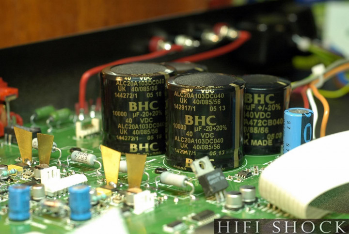

Naim SOT-223 heatsinking 🙂
