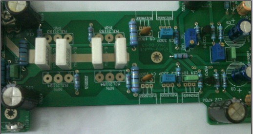

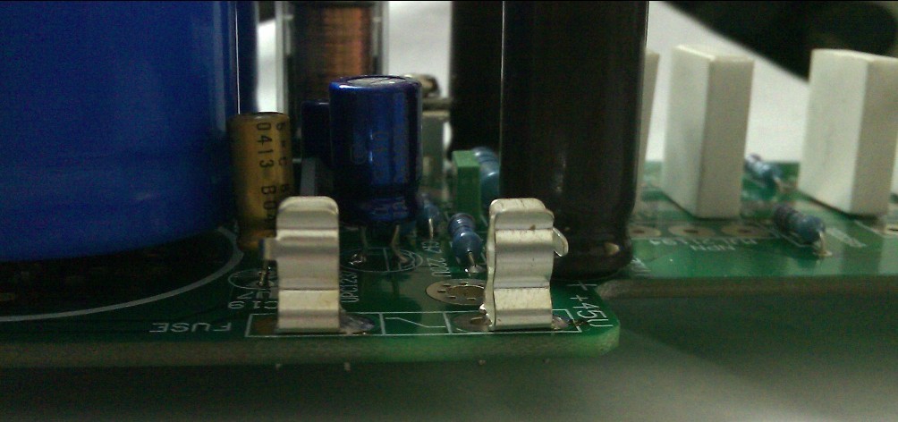

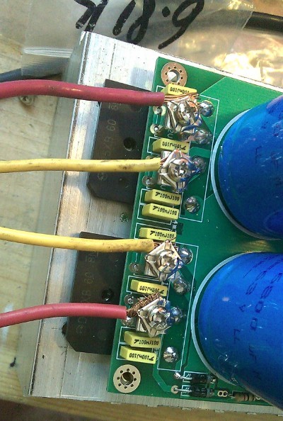

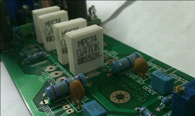

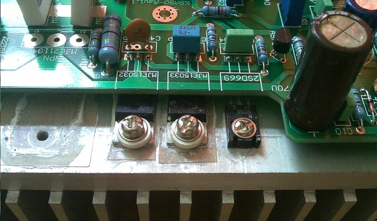

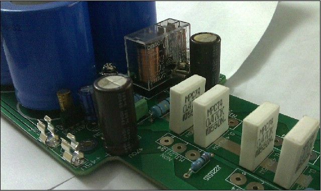

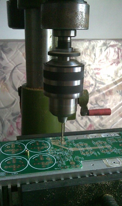

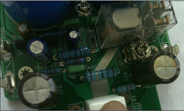

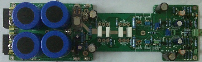

The latest process.

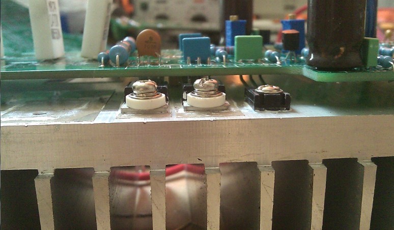

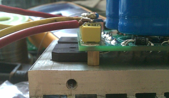

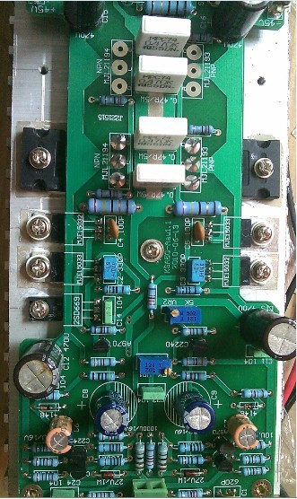

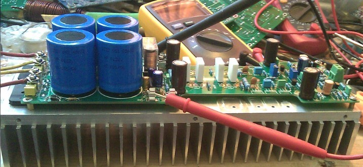

very nicely laid out , can't wait to see the fet's populated.

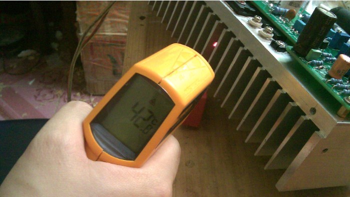

what size heatsink are you going to use? what c/w rating? are you going to force cool with fan?

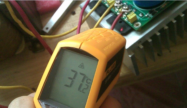

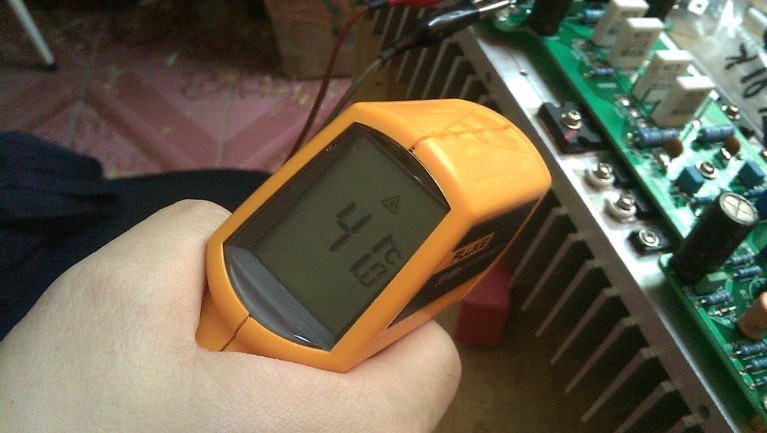

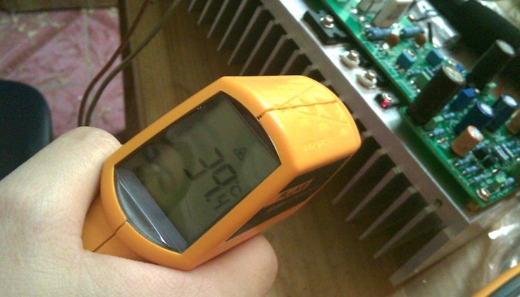

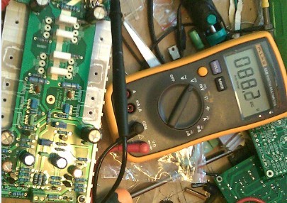

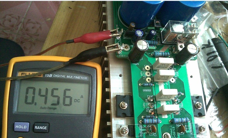

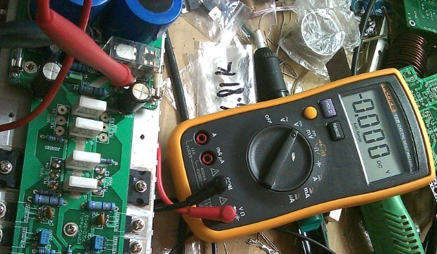

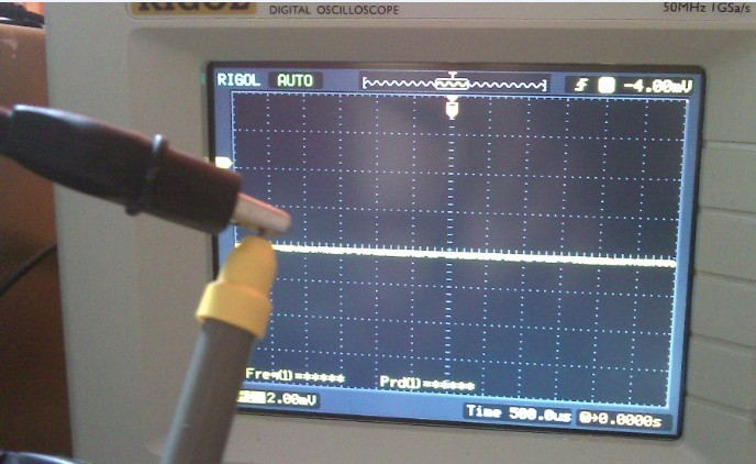

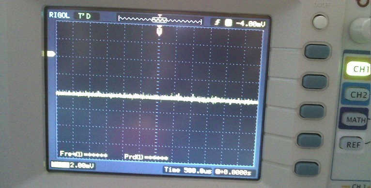

Today's test results.
The results are satisfactory.
Process is as follows:
1)Voltage is: DC80V,+-44V
2)Midpoint voltage:0V
3)Because of heat sink is not big enough, a pair of tube current:450mA
4)Noise floor is perfect, look at the oscilloscope.
Hi!
Thank you!
Will not use fan cooling, due to too much noise.
i don't understand?
Is your bias per device 450mA ?
/sorry i see now. 450mA per voltage rail , but you have one device per rail so it is slightly less if you don't take other losses into account.
i don't understand?

very nice PCB 😱 for free WOOW
