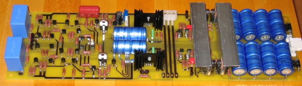

For 50W class A for 8 ohm load using 2 pairs you will need 883ma PER device.
That calculates to 1.77A per voltage rail idling.
for 0.47ohm resistor like on this pc board that calculates to 415mV voltage drop over resistor.
your heatsink will have to be around 0.2 C/W per channel. BIG!!!
(hope i did those calculations correct?)

Strive to perfect KSA50,Now the PCB is not the final product, the next version of the best,Strive....

I bought Pinkmouse KSA50 PCB MKII
with a view debate on a forum between
- mpsa42/92 with c2240/a970
- must use mje 15032/33 cause c2238/a968 (out of stock)
- mj3281/1302 with mj21193/94
but the finish result between commercial & clone, ( still ) winning
by the commercial after some listening test by some diy 😱
like my friend said to me lets build this clone once more
with pcb free, it is nice & interesting
this is some picture i take from reverse enginering kma 160
looks like the same rail as gxcnabin use for his PCB
http://www.diyaudio.com/forums/solid-state/42357-reverse-engineering-krell-kma-160-a-18.html
the different is the place for big transistor here
maybe result from Computer PCB program was similar

Personally, I think, PCB traces should try not to 90 degrees as well!
