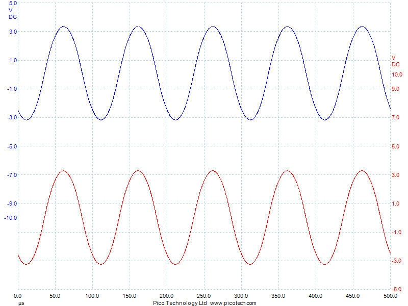

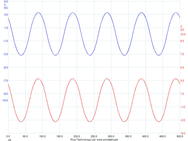

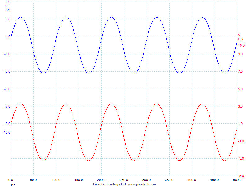

I got these measurements done a little early:
+/- 40VDC on rails of Krill output stage
Output 23 VRMS at into 8 ohm load which is just a few volts below the onset of clipping
In the next 3 posts, the signal at the input to the Krill o/p stage is in the lower trace. The upper trace was measured at (1) base of driver Q13; (2) emitter of driver Q13; and (3) emitter of output Q14. Transistor designations are from the schematic in post 1460.

scott wurcer said:The currents in the output transistors would suffice. Please adjust the bias to 25mA first.
These voltage waveforms will not show switching of the output devices anyway. What you need is a differential CRO probe and a small value resistor in the collector lead of one of the output devices to view its actual current.

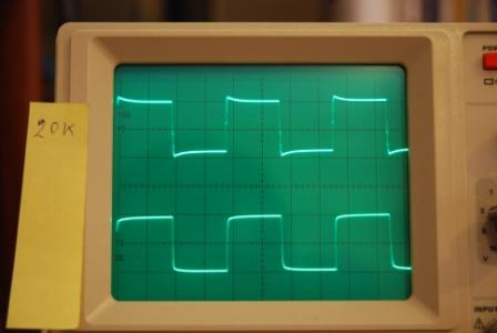

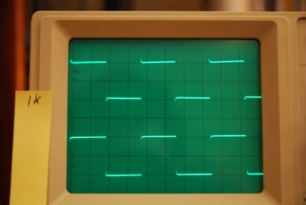

Some osciloscope images.
As you can see my frequency generator is of low quality.
The upper signal is the input. The bottom signal is from output.
Load was a 4,7 ohms resistor.
About 10W power output.
The frequency is the one written on the yellow paper attached to scope.
